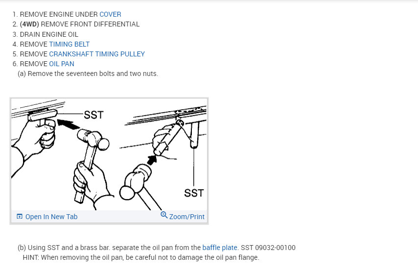

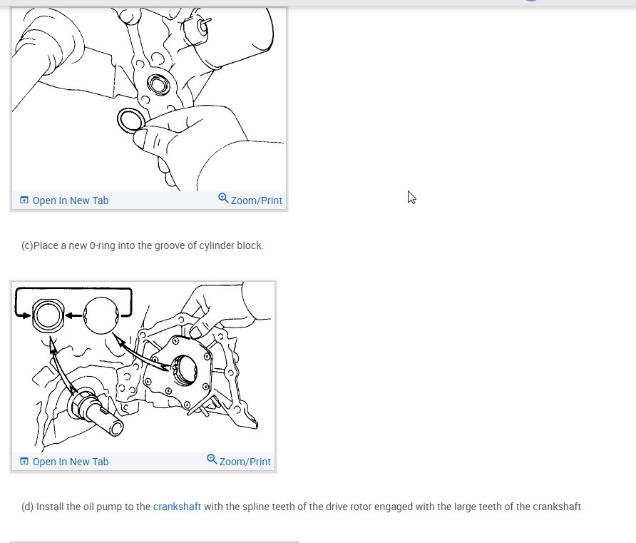

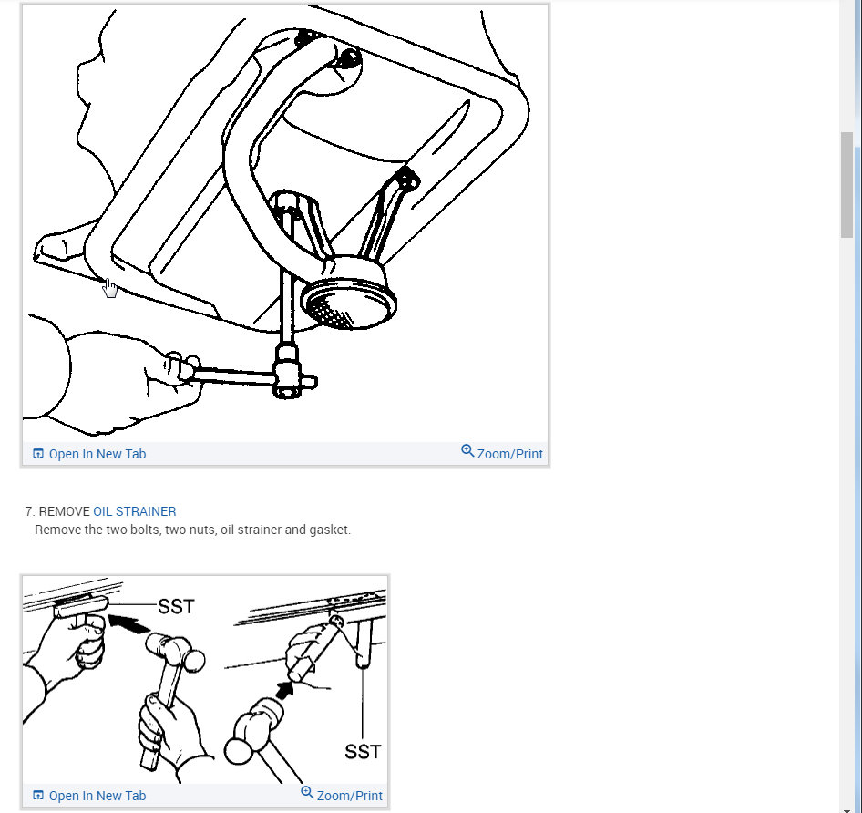

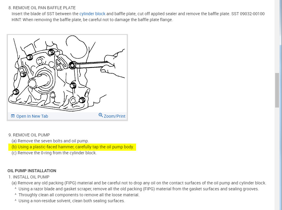

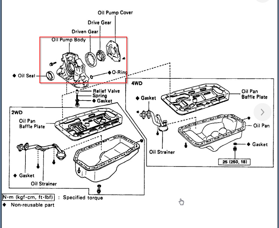

I can't remove the oil pump from crankshaft. It won't come off.
Saturday, November 23rd, 2019 AT 11:06 AM
Okay. Which portion are you saying is stuck to the crank? Can you get the cover off or is it one of the drive gears?

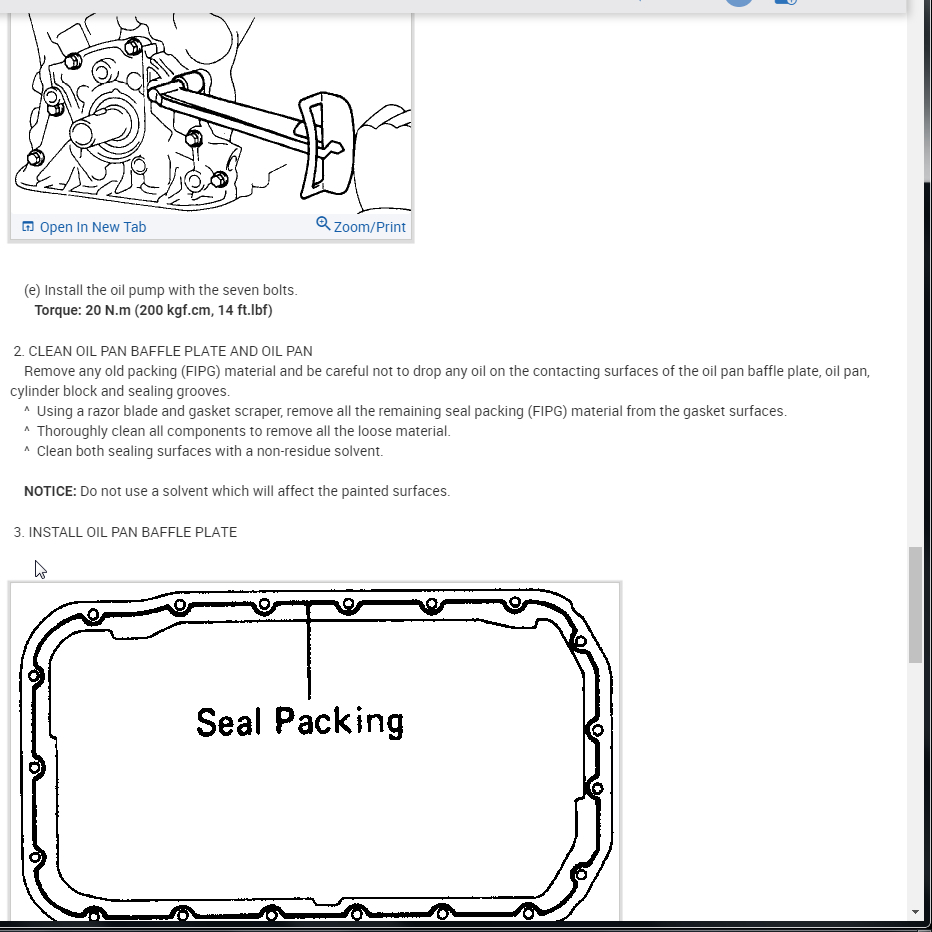

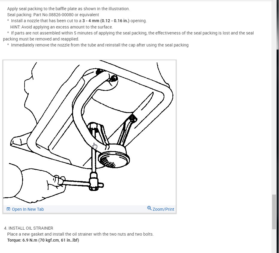

I included the process on how to replace this in case you see something that you may have missed.
Let me know what portion is stuck and we can go from there. Maybe get some pictures. Thanks
