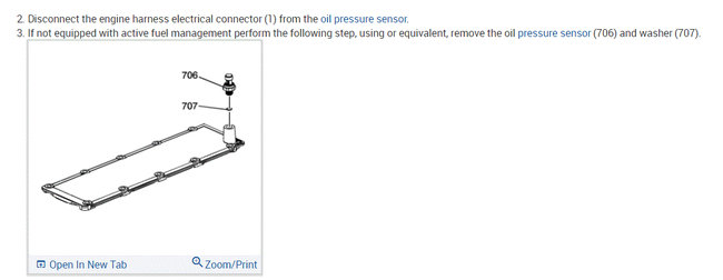

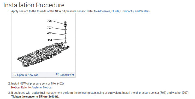

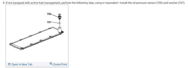

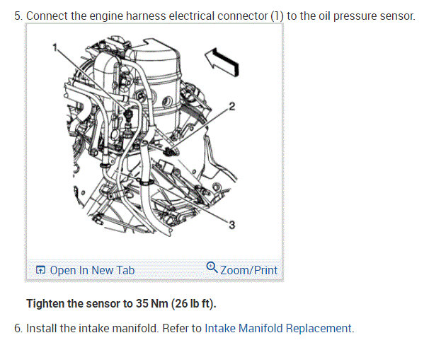

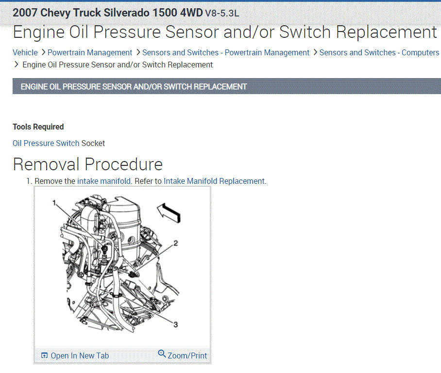

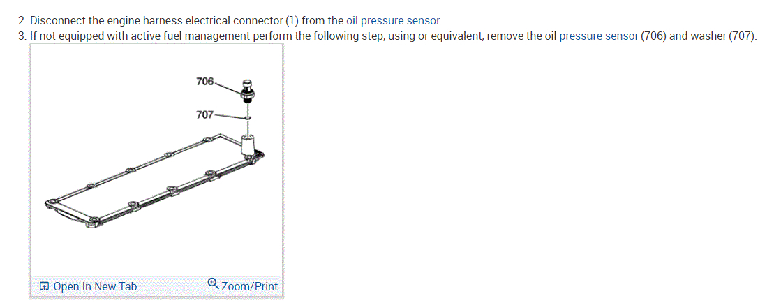

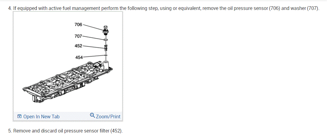

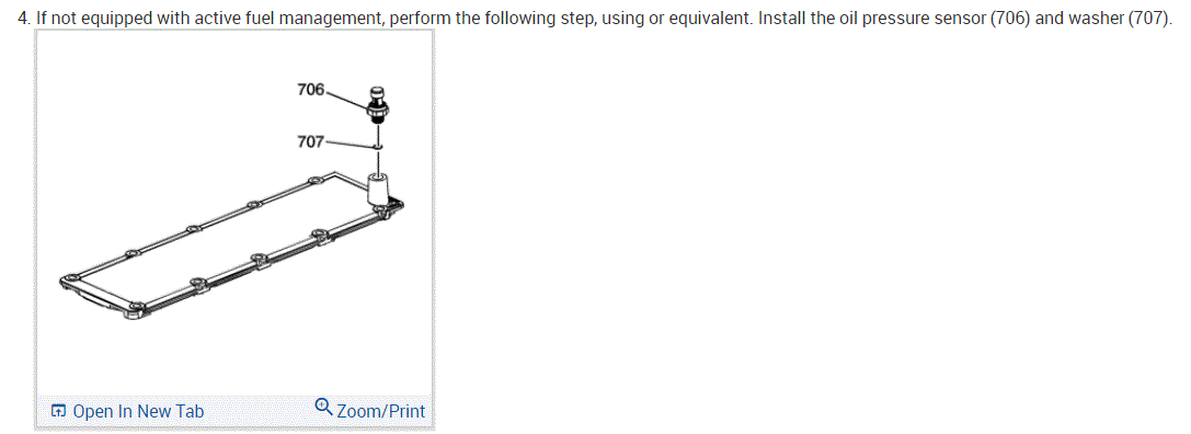

I'm not sure which engine you have, so I selected a 5.3L which is the most common. The problem with this is the sensor is located under the intake manifold.
I attached directions below for replacement. However, we need to determine first if I have the correct engine, if there is any knocking or ticking when there is no pressure, and if there are any wiring issues.

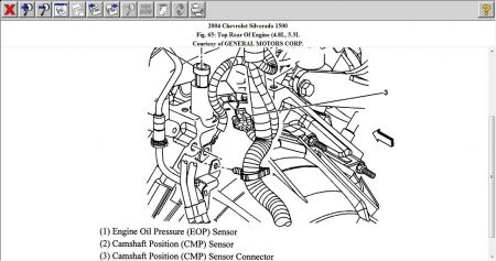

Check and test the oil pressure sensor located at top rear of engine-see below
https://www.2carpros.com/forum/automotive_pictures/12900_oil_pressure_sensor_6.jpg

I would replace the oil pressure sensor, t is on the rear of the engine facing up. Here is a picture. If it is small, look for #1 in the picture.
https://www.2carpros.com/forum/automotive_pictures/249084_5_24.jpg
Let me know if this helps. NOTE: This is for the 4.8, 5.3, and 6.0L. If you have something different, let me know.
