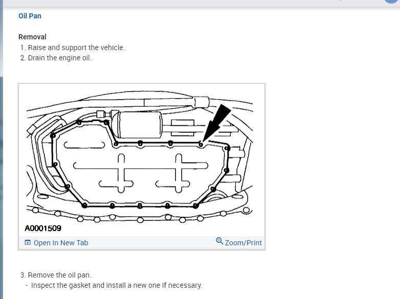

I wanted to know how to remove the oil pan.
Sunday, June 28th, 2020 AT 7:02 AM
MECHANIC
18,907 POSTS

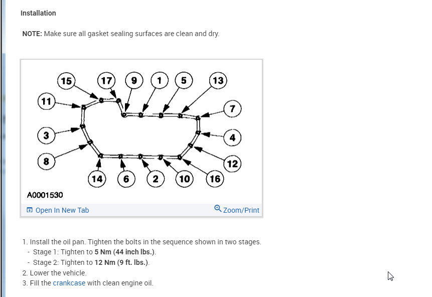

I attached the process from the manual. I have not done an oil pan on this engine so I am not sure if it is as easy as it states but it looks pretty straight forward.
Let us know if you have questions. Thanks
