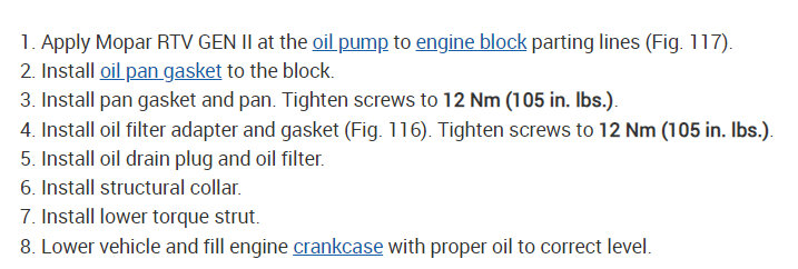

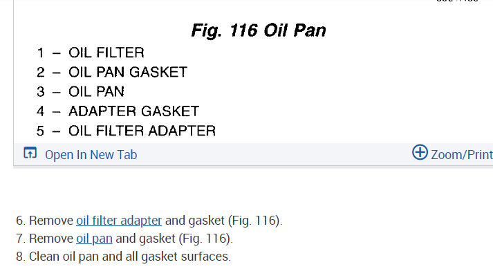

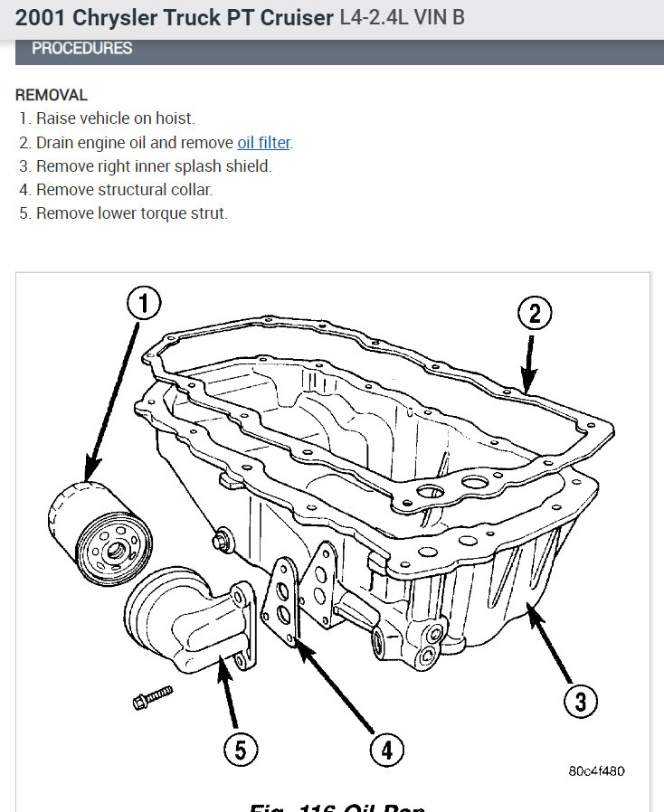

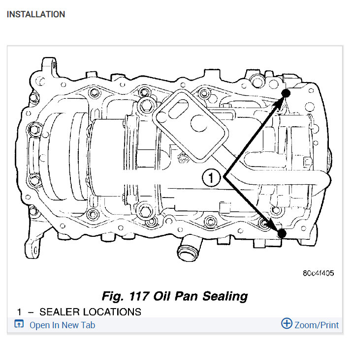

The oil pan gasket is pretty easy to change on this car here are the instructions below and the part number for the gasket.

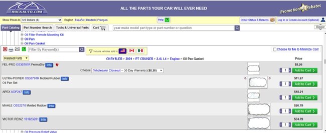

42 - Oil Pan Gasket - #4777994AA
Check out the images (below). Let us know if you need anything else.
