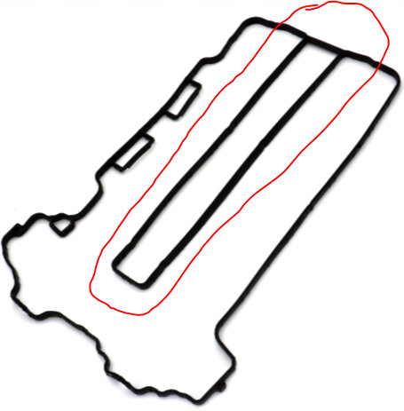

Was doing a service this morning and noticed oil on the right-hand side spark plug thread, are there any gaskets that I can replace to prevent oil getting into the treads? I have looked on-line but can't find anything relating to changing the valve gaskets on my car, I have only found rocket gasket replacement, which I have but don't want to fit if there are other gaskets that need replacing.

This vehicle isn't offered in the US, so I don't have the specifics. However, I looked up a picture to see how the gasket is made.
From what I can tell, there is a gasket that is part of the valve cover that seals off where the spark plugs would be located. See pic below. I circled what I believe would be the portion of the gasket that seals oil from reaching the plugs.
Take a look and let me know your thoughts.
See pic below.

I also looked online and could only find the same information that you have given me, so it looks probable that this is the gasket that I need to replace, I already have a new one so thanks to your answer I can confidently go ahead and fit it.

I also looked online and could only find the same information that you have provided me, so it is most likely the cover gasket. I already have a new one, so thanks to your answer I can confidently go ahead and fit it.

Just wanted to let you know that my car is running okay now, the gasket was damaged. Thanks again for your help.
