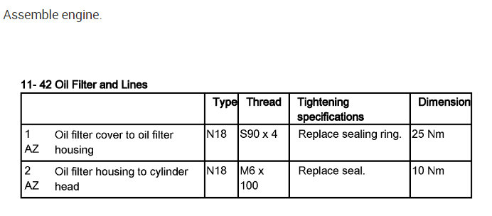

Can you find out for me what the torque spec is? I see 10 nm in some places and 18 maybe. Can't remember if its nm or ft lbs.

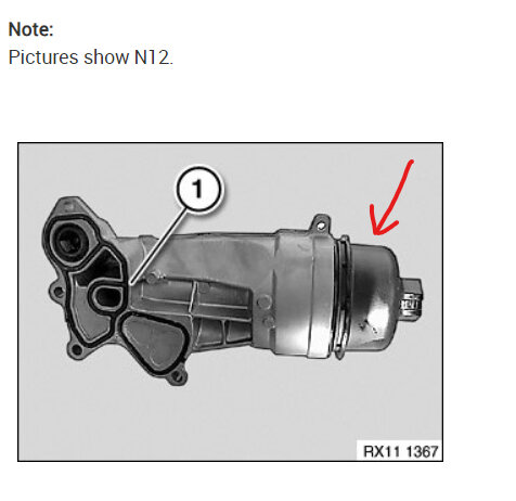

It is 25 nm for the oil filter cover, check out the images (below). Let us know if you need anything else.

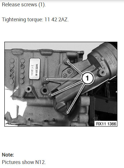

I see. It's 10nm for the bolts. No, I am not worried about the oil filter cover itself.

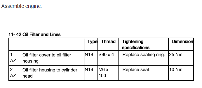

The housing is 10 nm, here is another image to help you. Check out the images (below). Let us know if you need anything else.

Thats it. Thanks
