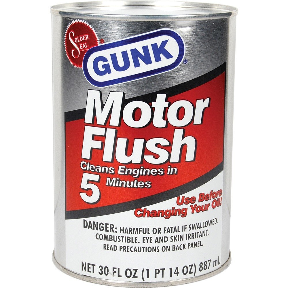

If you do believe the oil consumption is high though, perhaps you could try running some Gunk motor flush through the crankcase and free up any sticking piston oil control rings. Stuck oil control rings because of gunk/carbon buildup would cause excessive blow-by and too much oil consumption as oil passes by sticking oil control rings.
What you do is put in a pint of this motor flush, before an oil change, when the engine is cold. Start the engine, allow it to idle for five to ten minutes, drain out all the oil and cleaner, replace the filter and fill with new oil.
This is the stuff:

And would it also help to use a thicker oil like 10 w 40 from Shell Helix or Castrol?

Try the flush first though. If it still consumes too much oil then I do not see why stepping up to 10w40 would hurt, especially in the summer time.
