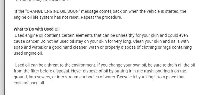

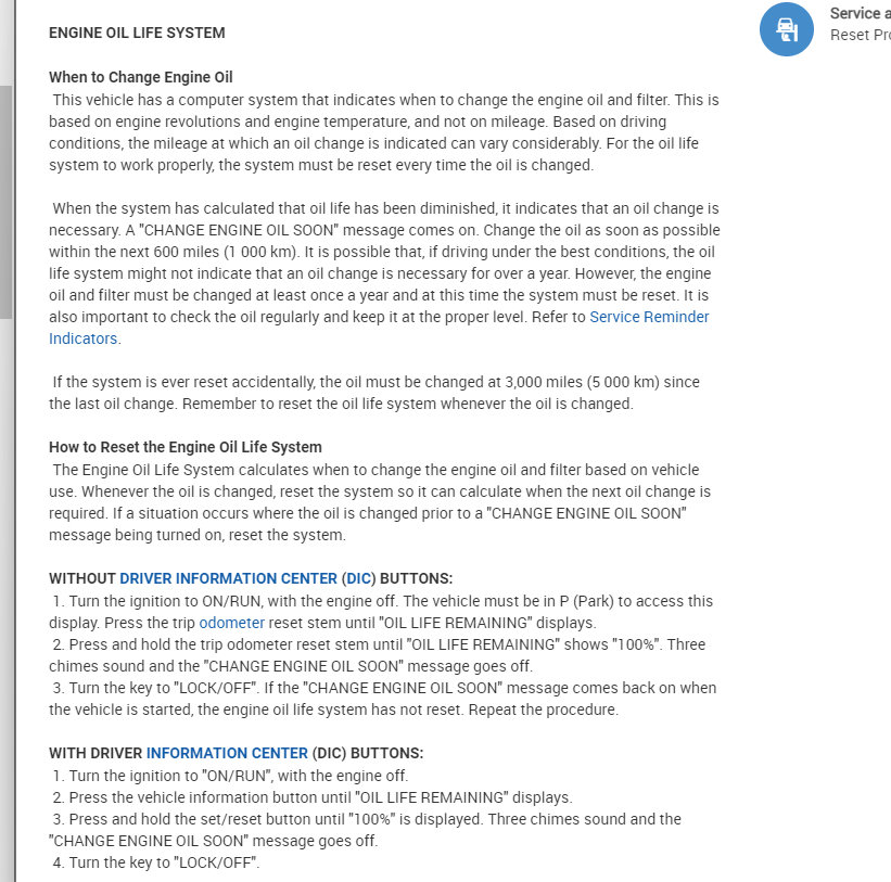

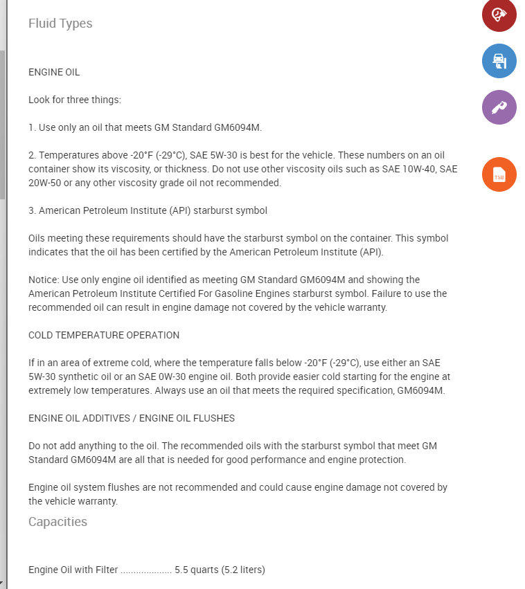

I am trying to get any helpful information I can about doing an oil change on the vehicle listed above, LT.
Monday, April 25th, 2022 AT 8:15 AM
MECHANIC
18,907 POSTS
Not a problem.
Here are a couple guides that will help with this and a video of doing this on a similar vehicle:
https://www.2carpros.com/articles/how-to-change-engine-oil-and-filter
https://www.youtube.com/watch?v=HgUKCfz33BA
Below you will also find the process on how to reset the oil change indicator and the fluid specification for this engine.
Please run through this info and let us know what other questions you have on this.
Thanks
