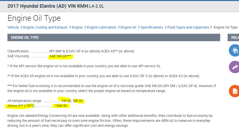

Trouble deciding which brand best suits my car listed above SE model, in regard to adequate lubrication protection and overall longevity. I recently purchased Amsoil signature series 5w20. Should not use 5w30 correctly? Motul I heard was another great brand but can only find good oils suitable for my car in the 5w30 viscosity. Thanks
Friday, September 15th, 2023 AT 3:01 PM
20 Replies
  • 110,192 POSTS
The preferred oil weight is 5w20. However, 5w30 is fine and if you are in a warm climate where the temperature doesn't go below 0 degrees F, you can even use 10w30.
I attached oil type information below specific to this vehicle. Take a look through it and let me know if you have questions.
Also, if you purchased Amsoil, that certainly is one of the best. I would recommend if you can afford it, use it. LOL
Take care and let me know if this helps.
See pic below.
Friday, September 15th, 2023 AT 10:03 PM

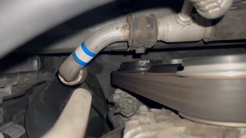

Can you please tell me what this cold start only noise is? It’s very brief, you may need to rewind it from time to time. It sounds like some kind of a belt friction noise.
Wednesday, September 20th, 2023 AT 12:50 PM
JUSTSEBASS
  • 21 POSTS

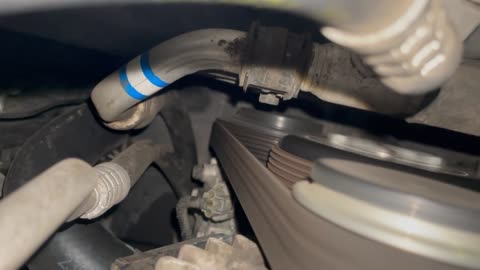

Here is another shorter video dialing in on the exact moment the noise is heard. It sounds like a belt or something. It seems to be getting worse maybe I’ll have a better video with a more intense noise.
Wednesday, September 20th, 2023 AT 12:52 PM
  • 110,192 POSTS
You are very welcome regarding the oil. Since this will be synthetic oil and Amsoil, I feel comfortable saying every 5,000 miles.
As far as the noise, make sure the AC and Defroster are off and see if the sound is gone. It sounds like the A/C compressor engaging.
Thursday, September 21st, 2023 AT 6:28 PM

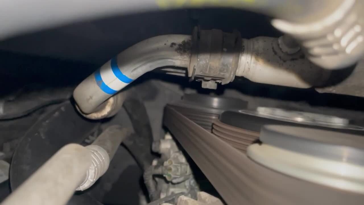

The sound only happens briefly on cold starts after the car has been sitting about 10-12 hours and the AC/defroster are always off before I turn off my car, so they are already off on start up the next time around.
Thursday, September 21st, 2023 AT 9:10 PM
JUSTSEBASS
  • 21 POSTS

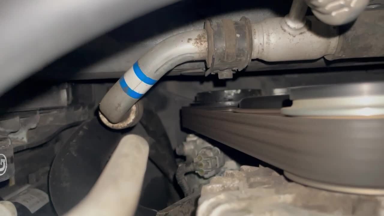

This is the A/C clutch spinning (A/C is on).
Thursday, September 21st, 2023 AT 9:20 PM
JUSTSEBASS
  • 21 POSTS
This is the A/C clutch when it’s not spinning (A/C is off).
  • 110,192 POSTS
I believe the sound is when the compressor first engages and places a heavy load on the system (belt).
Have a helper start the engine for you and see if that is where the noise comes from.
Friday, September 22nd, 2023 AT 3:23 PM

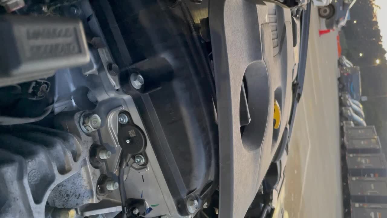

Thank you I will attempt it tonight after letting the car sit the whole day while I’m at work. I plan on bringing it to the dealership on Monday because after watching several YouTube videos of similar sounds Others were saying it could be a VVT rattle or a tensioner problem? No way to know for sure and I know it’s hard to diagnose online thanks for all of the help you have provided!
