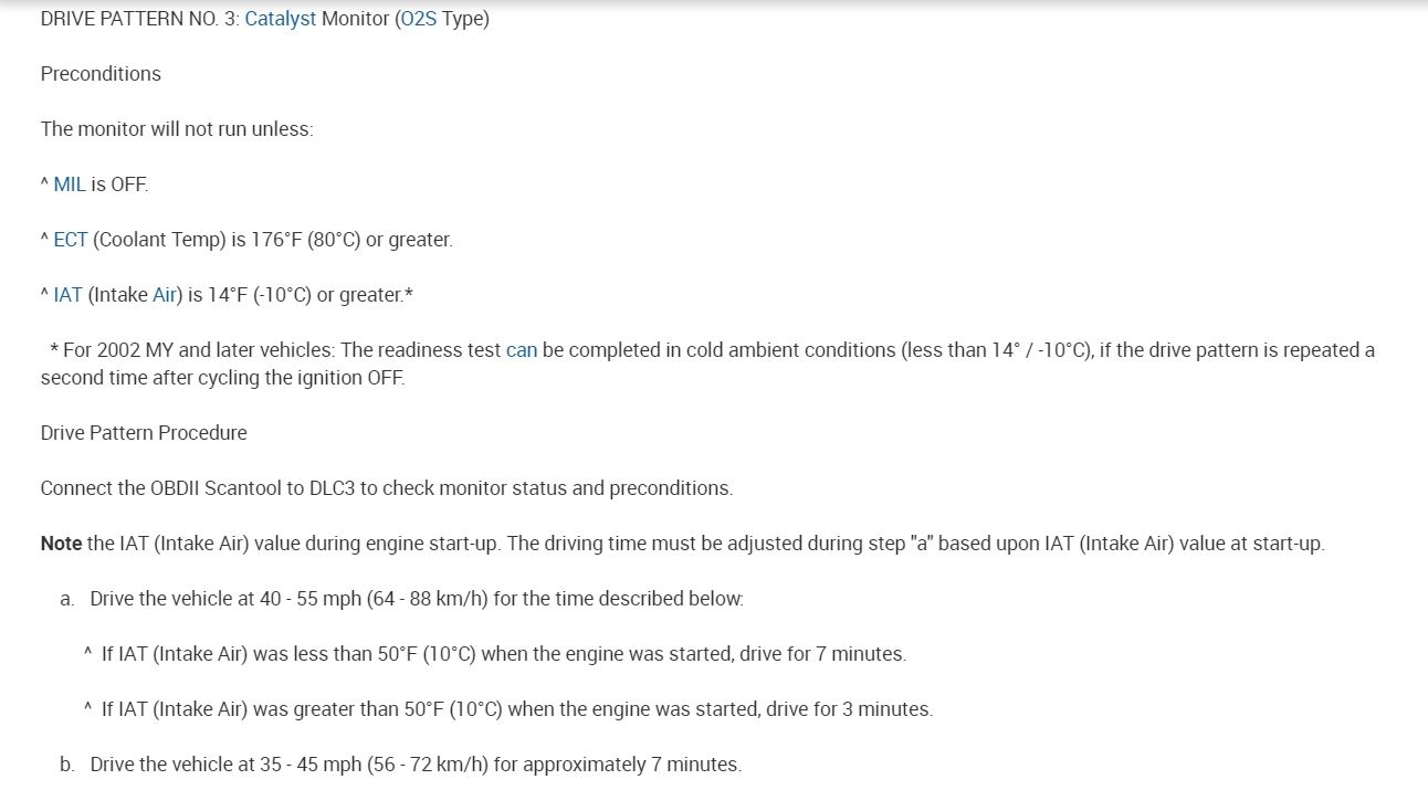

I had my catalytic converter replaced, because a year ago earlier replacement (OEM unit stolen) was discovered to be not the right converter (the garage installed the converter for a 2.7 liter motor). The truck passes the smog test (California), passes the visual test, but doesn't pass the functional test - obd2 port doesn't "see" the cat.
Immediately after installation of the new cat, check engine light came on.
Installer cleared code, didn't read it.
Have driven 200+ miles since, check engine light has not come on, but still fails because OBD2 port doesn't see the new converter. Emissions test is fine.

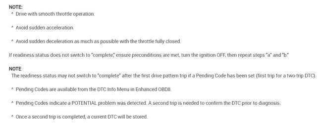

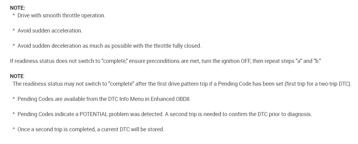

Good morning,
This has nothing to do with the port. The system has to do an internal test to check the cat converter. It is called a drive cycle. It is a very specific way to drive the vehicle to set the monitor to green or clear.
As far as the code is concerned, I will need that if it returns. That is important.
Normal driving will never set the monitor no matter how many miles you drive. You must follow the procedure I attached.
Keep me updated with the results.

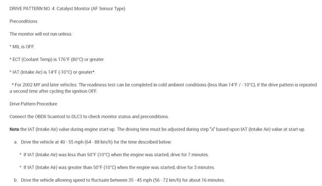

How do I determine if the catalyst monitor is an O2S type or an AF sensor type? (Is it part of the T100, perhaps of the computer, not of the scan tool?)

You have the air/fuel sensor for the upstream O2 sensor.
The MIL is the check engine light. It stands for malfunction indicator lamp.

Roy, thanks for everything. Did both drive cycles, a bit difficult to go so slowly on the freeway, the only road free enough to do the 16-minute oscillation cycle, but cycles seem to have worked. On two scanners, cat converter is recognized. Will have smog test on Friday, but smog test guy thinks I'll pass. (One of the scanners that looked good was his).
