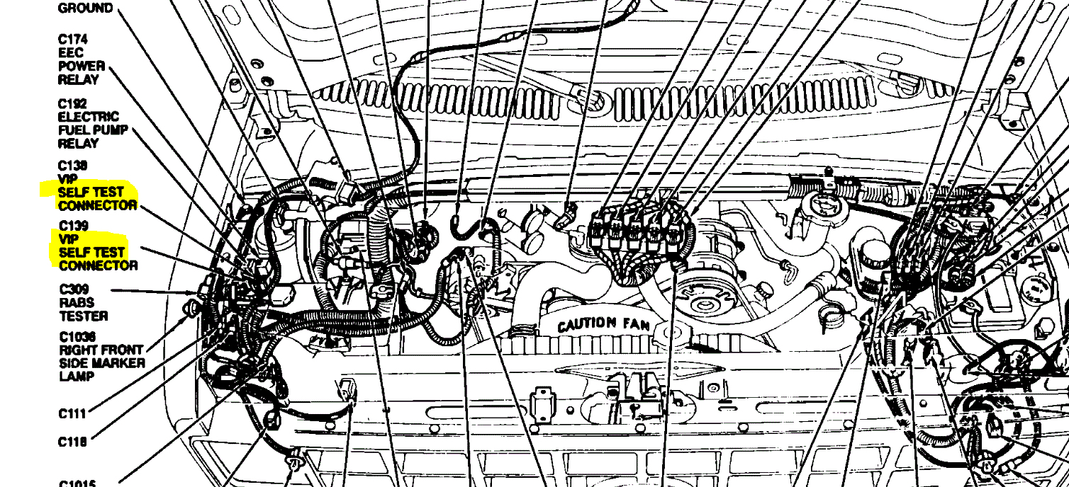

Need to know where the OBD1 reader is. It's in 1991 Ford club wagon XLT.
Friday, February 21st, 2020 AT 12:07 PM
MECHANIC
110,192 POSTS
I'm showing them to be on the right inner fender. Take a look at picture 1.
Here is a link showing how to perform the test:
https://www.2carpros.com/articles/ford-lincoln-mercury-obd1-1995-and-earlier-diagnostic-trouble-code-definition-and-retrieval
Let me know if this helps.
