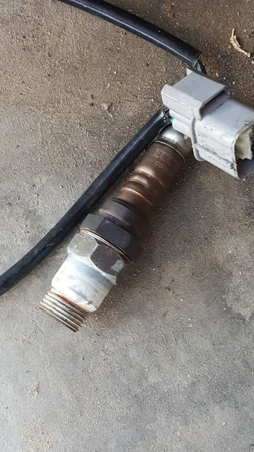

Will an o2 sensor adapter cause any problems?
Friday, October 12th, 2018 AT 3:45 PM
9 Replies
Good evening.
You are trying to fool the PCM for the 420 code?
If you are, it will not work. That is a myth from the internet which does not work in real life.
The simple answer is no, it will not harm anything by using the oil fouler.
Friday, October 12th, 2018 AT 4:36 PM
ATORUM
  • 5 POSTS
I just bought the car and replaced the o2 sensor and it already had an adapter. So I am not sure why it had one in the first place.
Friday, October 12th, 2018 AT 4:58 PM
Someone was trying to do something there. Whatever it was will not work.
Remove the adapter and just install the sensor back into the pipe.
Is the check engine light on?

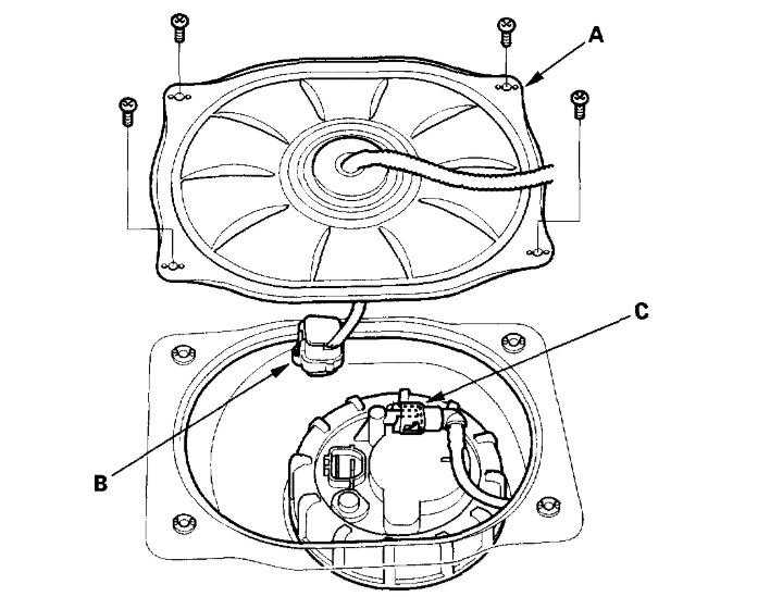

Whenever my gas tank get about 1/3 empty the car jerks a lot and shuts off. Would that be something with the fuel pump?
Friday, October 12th, 2018 AT 5:25 PM
Yes it could. There is a pick up in the tank with a hose. If the hose is cracked, it will suck air instead of fuel when it gets uncovered.
I would remove the fuel pump and inspect for any damage or leak from the pump assembly.
1. Relieve the fuel pressure.
2. Remove the fuel fill cap.
3. Remove the seat cushion.
ImageOpen In New TabZoom/Print
4. Remove the access panel (A) from the floor.
5. Disconnect the fuel pump 5P connector (B).
6. Disconnect the quick-connect fitting (C) from the fuel tank unit.
Friday, October 12th, 2018 AT 5:48 PM
