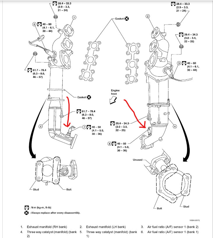

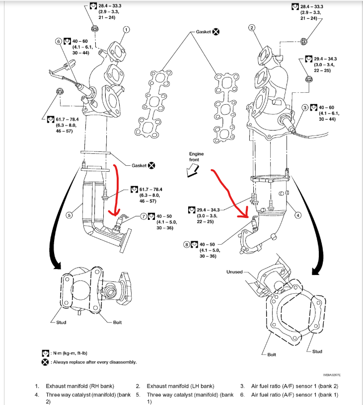

I have a blue downstream o2 sensor part but on the car the connection is green so i just need to know which is the correct o2 sensor for the downstream
Jul 28, 2025 at 5:41 PM
  • CAR REPAIR CONTRIBUTOR
  • 54,433 POSTS
The downstream sensors are behind the catalytic converter, here is the location. Check out the images (below). Let us know if you need anything else.
