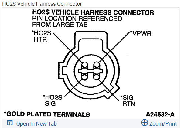

Ok I bought an aftermarket O2 sensor that has 2 white 1 gray and 1 black wire on it and need to know which one goes to which one. Car has fat red fat white with black line then 2 skinny like a weird green with red line and red with weird green line. Little help please?

You need a connector view of the sensor, for most 4-wire universal oxygen sensors with:
2 white wires = heater circuit wires
Black wire = sensor signal wire
Gray wire = sensor ground/reference wire
Fat red = likely O2 heater power
Fat white with black stripe = likely O2 heater ground
Skinny green/red = likely O2 signal or signal return
Skinny red/green = likely O2 signal or signal return
Check out the images (below). Let us know if you need anything else.
