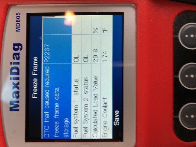

This keeps coming back very quickly after deleting it.

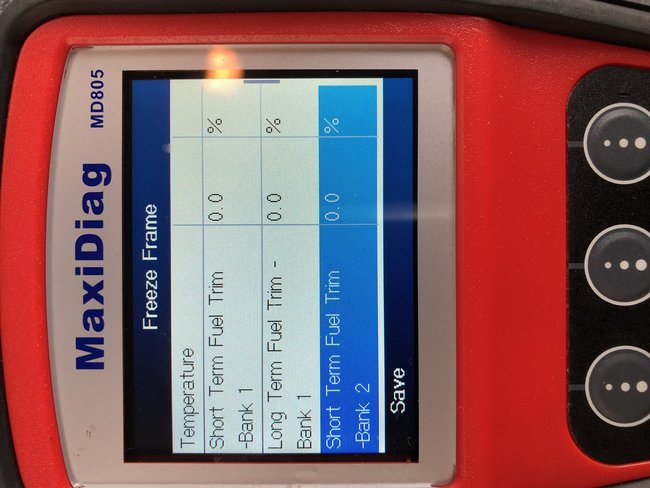

Could you post the freeze frame data for the code please? You say it comes right back, after how long and is it consistent or repeatable? IE you clear the code, start the engine code comes back as soon as it goes closed loop, or code returns as soon as you rev the throttle once the engine is warm? Anything like that. Talking to a couple Honda/Acura folks and one of them mentioned that he saw that code when there was an issue with a crank sensor that was not reading correctly and was causing an ignition coil problem because it would trigger the coil twice. Beyond that is the same problem Doc ran into, no good code information. Even in the service manual for that vehicle there isn't any good guidance.

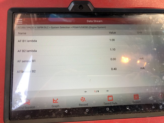

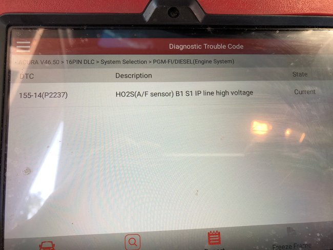

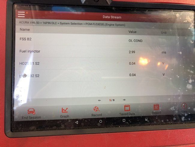

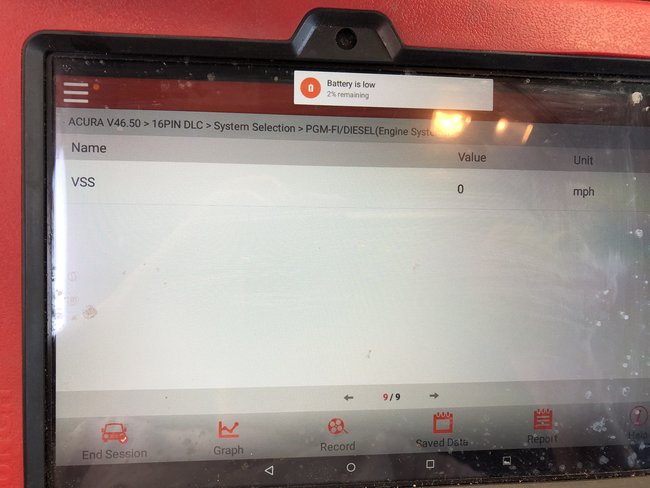

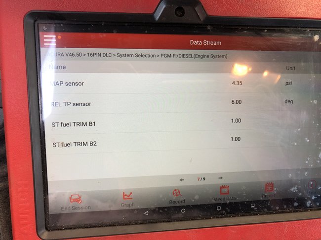

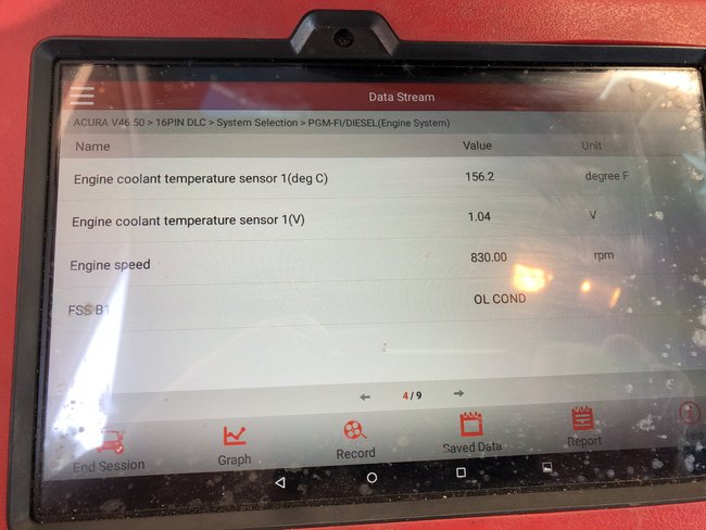

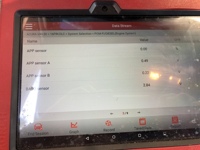

Cleared it. Started the car. Throttle doesn't affect it. Waited 15 seconds and cane back, did it again and again it cane back in 15 seconds. Attached
Tuesday, August 4th, 2020 AT 1:51 PM
NASER NASER
  • 836 POSTS

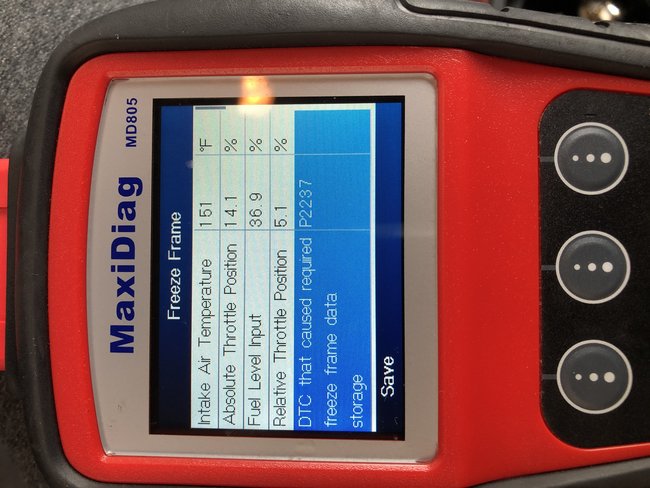

More.

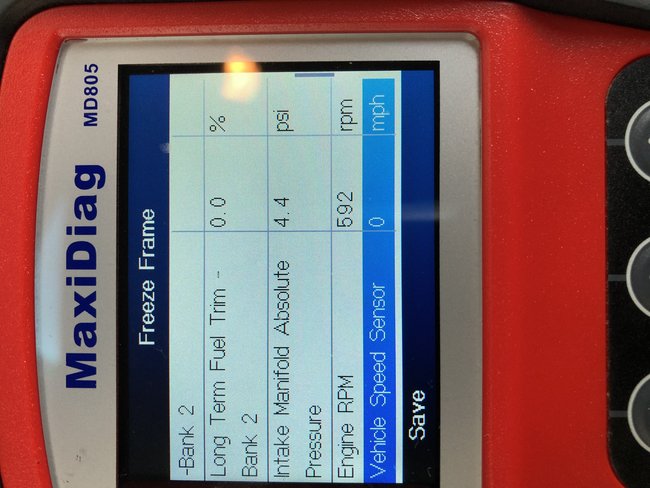

Yes, I have other scanners, just the fault code or freeze frame data?
Tuesday, August 4th, 2020 AT 3:08 PM
NASER NASER
  • 836 POSTS
Attached.
Tuesday, August 4th, 2020 AT 3:28 PM
STEVE W.
  • 15,700 POSTS
Okay, those numbers let me find a bit more. Acura shows the 155-14 code as almost identical to a P0155 code, except it is an issue with the Os sensor being shorted to a higher voltage. I would verify the ground for the sensor as a bad ground could cause the signal to be elevated. If the ground is good then monitor the sensors output to see if it's correct and changing the way it should. My bet is that it is showing a voltage higher than it should and that is setting the code. Check the green wire to the sensor for a problem.

Being an AFR sensor and not a standard O2 sensor they can be a pain. The scan tool should read the lambda, amps and voltage from the sensor. Looking at that second image showing those numbers you can see there is no ma draw on the bank 1 sensor. That makes me think it has either a bad ground or a bad connection. The Lambda of 1.00 also makes me wonder as that isn't something that normally happens unless the mix is perfect. Lambda at perfect stoichiometric is  displayed as lambda 1.0. Numerical values above lambda 1.0 indicate a lean ratio, while  values below lambda 1.0 indicate a rich ratio. If you look at bank 2 it's showing 1.10 or slightly rich. A quick test is to run the engine until a bit, they normally start working at 10-20 seconds of run time, now stomp the gas pedal to create a rich mix and watch that lambda number. It should change to a rich mix and then settle back fast if the sensor is working.
