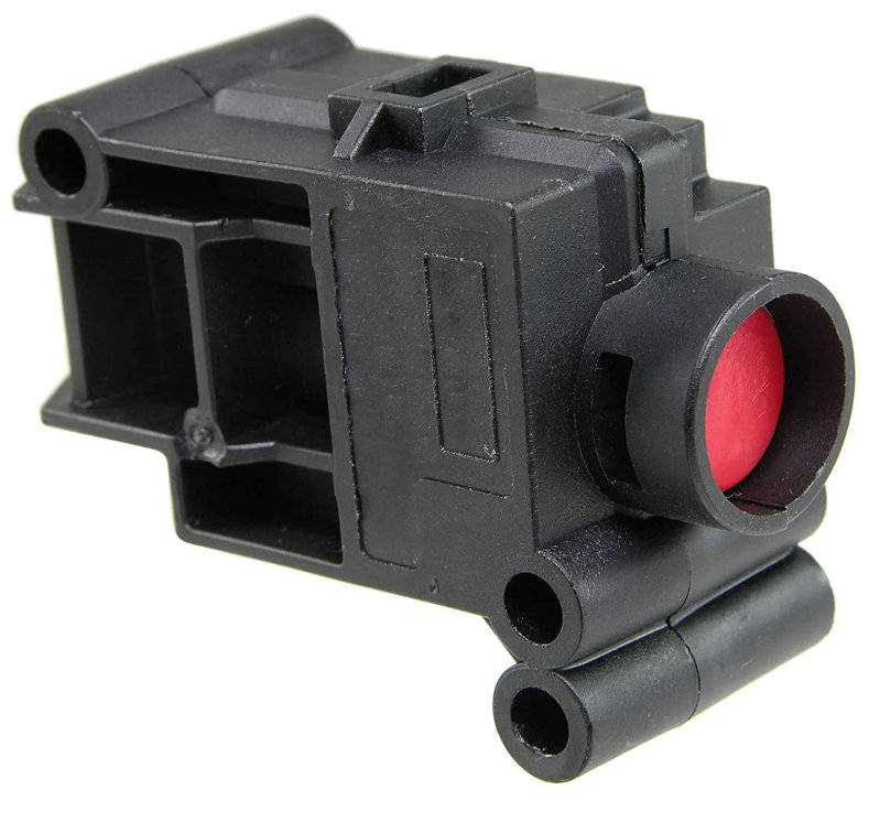

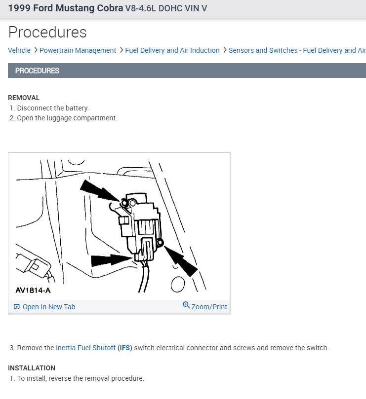

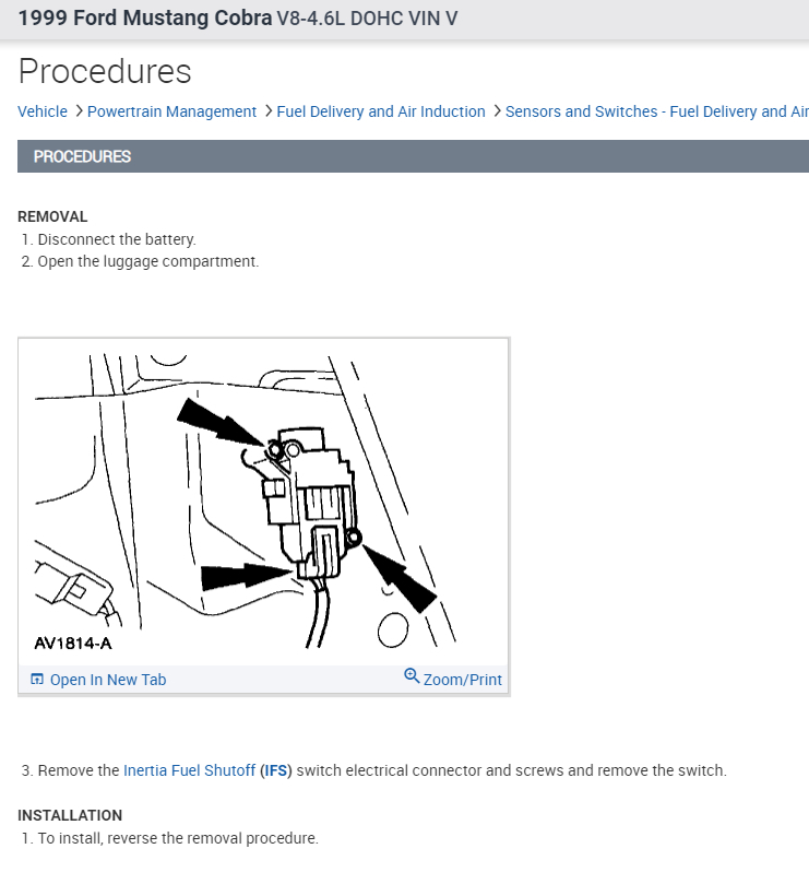

This could have tripped the inertia/fuel shut off switch located in the trunk.
That switch is designed to cut off fuel flow in the event of a collision to prevent fire.
Try resetting the switch.
I have attached diagrams below for your reference.
Let me know of any questions.

Yes, I have reset that as well one of the first things I did too, still no luck.

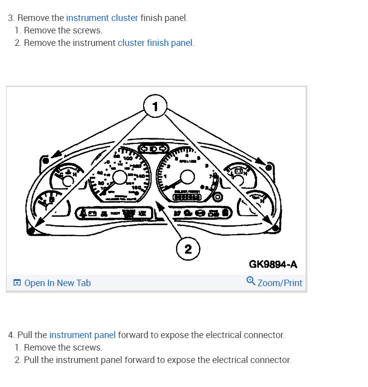

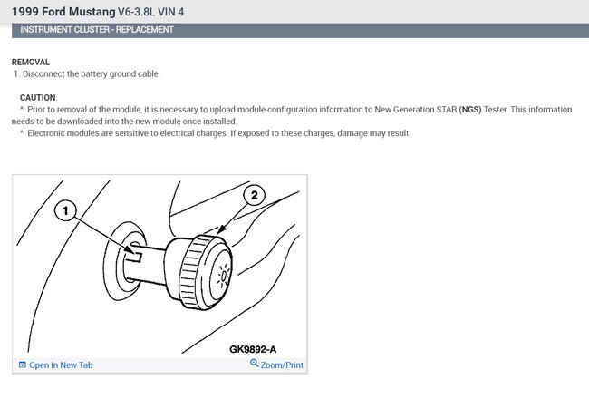

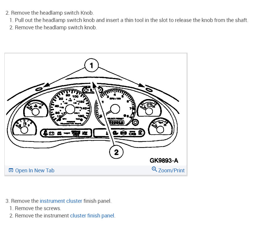

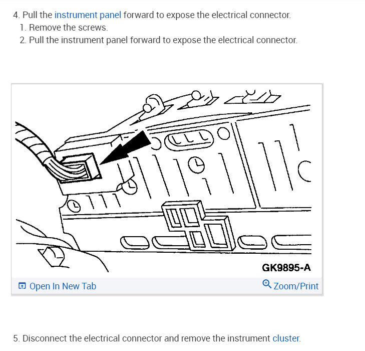

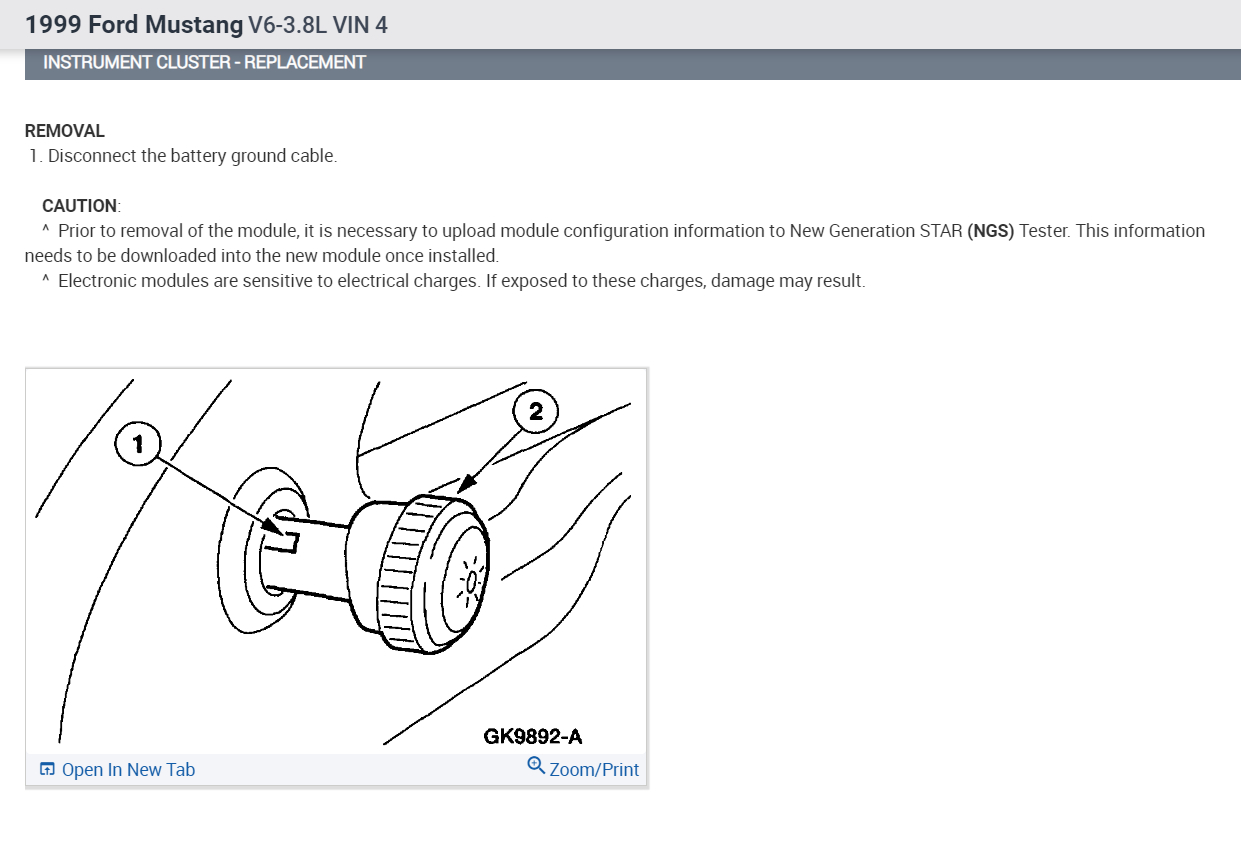

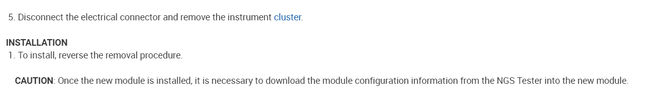

I have seen the clusters go out (short) itself which will cause these issues. To be sure though a CAN scan should bring something up. You can get a CAN scanner from Amazon for about $30.00.
https://youtu.be/u-4syLc-ifQ
Here is a scanner link:
https://amzn.to/3o41KcZ
Here is how you can change the cluster out. Check out the diagrams (below). Let us know what happens and please upload pictures or videos of the problem.
