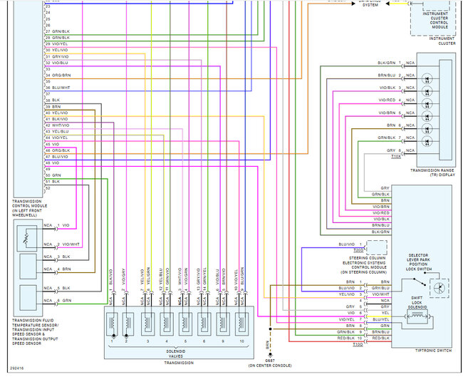

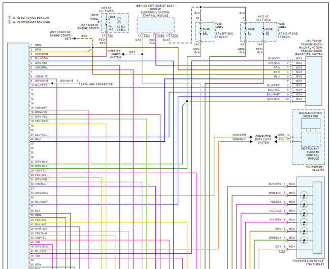

Shift selector locked in park rats chewed wires, replaced top plug on transmission and various other wires, is there another plug in on the transmission?
Oct 27, 2024 at 11:19 AM
  • 54,520 POSTS
Yep, rats are rough on cars :/ There is only one wiring connector on the transmission, I would check the fuses (4) and grounds to make sure they are all working, here is a guide to help and and I have included the TCM wiring daigrams so you can see how the system works and which fuses to check.
Check out the images (below). Let us know what you find.
