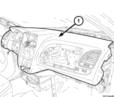

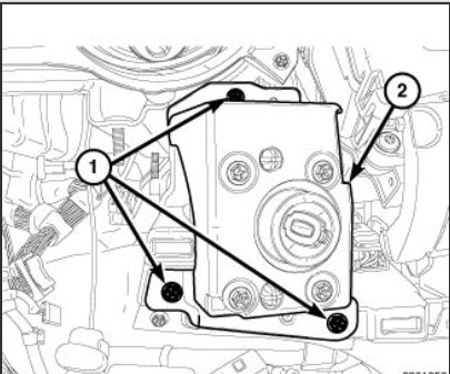

Can I ask if any of the light come on like the interior lights or headlamps? If you can upload a short video of the problem it will help us fix it. It sounds like to me that the ignition switch node has gone bad which is common. You will need to remove the dashboard to get to it, here is how. Check out the images (below). Let us know how it goes
