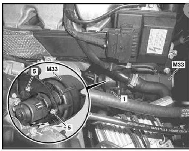

I listened to it using a screwdriver and it is coming from this thing. Do you know what this is? Looks like there are two of them side by side. Sounds like power steering but the pump is on the other side of the engine. If i remove the belt to see will the check valve pump still work? Trying to see if i can eliminate.

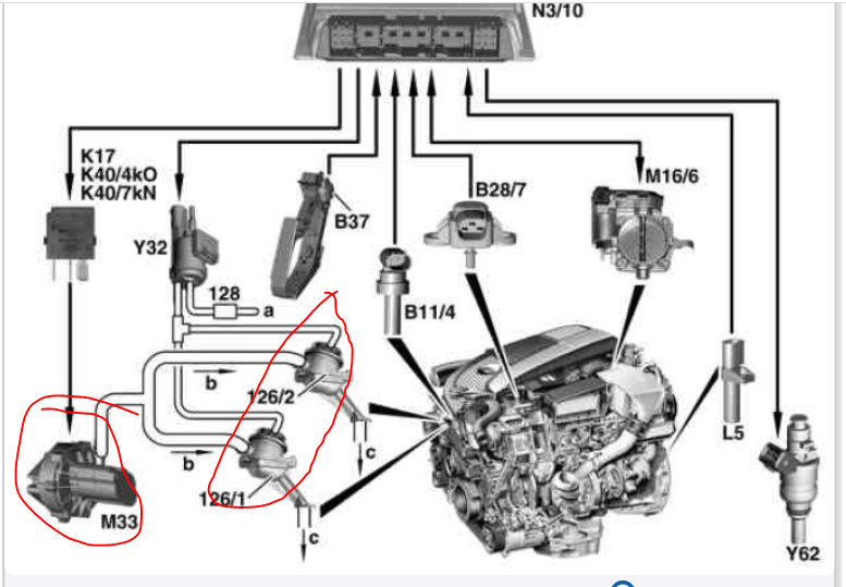

If you look below, I attached a pic and circled a few things. Do you recognize any of the items in the pic?
Item
M33 is an electric air pump.
Y32 is the air pump switch-over valve
126 shows the two-air injection shut-off valves. Those are the two things I suspect you are seeing.

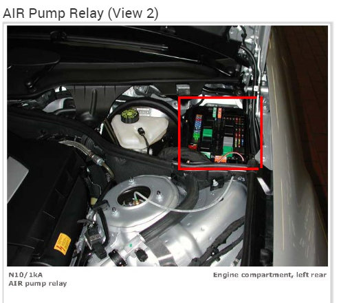

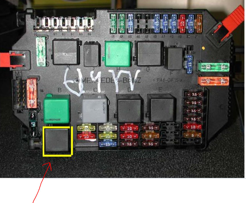

If you look at the last two pics, they are of the under-hood fuse/relay box. In the last pic, I indicated the air pump relay. Remove that and see if the sound stops.
