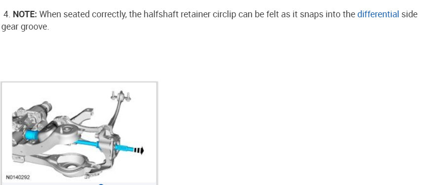

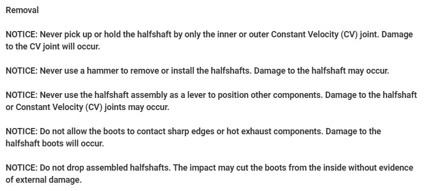

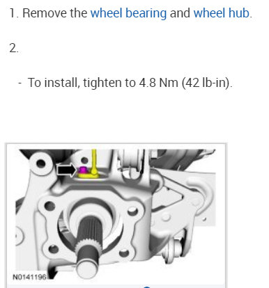

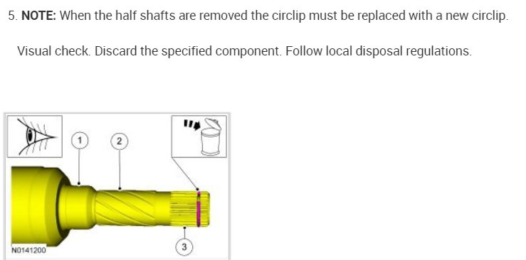

It sounds like you might be having an issue with the rear CV axle (propeller shaft). Usually when they begin to fail you will hear a clicking,thumping,cracking sound when making turns over going over uneven road surfaces like you described. Here is a tutorial showing what is involved for a CV axle replacement:
https://www.2carpros.com/articles/replace-cv-axle
Most shops are able to check your CV axle for possible damage including a brake check for free. I've attached picture step-by-step replacement instructions below for your vehicle below.Hope this helps and thanks again for using 2CarPros.

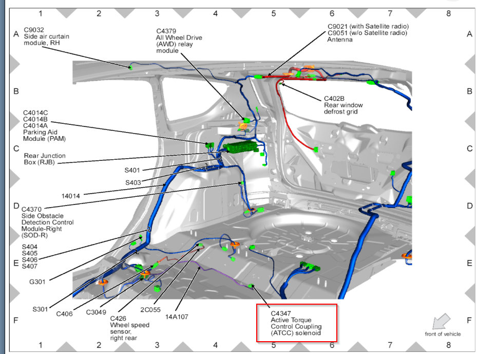

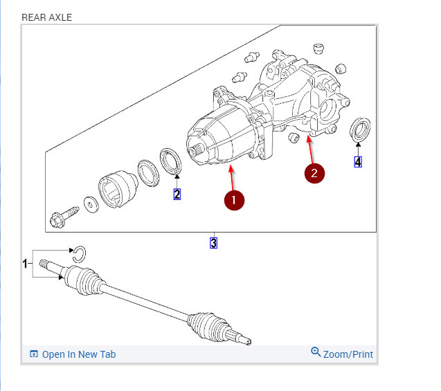

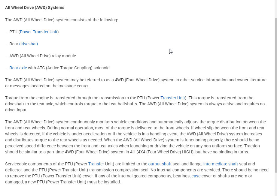

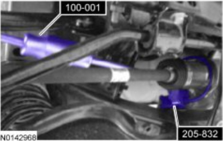

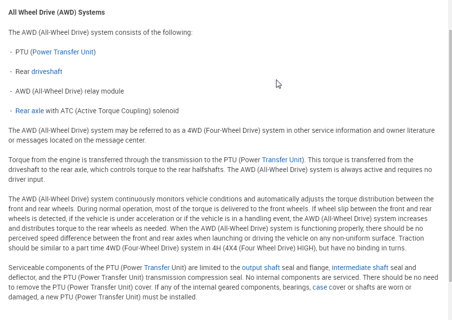

Okay. This sounds like an issue that is pretty common on AWD vehicles. Basically they have a system called active torque coupling. This means when you are in a turn and accelerating the vehicle is put into 4WD mode to give you the most traction in case you need it. This clunking noise is either coming from the clutch in the rear or the rear differential itself.
I would suggest unplugging the coupling solenoid that I show in the attachment and then see if it still does it.

So if the noise stops after I unplug the coupling solenoid, does that mean that the coupling solenoid is the issue?
May 19, 2020 at 2:06 AM
It would not be the solenoid. It would be the rear coupling unit. The solenoid just engages the rear coupling so by unplugging it, you will not be engaging the rear unit so we know the issue is back there.
May 20, 2020 at 11:48 AM
BENNIEV
  • 7 POSTS
Well I unplugged the coupling solenoid, the noise stopped.
May 21, 2020 at 6:19 AM

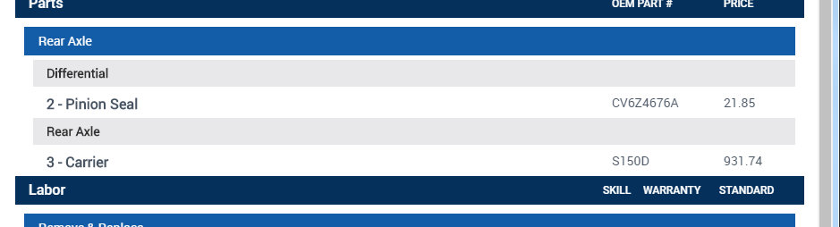

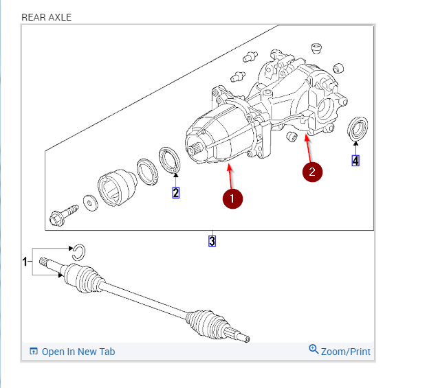

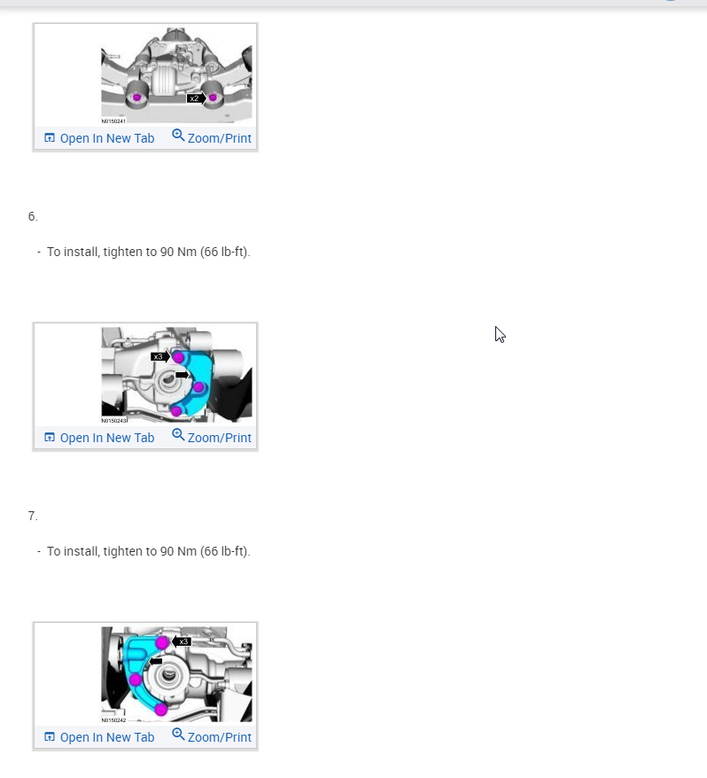

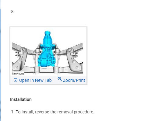

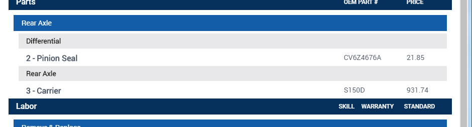

Unfortunately that means the rear is the issue. There is a clutch that the solenoid that you unplugged applies and disengages. Then the actual gearing in the rear differential. This is one unit and will require replacing. I attached the detail on this. It is not cheap so you have the option of leaving that solenoid unplugged which leaves the vehicle in front wheel drive. Clearly not desirable but the part alone is almost $1,000.00.
Let me know if you have questions. Thanks
May 21, 2020 at 11:36 AM
