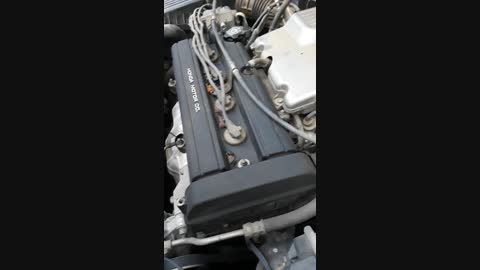

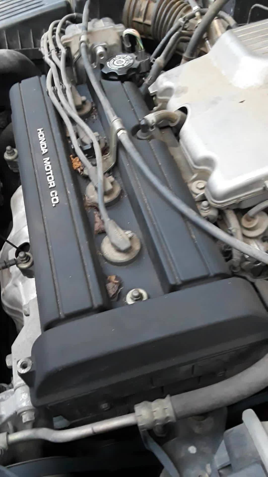

The problem is that after starting the engine, a gear grinding noise from the top of the engine near the starter has surfaced. This was after the oil pan gasket and oil was replaced.

It sounds like one of two things has happened; either when the oil pan repair was done they inserted an inspection shield or have the bolts in the wrong place and now are hitting the flywheel or the starter motor Bendix return spring has broken causing it to contact the flywheel. To check for this remove the starter to see if the gear is retracted into the starter housing. Can you please shoot a quick video with your phone so we can hear the noise? That would be great. You can upload it here with your response.

This is the noise that the 2000 Honda CRV four cylinder 2.0 liter is making. Hope this helps you. I will be waiting for a response. Thanks

Thanks for the video it helps. Yep dont run it anymore, It sounds like something is hitting the flywheel. Remove the serpentine belt to eliminate any accessory issues. Then turn the engine over by hand to pinpoint the noise. Going to be a dust shield or like I said the starter bendix or the starter is not in right. Please let us know what you find. We are interested to see what it is.
