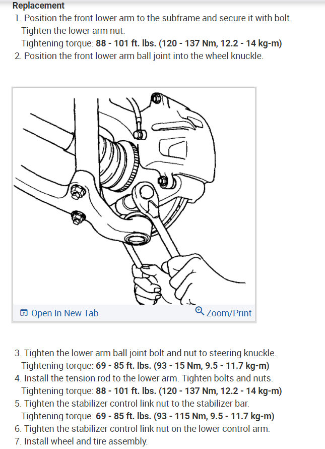

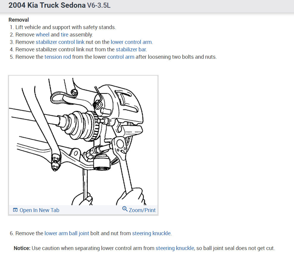

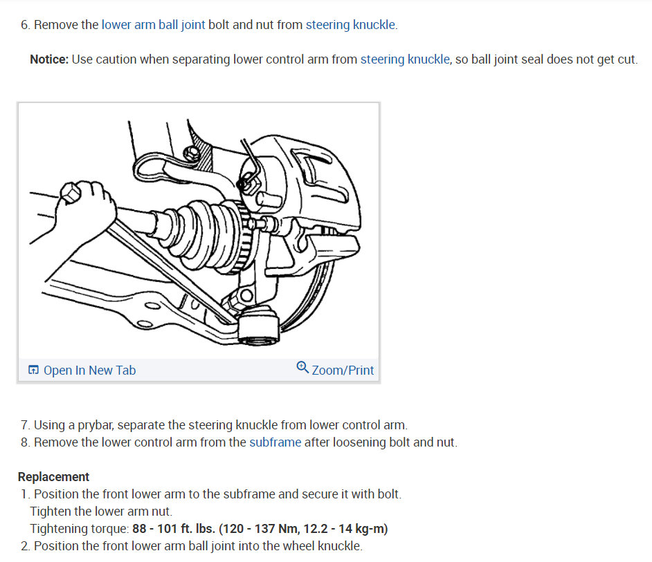

So turns out I had two different issues. one someone stole my catalytic converter and I need a lower control arm for the passenger side. For the sounds that in we hearing.
Sep 14, 2020 at 1:18 PM
  • 54,130 POSTS
Oh boy, it happens. here is a video to help see what you are in for when replacing the lower control arm on a similar car with instructions in the diagrams below to show you how on your car:
https://youtu.be/g_hj1hRSNgg
Please start a new question for the catalytic converter replacement if needed. Check out the diagrams (below). Please let us know if you need anything else to get the problem fixed.
