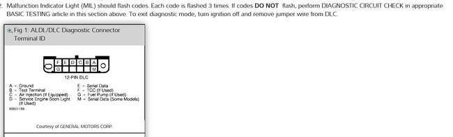

Back again, I am still having no power on the Corvette engine. It has the fuel pump that the 1994 had. I changed fuel filter filthy black. I have not checked the pressure yet, but when I got the truck back a month ago I did not make it home and the engine blew, so I put the Corvette engine in, but I failed to mention that the no power problem it was doing it to on the other motor-home power. So what does it sound like? (It does not have converter on exhaust) so what is can it be service light is on.

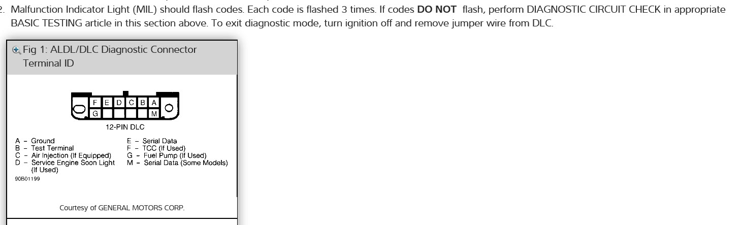

Scan for codes first to find out. As long as you have kept the 1994 stuff on truck it should work like normal. See picture on how to scan for codes.
