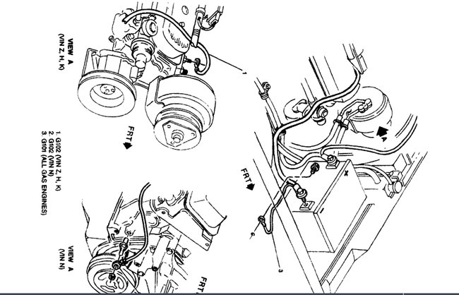

No start, spark at battery connection
IR472
  • 1995 CHEVROLET 1500
  • 5.0L
  • V8
  • 2WD
  • 200,000 MILES
New battery is arcing real bad at negative post. Previously the truck died while driving (no start no electrical).
Is this a bad alternator sign or a short?
I did find what I think are ground wires for the starter (they're running down along with the "hot" starter wire) touching the heat shield. I can not see how damaged they are but could that be it?
Saturday, November 21st, 2020 AT 3:52 PM
Good evening,
Yes, it could and most likely is the issue.
I would replace both battery cables.
