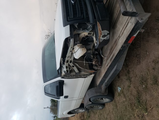

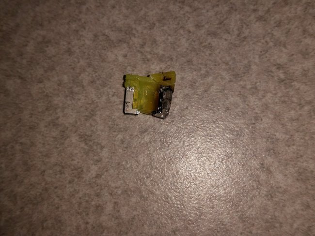

When I first got the truck the front passenger side had major collision damage. After doing the necessary body work the truck ran fine. Drove it for about 2 weeks with no real problems other then it had an unusually rough idle and the check engine light was on. Before I was able to check the engine light it rained. A lot. I drove in the rain and it sat in the rain, no garbage etc. Drove it home fine, them several hours later went to start the truck and it would not start. It would crank all day but not turn over. After about a day and a half of looking for a short, disconnecting and reconnecting several wiring connectors, and unplugging the negative battery cable for awhile untried to start it and it worked. Started right up which I though was because the truck dried out or maybe had a bad connection that got cleaned when I dis an re connected it. Then after another couple weeks I washed afterwards the engine light had said misfire number 8. Replaced plugs and coil packs but still said it was misfiring and idling rough then I washed the truck and again. Crank no start. I've spent almost a week now looking for a short or something. I've tried almost everything but still wont start. Also i took the instrument control panel, HVAC and radio, steering wheel, and dash side wiring harness from the cab off a 2014 xlt to 4x4 to put in my 2wd stx. Now the ICP is throwing network codes. I've flashed my BCM, PCM, IPC and now Pat's has me locked out and it wont even turn over now. I do not know if I should go back to the crappy base model trim or what my problem is. Please help as I need to go to work in a couple days and I can't.

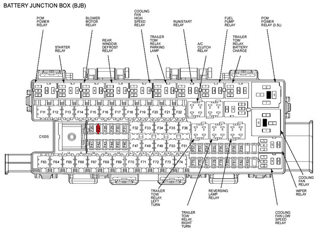

Can you give us the codes that you retrieved for the BCM, PCM, IPC? this will help me determine your next step. Also these trucks have issues with the fuel pump fuse and the fuel pump driver module, which could have been your problem all along.
Jan 16, 2021 at 10:15 AM
TAYLORRAY1986
  • 17 POSTS
All fuses and relays ohmed out, and none were burnt.

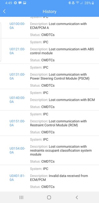

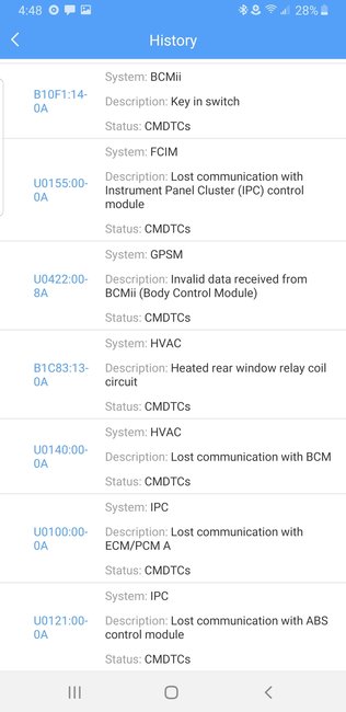

Codes.
Jan 16, 2021 at 10:16 AM
  • CAR REPAIR CONTRIBUTOR
  • 54,193 POSTS
That's a lost CAN system! I dont think any of the flashing of the worked and none of the module are talking. Off to the dealer for a complete re-flash they will load it from the Ford network database. Please let us know what happens.

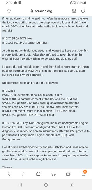

Update: so at the dealer they couldn't do anything so I towed the truck home. I reinstalled everything, body harness, every module, everything back the way it was from the factory. I also bought the VCM II from Bosch, not a china clone, and the FJDS 2 day software license from from ford. I've tried my.pcm and a refurbished one and every time i go to program the PCM it shuts the truck off and won't read it and after trying the wake up the PCM it finally gives up and the truck comes back on. I also still cant get my abs, RCM, or PSCM to come back online. Please advise. Oh, and I got the OEM factory wiring diagrams well.
  • 54,193 POSTS
The network needs to be programmed and tested, this is like installing the operation program for windows, going to take some work. I would make sure you have all the stock parts and head back to the dealer. They will need to load the operation software from the Ford database.
TAYLORRAY1986
  • 17 POSTS

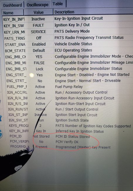

I already put all of the stock parts back on the truck, wiring harness, HVAC, ICP. The whole 9. It's just the BCM hasn't stored the PCM Id and when doing the PMI the PCM wont go through with the installation. I understand the concerns for going to the dealer, but I have everything the dealer does? AsBlt data from ETIS, VCM II, FORD FJDS. I'm not against going to the dealer, just out of money.

When you described the issue with programming when the engine cut off that rang a huge bell in my head and I'm currently going through my mental rolodex! I know that I've come across this before and when you shared the snapshot of your data what sticks out to me is the first few things on that list that refer to key in data and above your circle the "inferred" key in. A huge huge issue there! Inferred means that the module doesn't actually see the key in the ignition but the module is active as if the vehicle is hotwired or something, which will shut things down in a hurry! The issue seems to be with the BCM or BCM programming! Enter PATS 10 minute programming and select "parameter reset" from the menu, The parameter reset tells all of the modules that the "new module" is on the team now so shake hands lol, so to speak! Try that and let us know what happens!
TAYLORRAY1986
  • 17 POSTS
Thank you so much because I thought it meant like infrared, showing the key was in! I just got a new/used BCM and rewrote the As blt to match mine. i erased and reprogrammed the keys, trying the parameter reset now. I'm going to feel silly asking this, and even smaller if you confirm my suspensions. This code; B10F1:14-0A Key in switch, circuit short, (it's where the key and ignition key cylinder worn down and not making positive connection to turn the door chimes and stuff on) is that what causing it not to learn the pats!? Will update soon.

Update, solved.
After erasing my keys pats wouldn't allow my truck to start without a parameter reset which everytime I tried to do one it always faulted before going through to the pcm. After finding a truck of the same year nodel I took my pcm, bdycm, and ipc, and put them in another truck which allowed me to do the parameter reset needed to crank the truck. Once I got the truck cranking using a power probe I found the fuel pump driver module was faulty. Bad wiring in the harness wasn't allowing the parameter reset to be done in my truck however everything else is running good, except a misfire in #4  which only miss at idle so I think they're just slightly clogged injectors.
Conclusion, fuel pump driver module, 50 bucks at autozone
