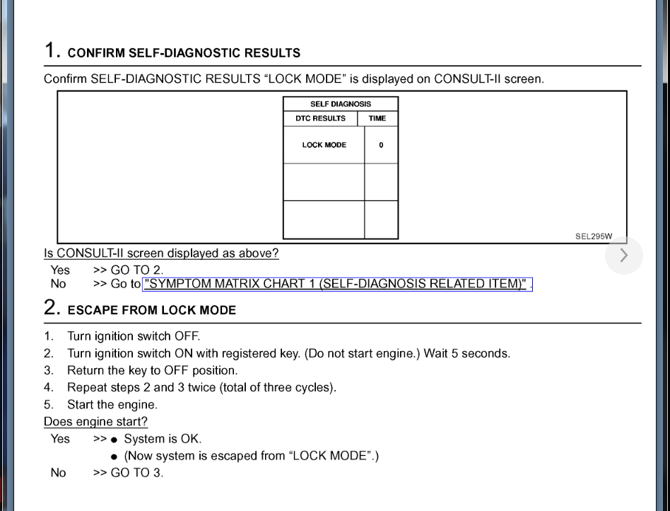

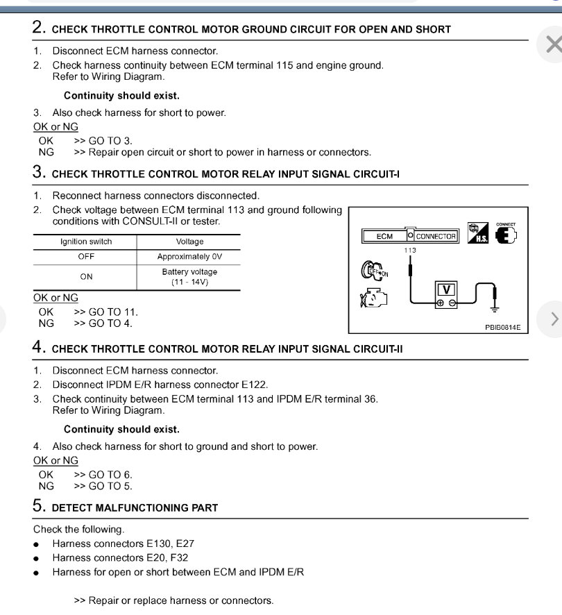

Cranks but no start I got of P1610 and P1612
ANDRIN ATEM
  • 2002 NISSAN ALTIMA
  • 2.5L
  • 4 CYL
  • 2WD
  • 190,000 MILES

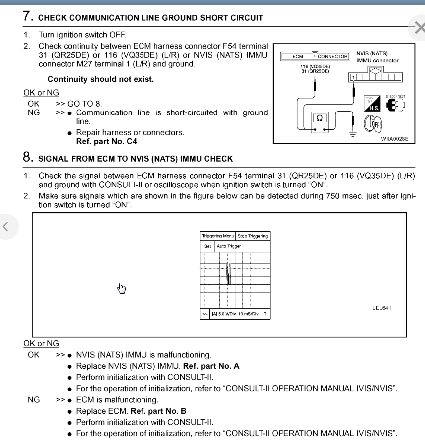

I realize the immo light stays on without blinking, it just stays on, when I insert the key to the run position it goes out even when I crank the car it remains off. I got of p1610 and p1612.
Saturday, February 15th, 2020 AT 3:54 AM
17 Replies

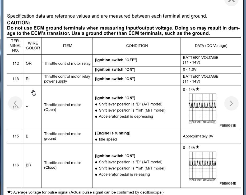

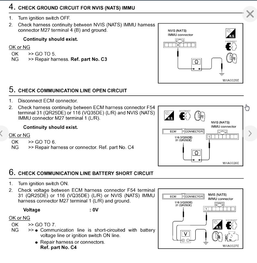

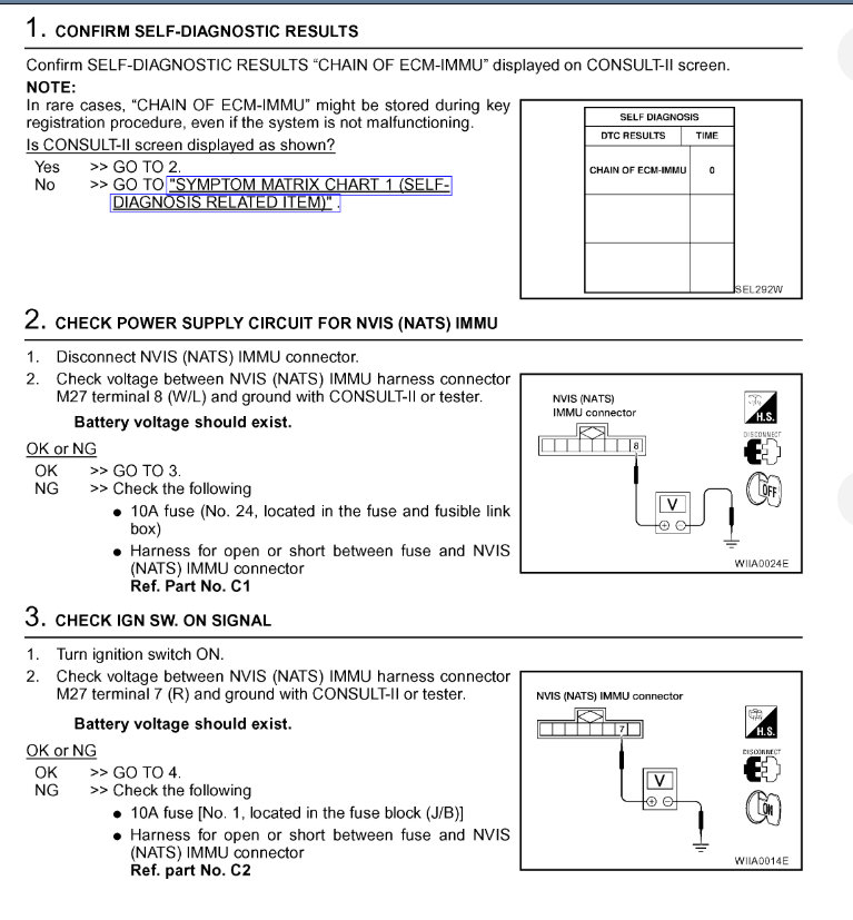

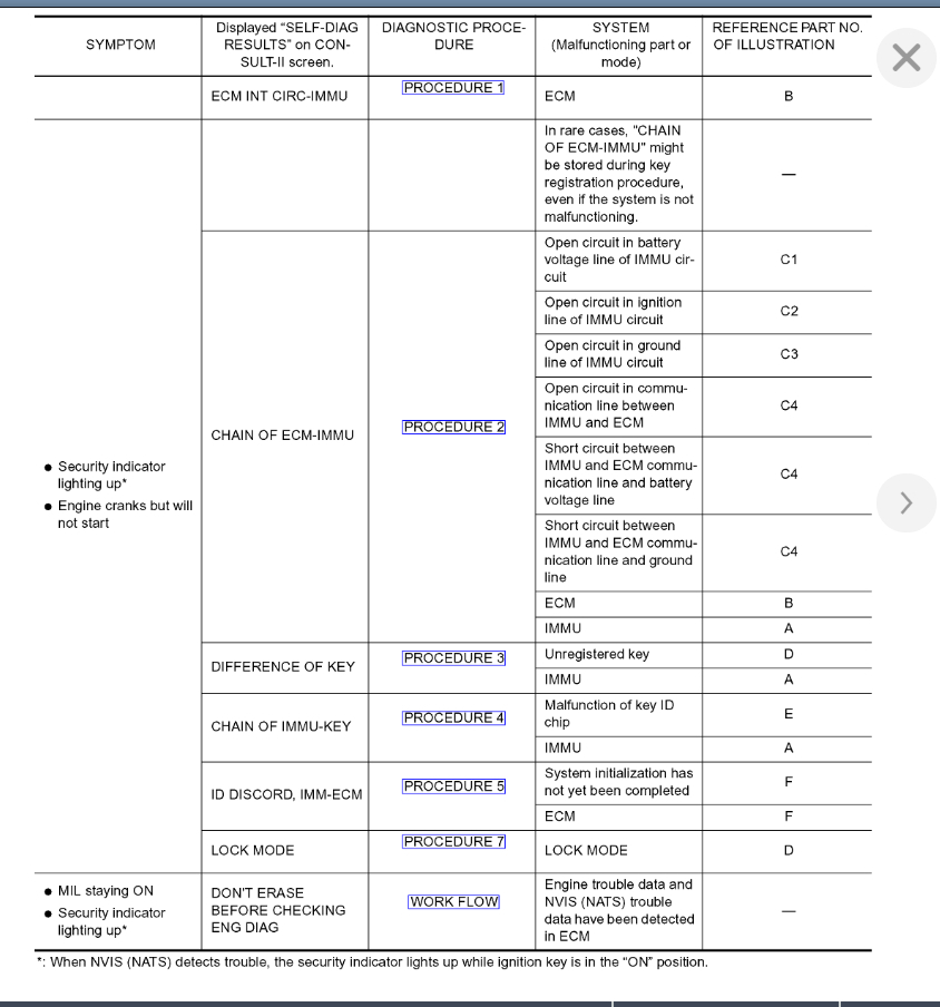

So you have an issue with this system. I attached the procedure for these codes. Do you have a scan tool that can run through these tests?
Unfortunately there are no tricks to try and bypass these tests so we just need to go from them.
Let me know and we can go from there. Thanks

Yeah. I would have to assume the diagram is correct so if your vehicle doesn't match this then I would think that is the cause of the no communication.

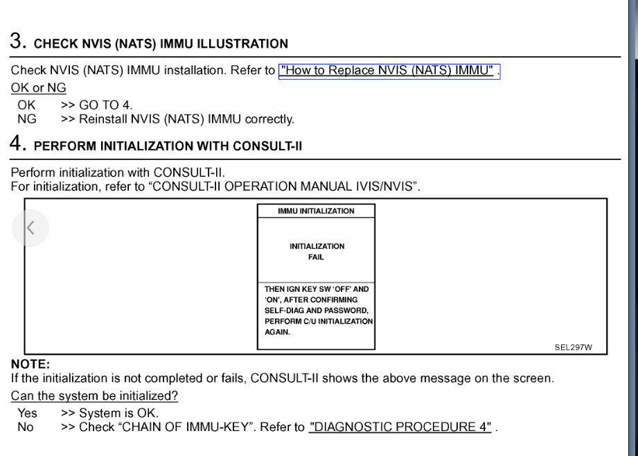

I am not sure I completely understand. You are trying to use your scan tool and it is not able to communicate with the vehicle? Does the vehicle start after you replaced the immo?
Sunday, April 25th, 2021 AT 1:55 PM
ANDRIN ATEM
  • 422 POSTS

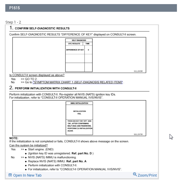

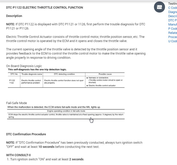

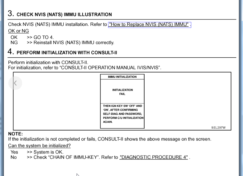

No it does not. Here are the dtc I got from the ECU: p1564, p1615, p1610 and p1122. I am not sure if I have to reprogram the key again. The immo security light blinks once in 3 seconds, which I think it's an indication that it's working well.

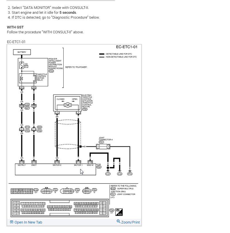

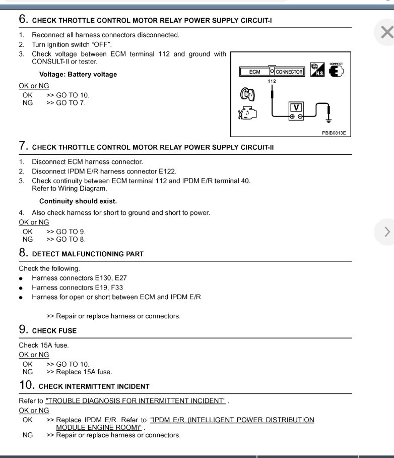

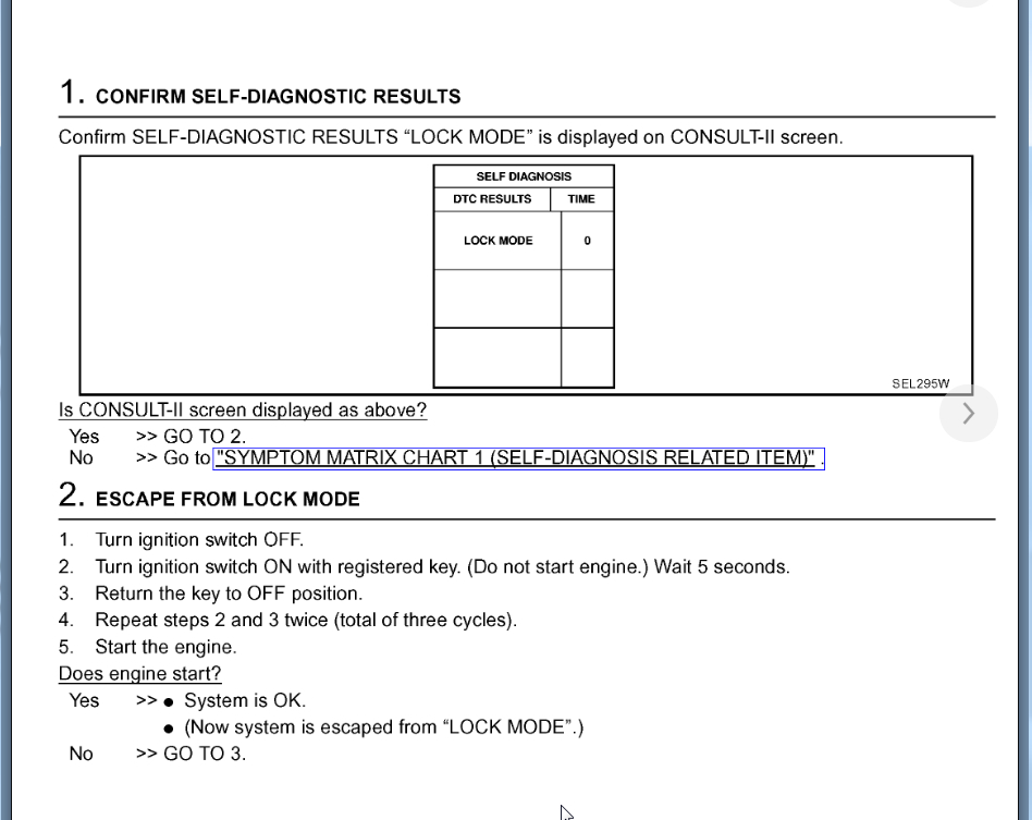

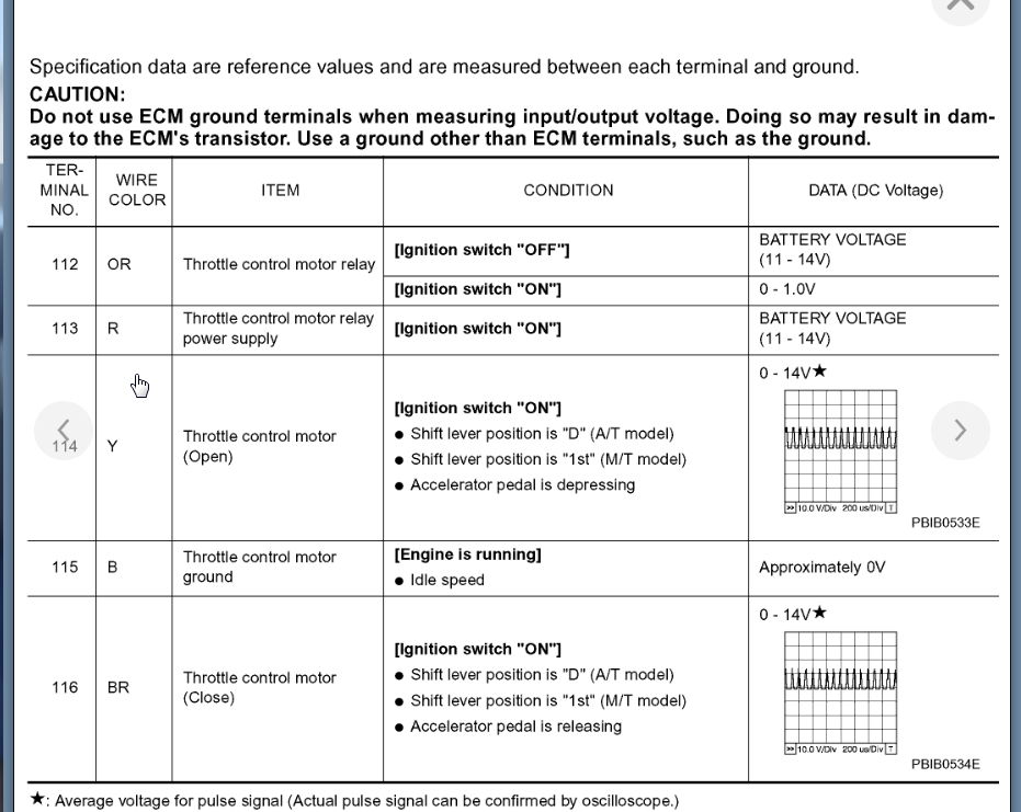

The P1615 and 1610 are related to the replacement. I attached the info for these. The P1122 I think is a different issue so I attached the diag for that as well. However, I would run through the key process and unlocking process the other codes talk about and then see what comes back.
+1
ANDRIN ATEM
  • 422 POSTS

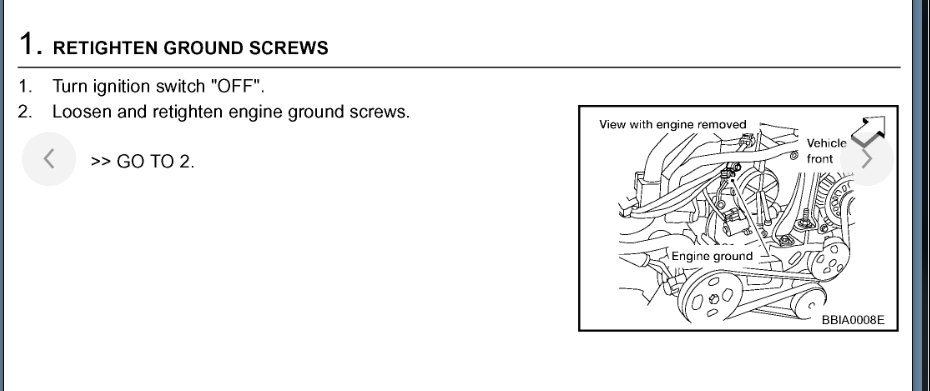

Thanks Ken, it was successful! I followed all test diagrams, and I was able to understand what I was dealing, after making sure my ground wires were all in good condition. I used the autel maxisys ms908pro to reinitialize the key programming, and that was able to start the car.
