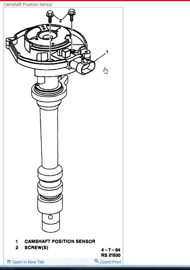

The truck was running just fine then I got code for a cam sensor. I did a check on the 12v positive and ground and they were fine, but my meter couldn't scope for a square wave on the single wire. So I bought another sensor and changed it out. Now all it does is turnover but it will not start. Any suggestions?

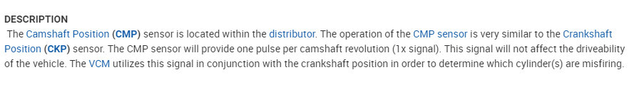

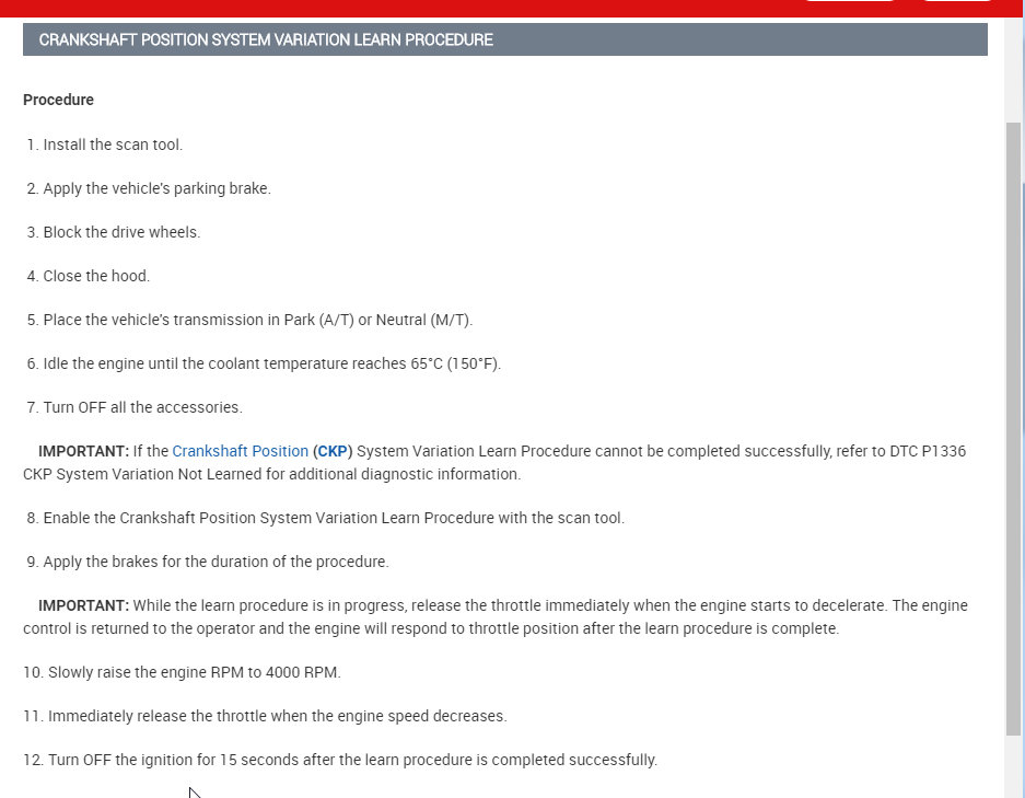

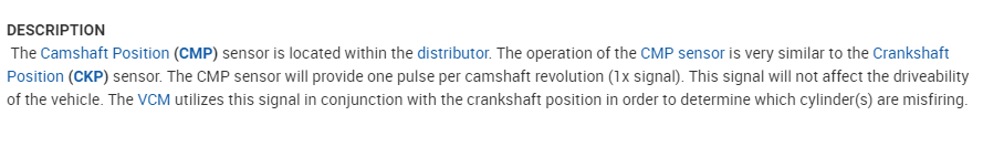

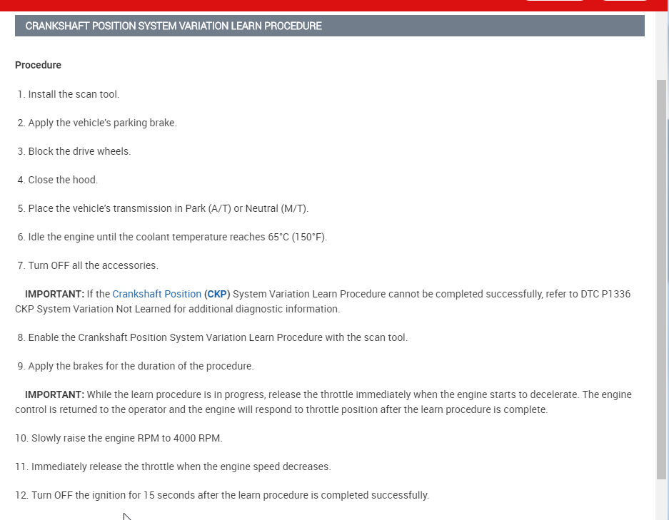

According to the procedure you only need to plug in the new CMP and do not have to program it. Plus you did not have to program the PCM to the new CKP sensor, you had to perform a CKP System Variation Learn Procedure. Basically this teaches the PCM the different windows of the new CKP because they are not all cut perfectly and if there are a little off it could cause running issues.
Also, take a look at the attachment, it says that the CMP sensor is only used for determining misfires and will not effect driveability.
I attached the procedure in case you have access to a scan tool you can try this but unfortunately it requires you to start the engine which is why I don't think it is your issue.
