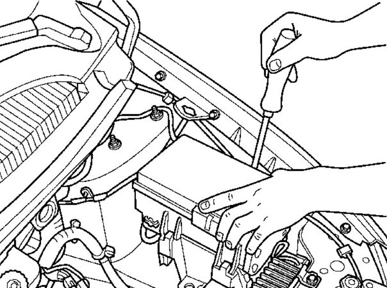

I would start with a new battery, then check the major fuses in the fuse panel under the hood. Here is a guide to help you fix it and I have included the fuse locations in the images below.

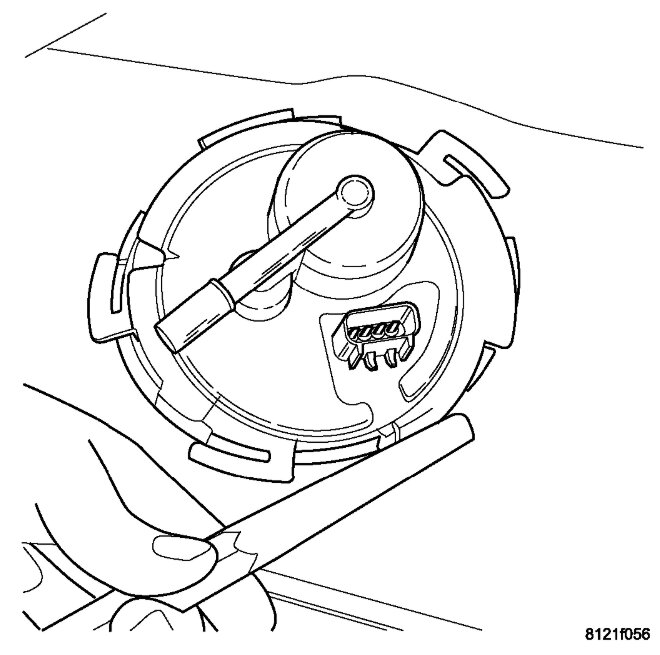

All fuses are good. I dont hear the fuel pump. I switched the fuses and relays same thing. Is the connectors to the pump inside the pump if i wanna check it?

Yep, a bad fuel pump is a common failure, here is the location so you can change it out. You will need to drain the fuel tank and remove it, here is how to drain the fuel, do not try to take the tank out full of fuel, it with be very heavy.

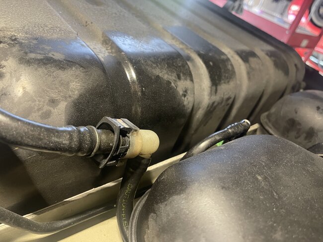

Removed all the fuel, loosened the 4 bolts but not removed yet. Removed harness and one of the fuel line connectors. Only thing left is this one, don't wanna break it, do you know how i can get it off

I broke one side of the outside esge not sure if it matters once i install ot
Aug 25, 2025 at 1:45 PM
  • 54,494 POSTS
As long as the safety holds it should be okay. If not you might need to rig something.

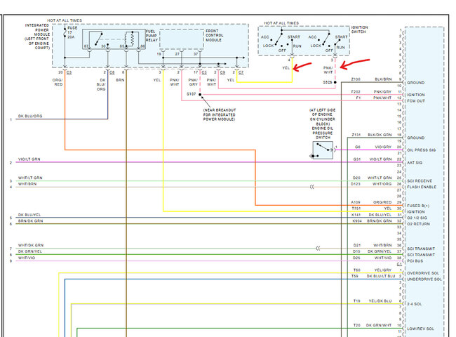

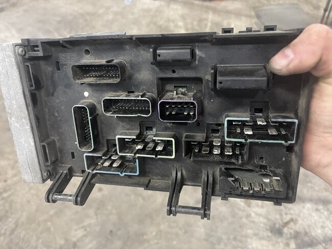

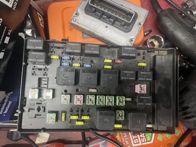

So changed the pump and I still couldn't hear it.Checked power and there was none on any of the wires to the pump.Moved relay with another still nothing. When I have my hand on the relay and while installing it I hear and feel the click. I removed it and jumped pins 87 and 30 and I immediately heard the pump come on, but still no crank. Checked ignition spark and there is none. So am guessing the PCM is dead? They die just like that? car was running fine and all of a sudden one day decided to stop starting. Removed the fender well to see if any PCM wires are cut or wet and I found neither. I tried to find PCM relays or fuses under the hood in same box and there was none.
Aug 30, 2025 at 11:50 AM
  • 54,494 POSTS

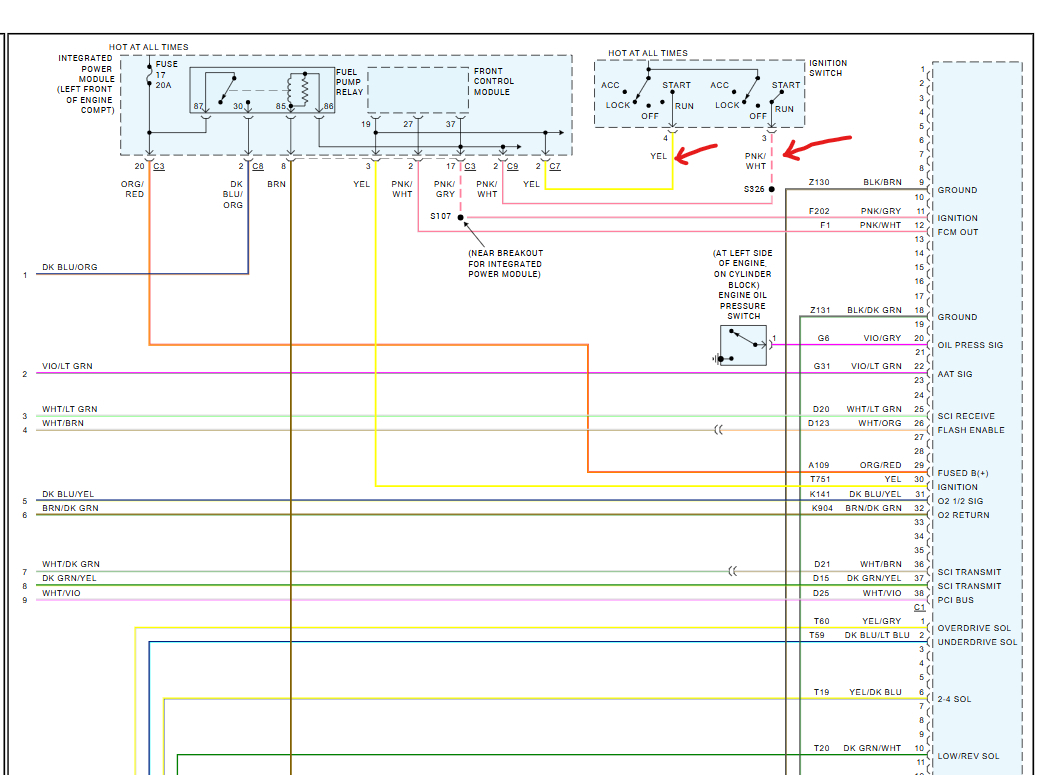

This can be a TIPM issue or the ignition switch, with the key in the crank and run positions check the yellow and pink/white wire coming out of the ignition switch. If they are okay chances are the TIPM has gone out. The PCM closes the trigger side of the relay by grounding it fyi. Check out the images (below). Let us know how it goes

You are saying these 2 wires should have battery power at run and crank?

Yellow should have power in crank only the pink/white wire should have power all the time when the key is on.
Aug 30, 2025 at 5:51 PM
BHAMDOC1973
  • 2,007 POSTS
I confirmed both wires have power one all the time one when cranking.
Aug 30, 2025 at 6:21 PM
  • 54,494 POSTS
Okay, that just leaves the logic inside the TIPM or the PCM is bad, but lets try something, unplug the MAF sensor to se if anything changes. Both will cause the scanner not to communicate. You can send them both in for testing.
Aug 30, 2025 at 7:11 PM

Is the TIPM easy to replace and does it need programming?
Aug 31, 2025 at 9:44 AM
  • 54,494 POSTS
Yes, it is easy and does not need programming.

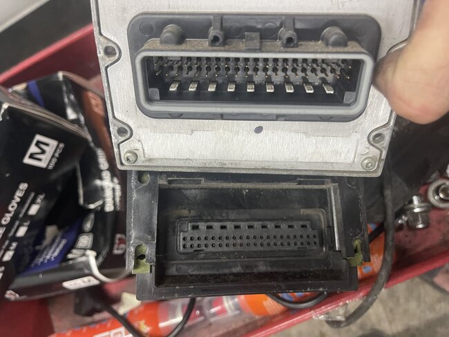

I think I see corrosion on the some of the pins on the their photo do you see it as well?
Sep 2, 2025 at 8:02 PM
BHAMDOC1973
  • 2,007 POSTS
ya I cleaned the connectors before I installed the other box, same results unfortunately. As soon as I connected the battery I saw a fuse popped which is for the abs, looked at the old fuse box same thing, but I don't think that has anything to do with it. I still don't hear the pump and don't see the RPM needle move at all. I am guessing the PCM maybe done
Sep 4, 2025 at 1:21 PM
  • 54,494 POSTS
Have you swapped out the ASD relay? Check out the images (below). Let us know how it goes
Sep 4, 2025 at 6:45 PM
BHAMDOC1973
  • 2,007 POSTS
No, the used fuse box came with all the relays and fuses and they exactly the same position
