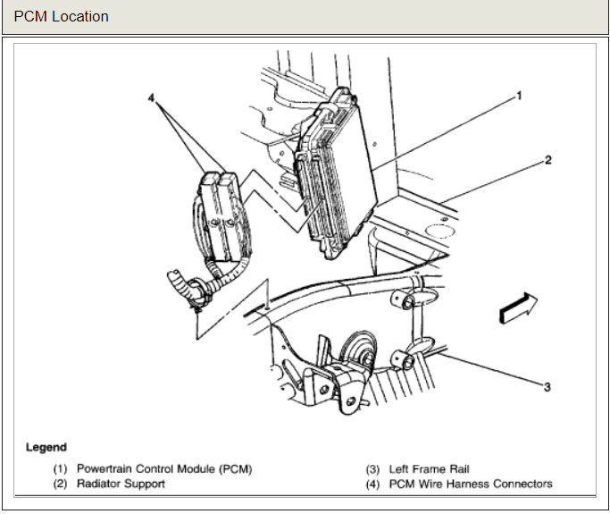

KEN L
  • MASTER CERTIFIED MECHANIC
  • 55,475 POSTS
This sounds like you lost the coil drivers inside the PCM which means it needs to be replaced. Here is the location.
You may be able to get a used one and plug it in to confirm the issue.
