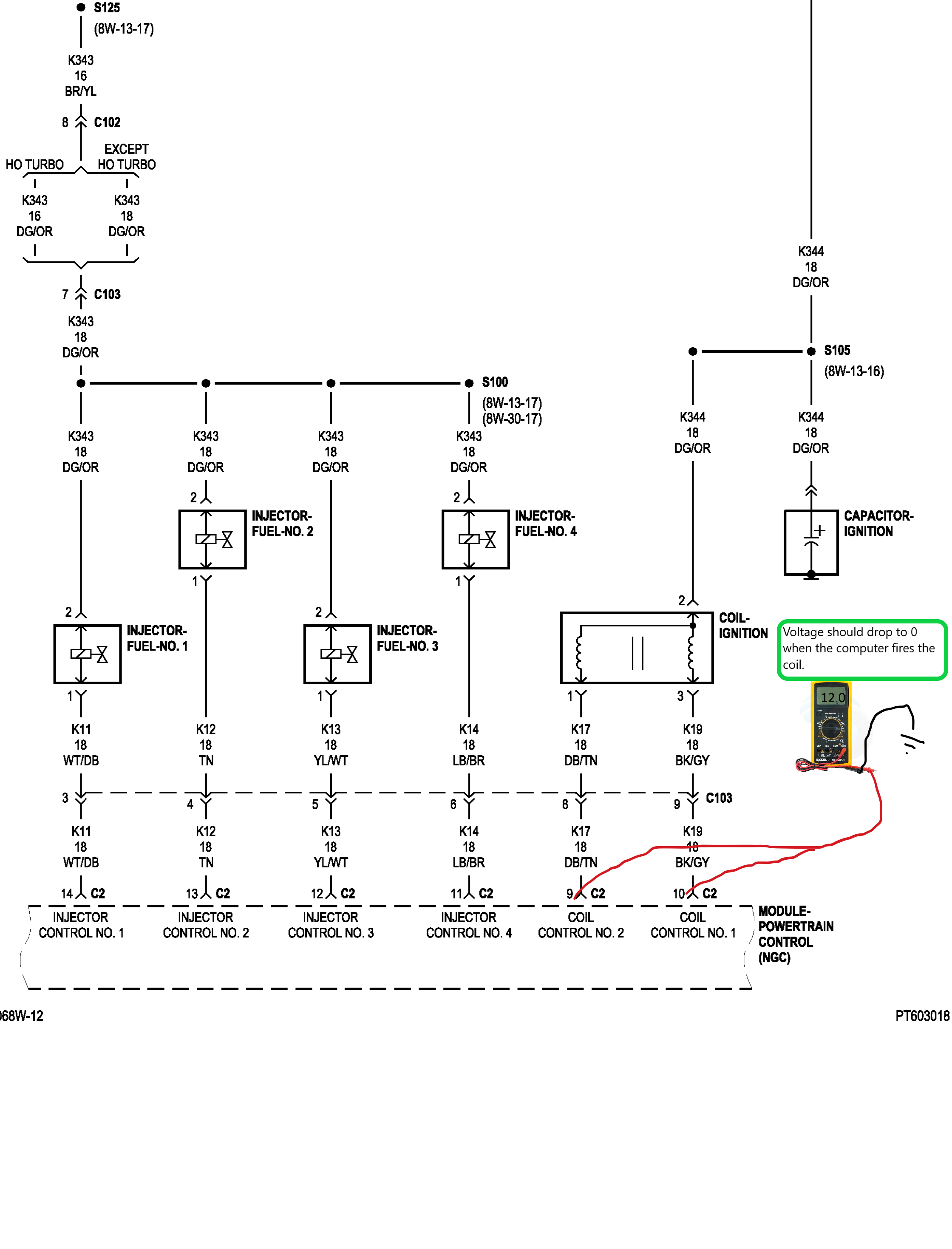

Car listed above is has Turbo. Would not start, found out it was a Coil Pack issue. Replaced the Coil Pack and found out there was not spark on numbers 2 and 3. Is this a EUC/PMC issue? Need help. Thanks
Wednesday, October 2nd, 2019 AT 1:02 PM
18 Replies
BMDOUBLE
  • 1,139 POSTS
Bad coil drivers are somewhat common on these, you can check the circuit first to verify this. I've attached an illustration of a test for these coil driver circuits, you can also use a test light with the alligator clip clamped on to the positive battery terminal and back-probe the coil driver at the computer connector.

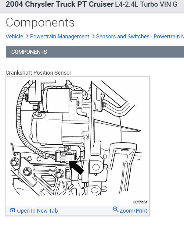

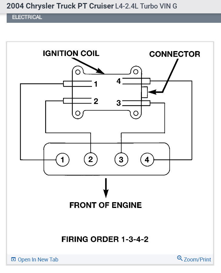

LEWISAUTO
  • 2004 CHRYSLER PT CRUISER
Not getting a spark no computer output. As a result the car is misfiring on 1 and 4. Car runs rough. 2 and 3 are okay. Can I get the firing order as well?
-1
Saturday, August 29th, 2020 AT 1:17 PM (Merged)
  • 75,992 POSTS
It sounds like you have a crankshaft position sensor that is not working here is a guide to walk you through steps of changing it and the diagrams below to show the location for your car with the firing order as well.

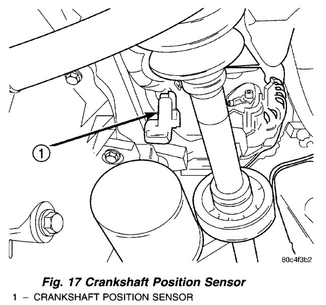

Hi, car sat for the winter while down in Florida car is in New York. Ran when was parked now no codes, cranks no start. No spark I read about the ASD relay where is it or is this even where to start. I read the PCM will turn off the power to the relay if cam or crank sensor input is no recognized. Is this correct if so where do I start to isolate the bad part? Thanks, Neil
Saturday, August 29th, 2020 AT 1:21 PM (Merged)
  • 110,192 POSTS
Welcome to 2CarPros.
The things you mentioned are correct, but before you jump to those things, lets start with some basic checks.
Now, since it ran prior to this and you have already confirmed there is no spark, my first suspect is the crankshaft position sensor. Also, the ASD will also shut down fuel supply. Are you able to hear the fuel pump run for a couple seconds when you first turn the key to on? If so, then no to the ASD.
Here are a couple links to describe the crank sensor, symptoms of a bad one, and in general how one is replaced:
https://www.2carpros.com/articles/how-a-crank-shaft-angle-sensor-works
___________________
Note that a bad sensor may or may not set a check engine light, so there will be no codes. Before you just replace it, confirm the wiring to it hasn't been damaged (mice love to chew on wires), corrosion isn't an issue and the connector is in good condition. The easiest way to confirm a bad sensor is using a live data scanner. If the sensor is bad, you will not be able to get an RPM reading on the scanner when trying to start the engine.
If you find it is the problem, here are the directions specific to your vehicle for replacement. The attached pic correlates with the directions,
Fig.17 Crankshaft Position Sensor
picture 1
The crankshaft position sensor mounts to the engine block below the generator, just above the oil filter.

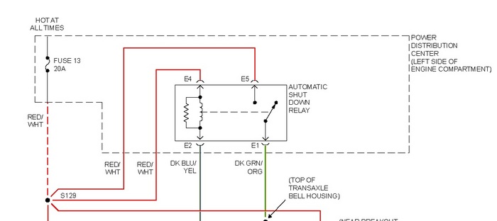

Ihave a 2001 pt cruiser limited edition its not getting any fire to the coil with a ohms meter I can get a read on the middle wire going to the coil thats it the crank and cam senser are good what coul it be
+1
JDL
  • 16,098 POSTS
Use voltage setting on meter to check for voltage. Dark green wire with orange tracer, is primary voltage to coil. Check for voltage on that wire, engine cranking, you may need a helper to crank it.
That voltage comes from asd relay. Note diagram below, check applicable fuse for voltage. Any applicable trouble codes?
