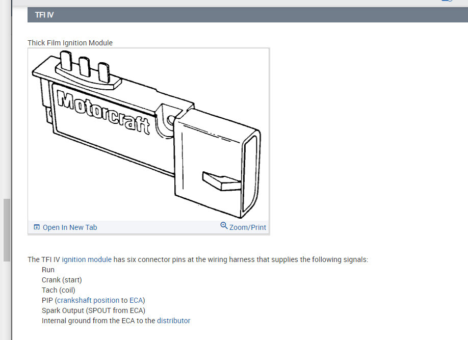

While warming up the vehicle shuts off. No spark. Cranks but no start. No spark. Unplug the timing bypass thing and it starts and idles. Plug it back in and within a minute or so it shuts off. No spark. Unplug it, it starts. Now this doesn't happen consistently, but when it does unplugging it seems to correct it. Help? Also, put in a new distributor, module, and coil 2 weeks ago for this very problem. Not to upset, but now it's time to find the real problem. Thank you.

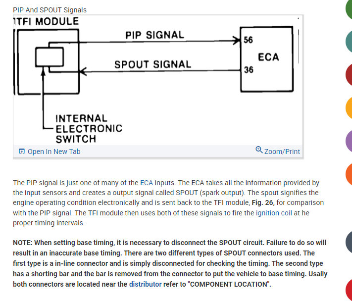

I am not sure what timing bypass component you are referring. I am thinking this is the Spout connector? This is the connector that you disconnect in order to set the timing.
Is this what you are unplugging and the engine starts and runs correctly? If so, I suspect the SPOUT or PIP is giving an incorrect signal and the TFI module is shutting the spark down.
Take a look at this info and if this is not correct, can you get a picture of this component that you are disconnecting and we can figure out what is happening.
I am attaching the info below on how this works which may help figure this out.
Let's start with this and go from there.

Yes, that is the part I'm unplugging to make the vehicle run. How do I test, or know if the PIP or Spout is sending an incorrect signal causing the TFI to shut down the spark signal? What causes the PIP or Spout to send the wrong signal? What do I need to replace? Thank you. Your help is much appreciated. I'll wait for your reply.
Aug 6, 2021 at 6:36 PM

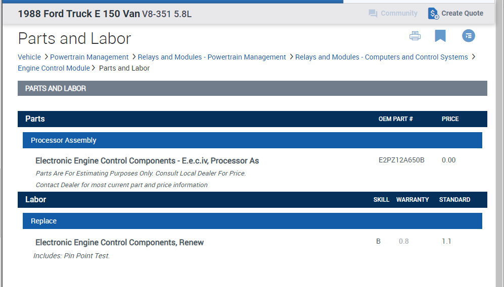

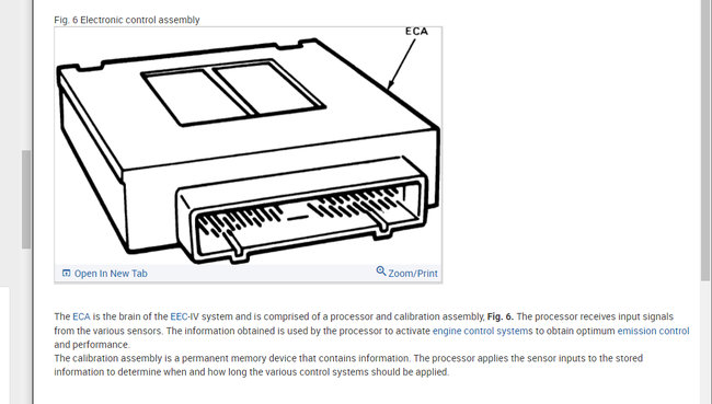

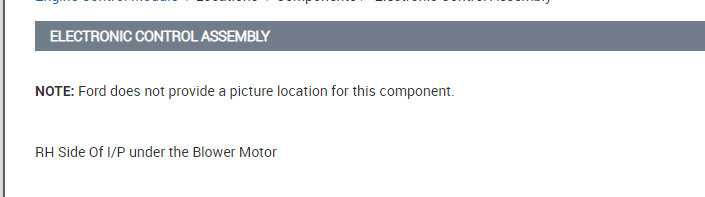

Okay. That is good. When you say you put a module in it, I assume that was the TFI module as that is on the side of the distributor (I think)? Or was it the ECA module which is under the blower motor.

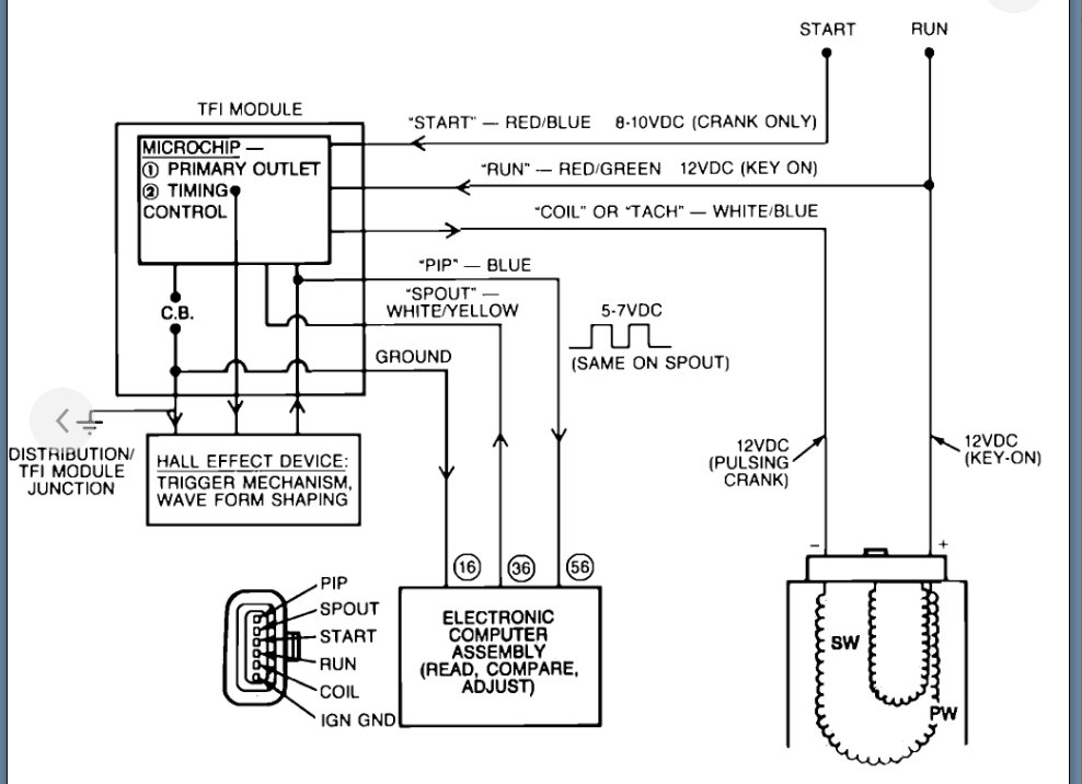

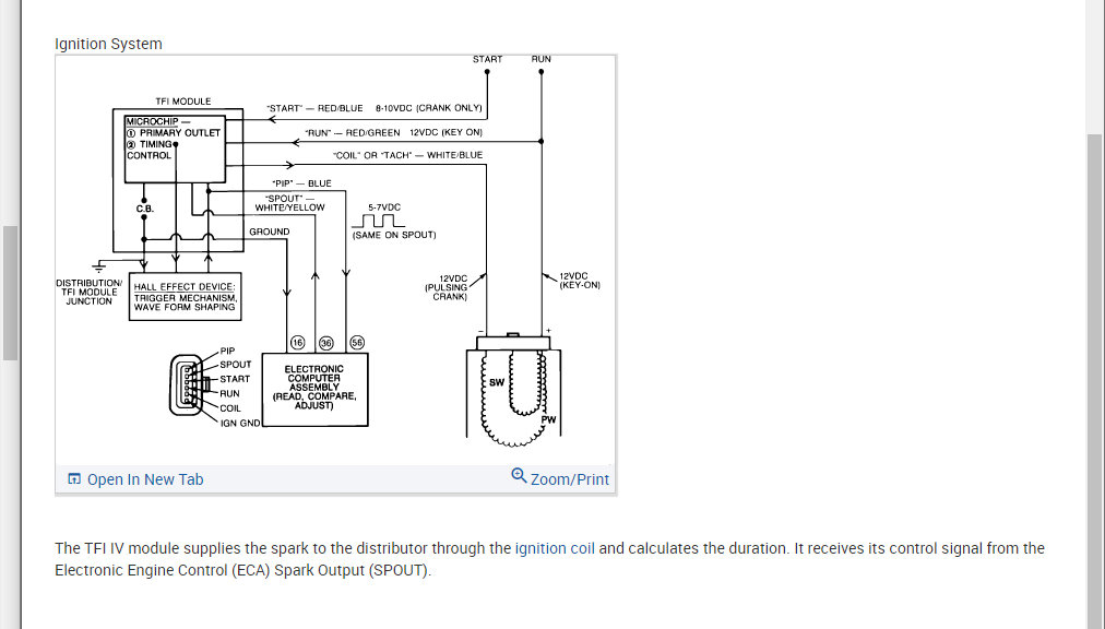

Basically the ECA sends a signal to the TFI module on the SPOUT circuit to adjust the timing and uses the PIP as well for proper ignition and fuel timing.
If you are unplugging the SPOUT and the engine runs, that forces the TFI module to use a preprogrammed timing set up. So I suspect the ECA is sending an incorrect signal to the TFI module which is causing it to stall.
If it were me, based on this info, I would put an ECA in it. Take a look at the info below and let me know if you agree.

Good morning, just letting you know computer is in, Spout connector in, van still running! Also I changed the water temperature sending unit just to cover all my bases being that the problem occurred as it was warming up. Every time I do something it works great for a week or two then seems to mess up again. I think this problem is solved! Of course I'll get back to you if it gives me trouble. And I'll get back to you if it doesn't. In a few weeks. I can't thank you enough, and all the diagnostic fees I might have incurred if I hadn't found you. My wife is calm and happy and you can't put a price on that. We love you man!
