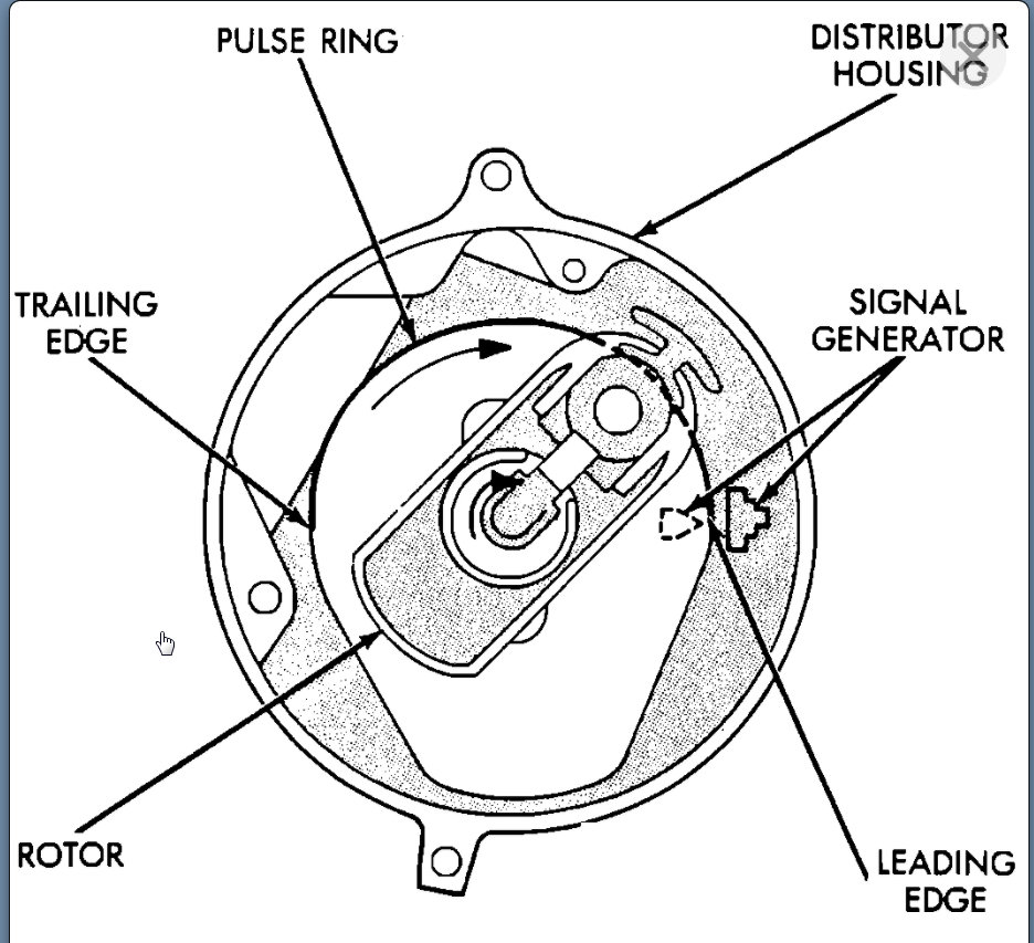

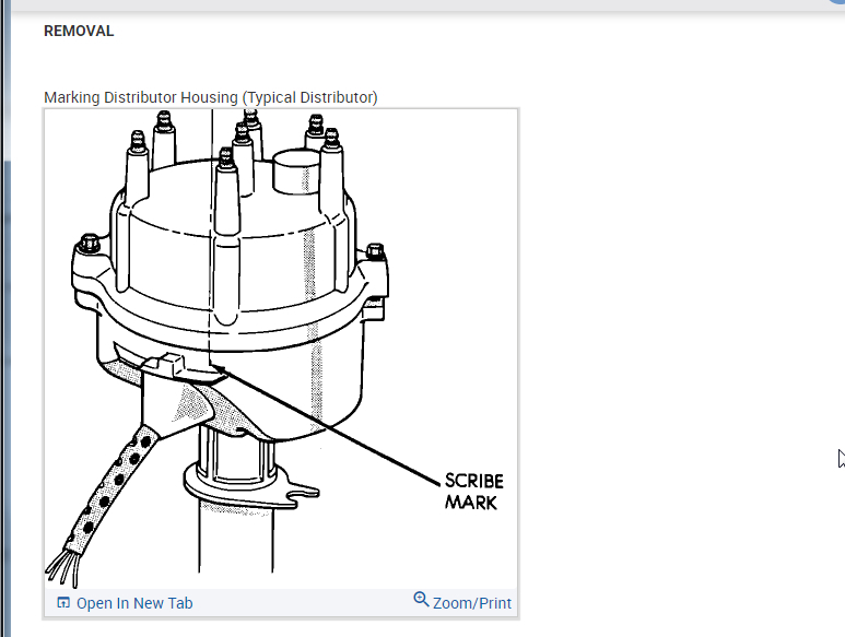

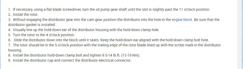

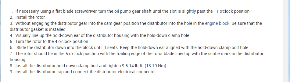

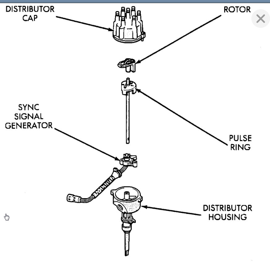

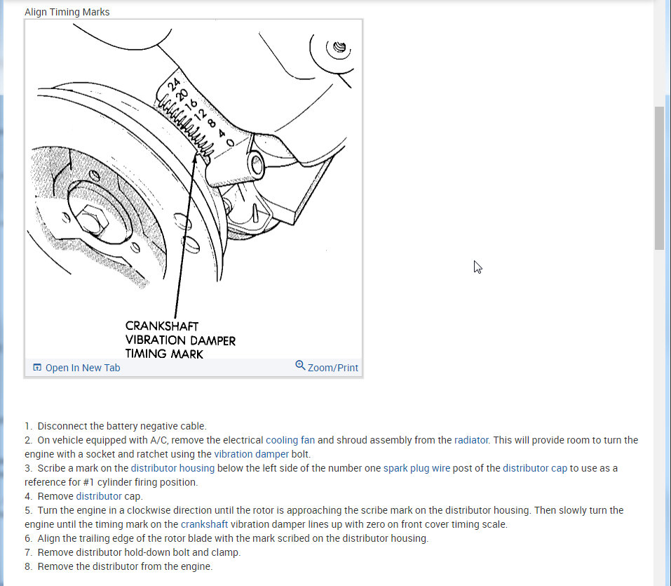

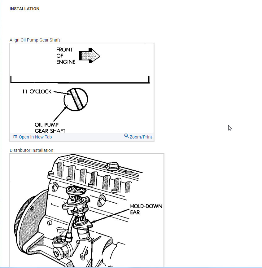

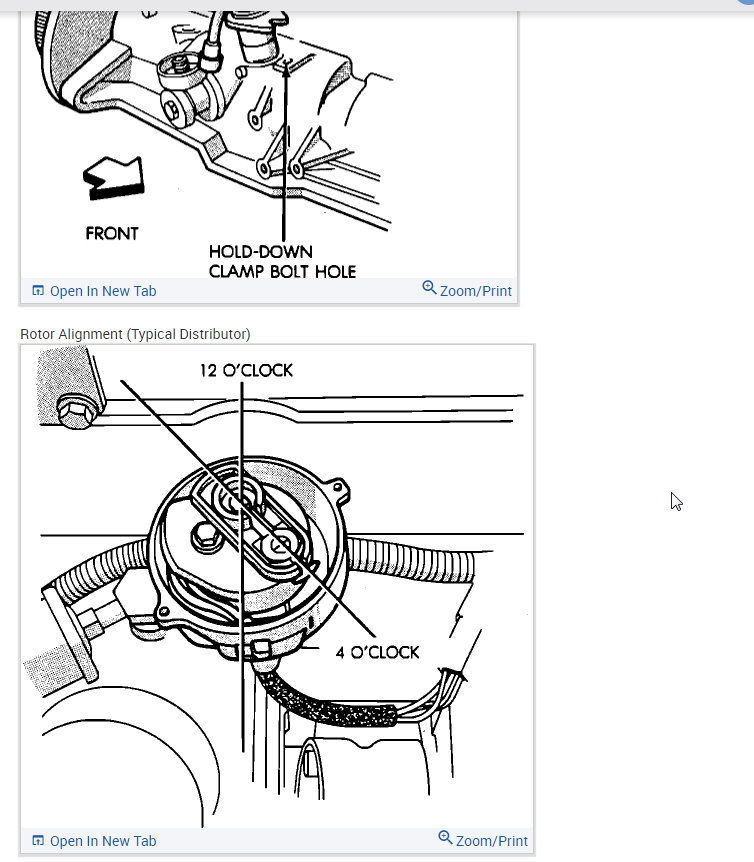

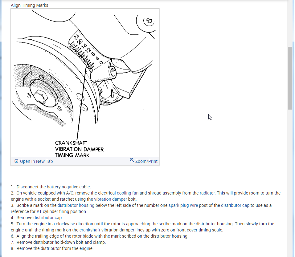

The fact that it is delivering spark to only 2 cylinders points to either the ignition control module or the distributor itself. I would remove one of the wires that is not getting spark and hold it close to the cap when you crank the engine. If there is not spark (safe to assume it is not) then I would put a distributor in it.
I attached the process below to do this. Let us know if you have questions.

Thank you for the reply. I would like to know why you are recommending replacing the distributor? I replaced the cam sensor/distributor pickup, in the distributor.
Would you please educate me here? I would like to understand.
Thank you
Friday, February 26th, 2021 AT 9:25 AM
When you say you are only getting spark delivered to only 2 cylinders, that points to the distributor itself. Specifically the cap and rotor as this is what spins and sends the spark to each plug wire.
I have seen many times where the distributor shaft/housing bearings are worn out and it causes the rotor to walk and the gap gets too large and it doesn't deliver the spark. Normally it will cause the rotor to hit the cap and it will break but not all the time.
If you have not replace the cap and rotor, I guess you can start with this but if you have or that doesn't solve it, I would replace the distributor.
