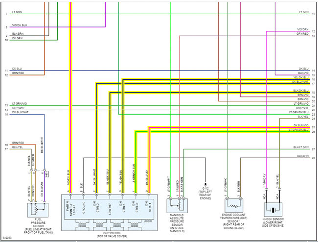

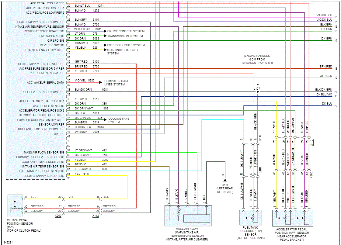

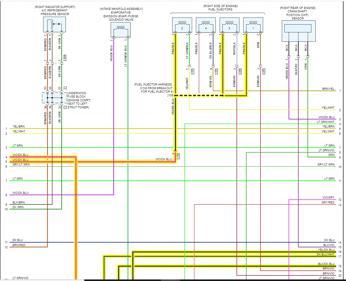

Hi, the above car doesn't have any spark from the ignitor pack. The pack is a new NGK 4-cylinder coil over pack. I want to check on voltage coming into the pack at the connector. Where do I find the appropriate schematics?

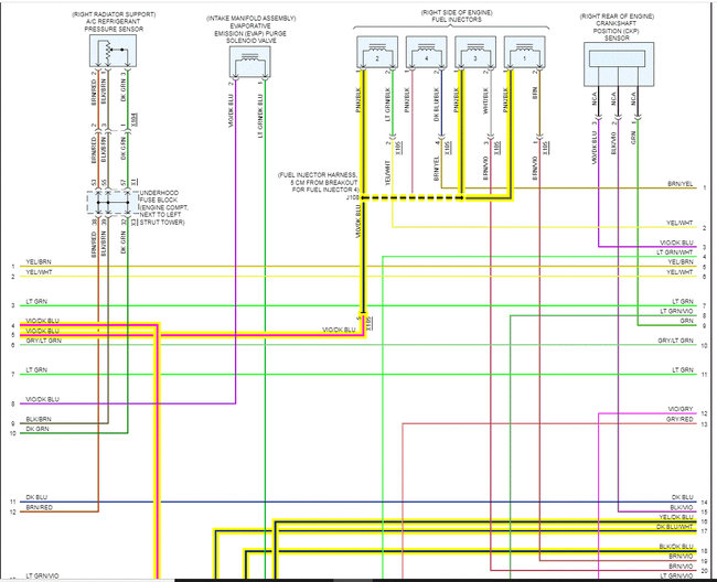

If you have no spark, are you sure the crankshaft position sensor isn't bad? Do you have an RPM signal when cranking the engine?

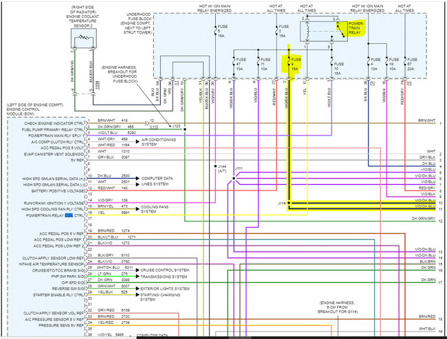

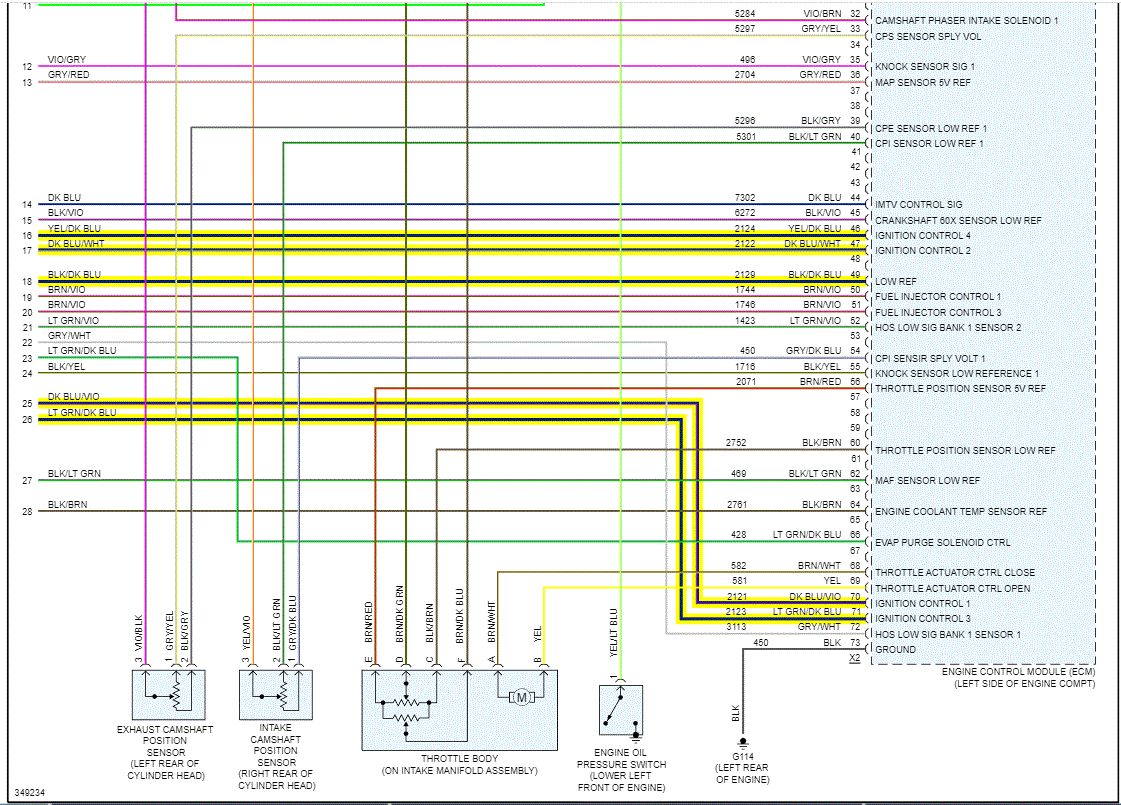

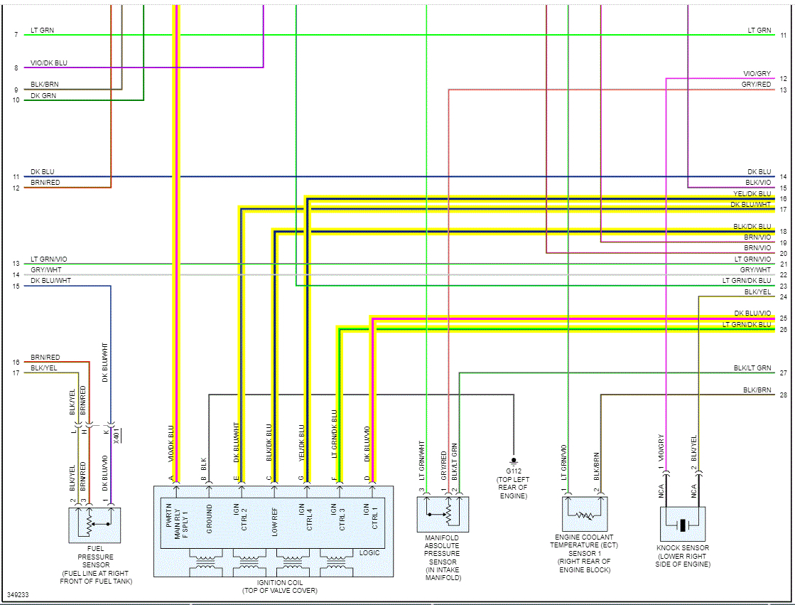

As far as the coils are concerned, they receive 12v from fuse 9 in the under-hood fuse box. However, the fuse has no power until the powertrain relay powers it. So, you may want to first check fuse 9, and confirm there is power to and from it. If there isn't, check the relay.

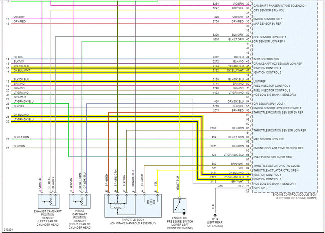

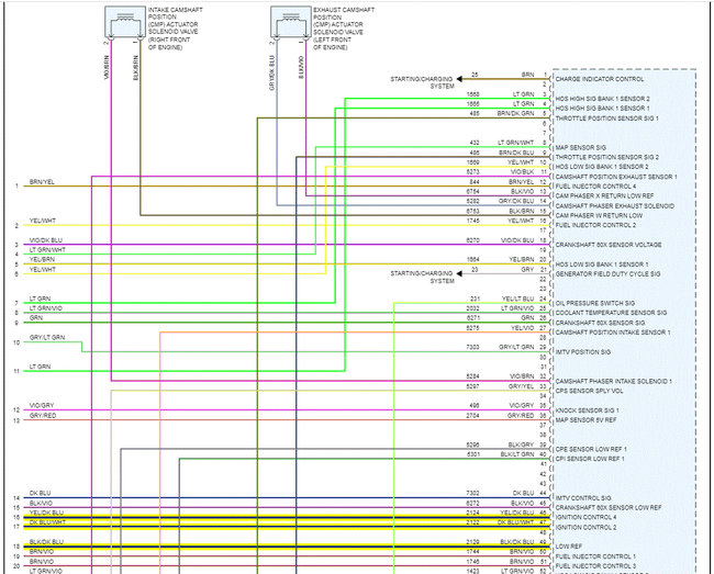

Next, the power from fuse 9 is present at the coil pack. For a specific coil to fire, a ground path is provided by the PCM. Once the ground path is provided, the circuit is complete, and the coil does its job.

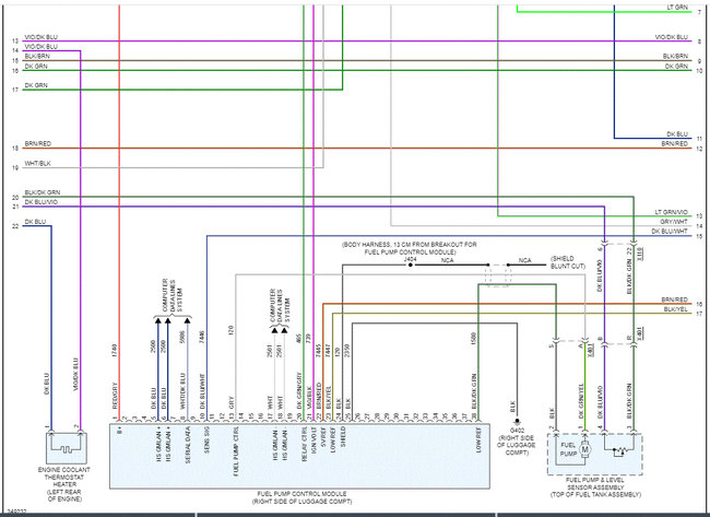

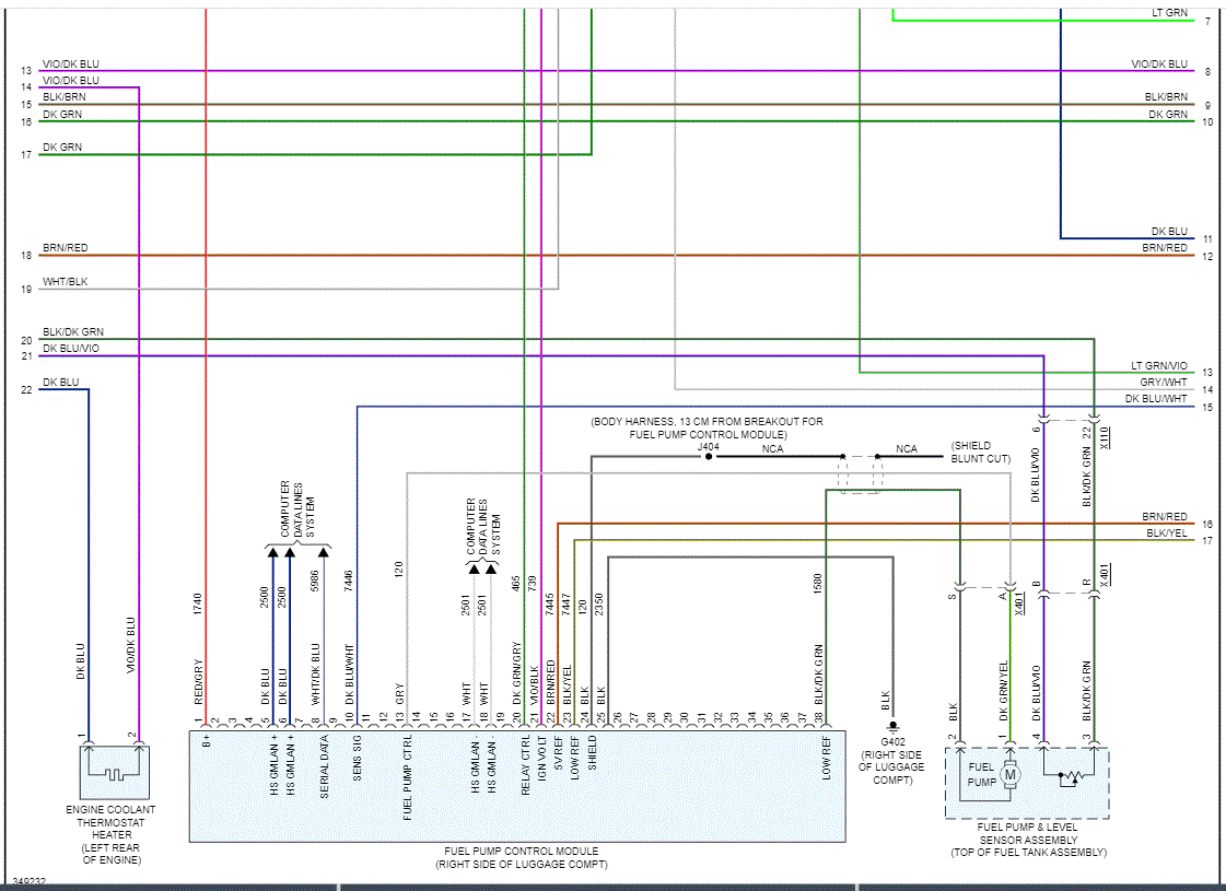

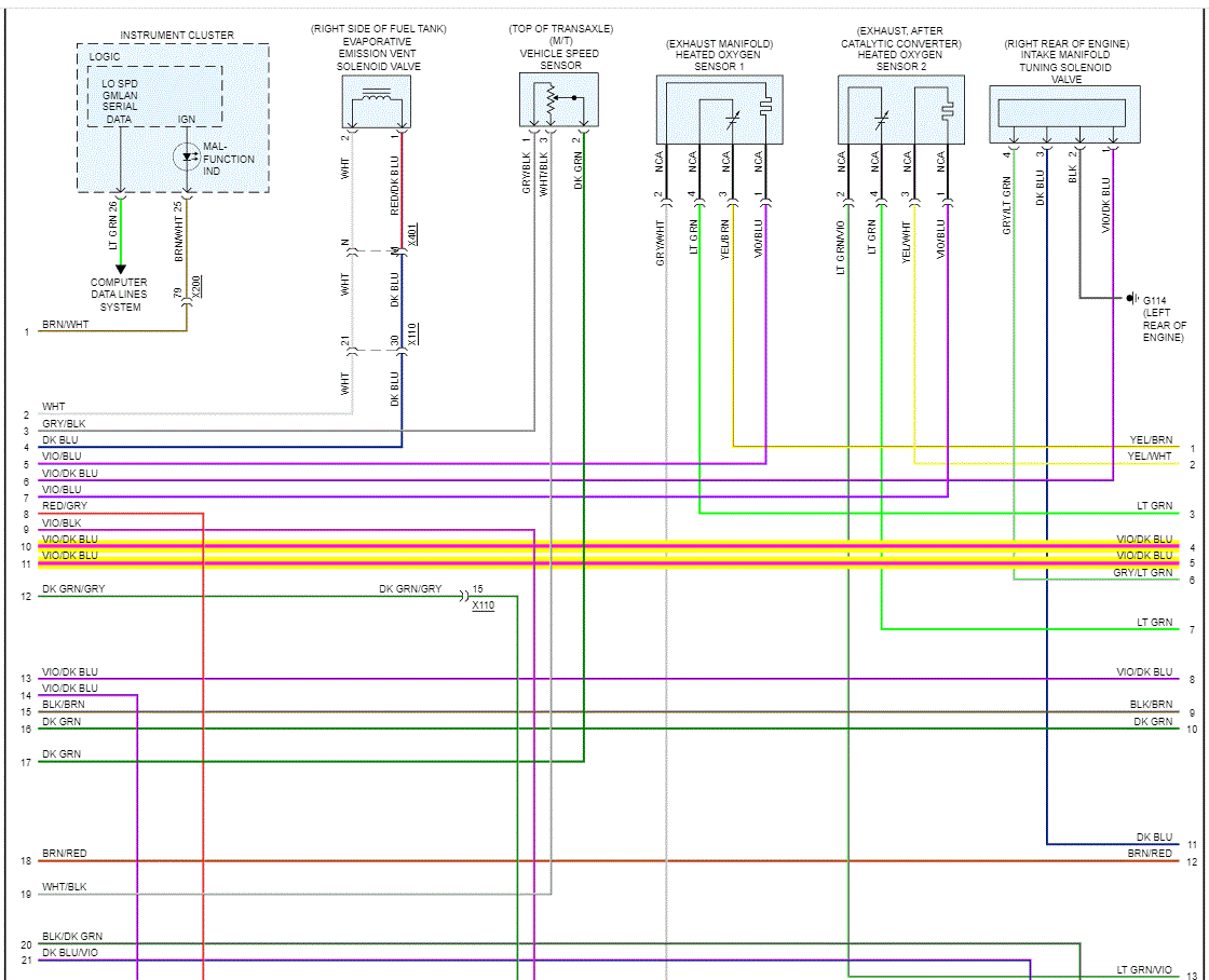

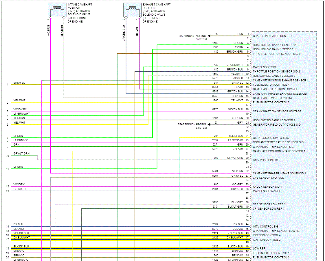

I attached the entire powertrain management schematic below. The schematics were 4 pages long, but I had to cut each one in half to make it readable for you. I did overlap them.
If you do have a live data scan tool, see if there is an RPM signal first. If there isn't, suspect a faulty crankshaft position sensor.
Take care and let me know what you find.
See pics below. Note: I highlighted the relevant wiring for the ignition coils.
