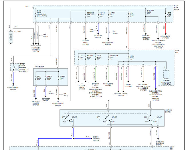

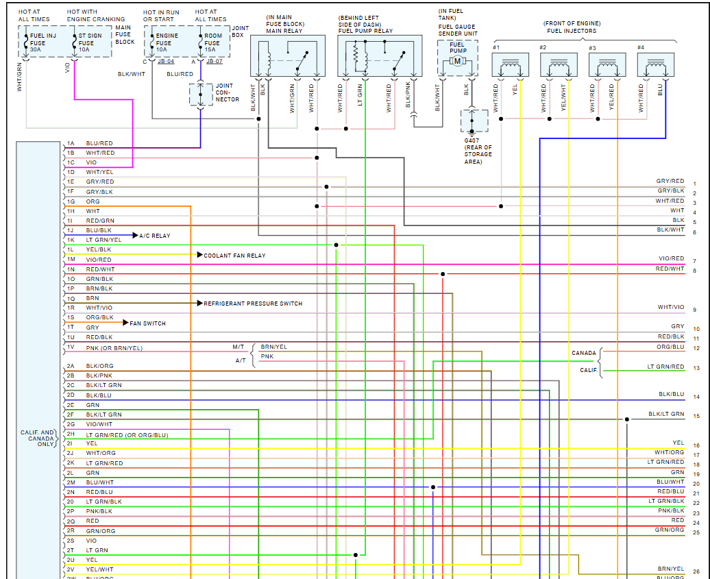

Good day ,i need assistance please. Have the vehicle listed above 1600 no spark only fuel. Replace the distributor still no spark. Any advice or wiring diagram to check if all is ok. Do you have the 6 and 3 pin diagrams on dizzy.
Nov 4, 2024 at 4:12 AM
  • 54,520 POSTS

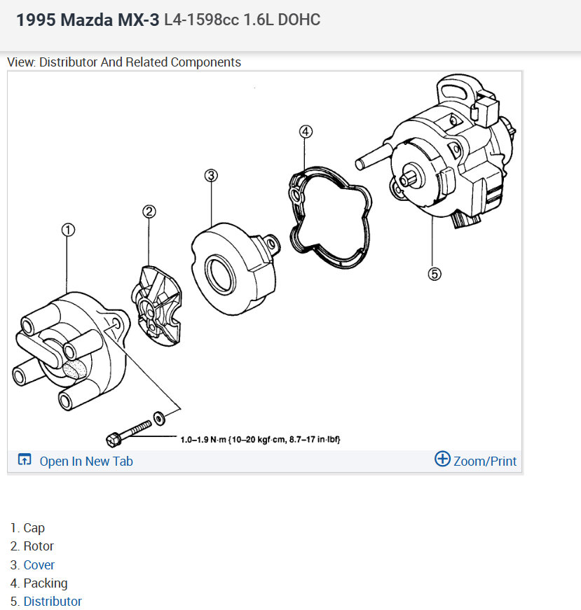

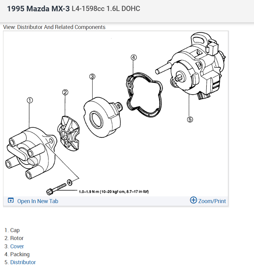

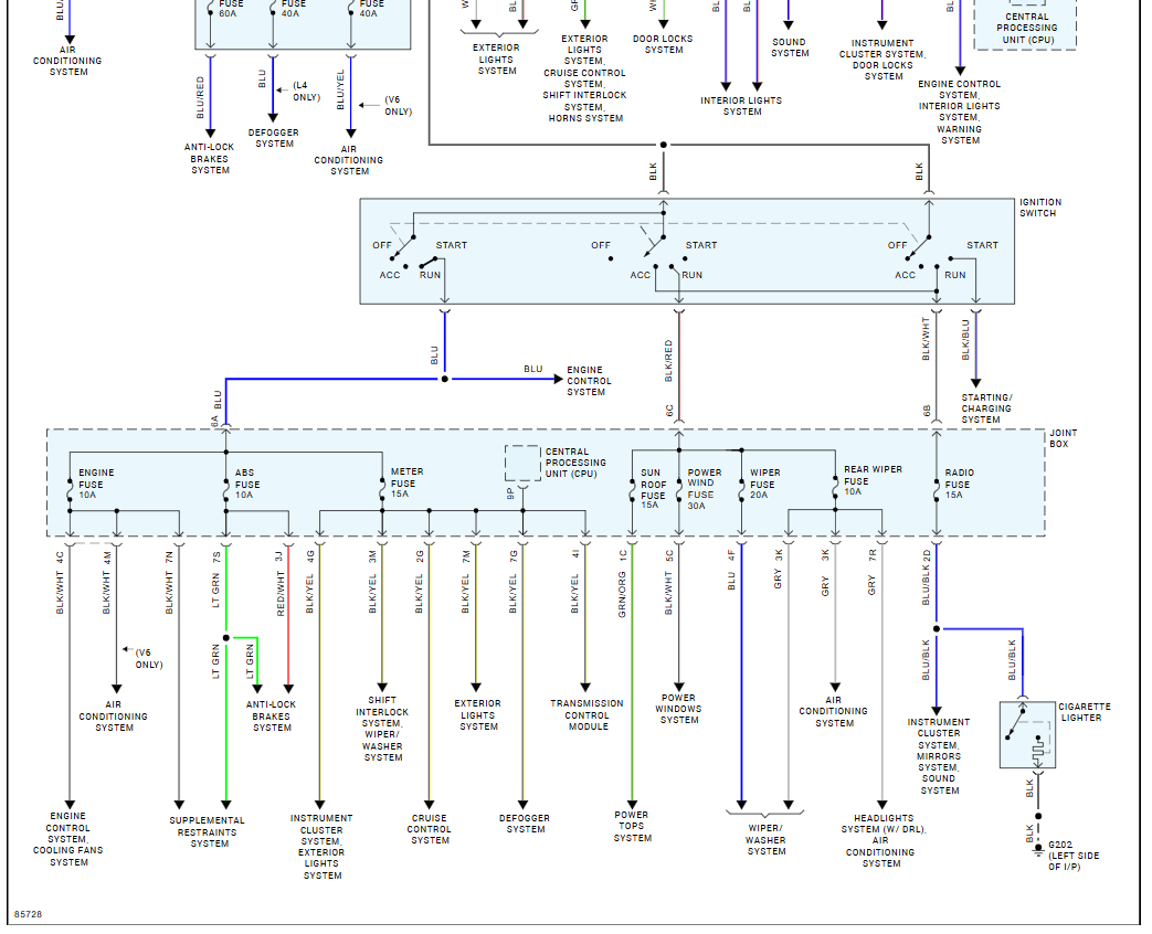

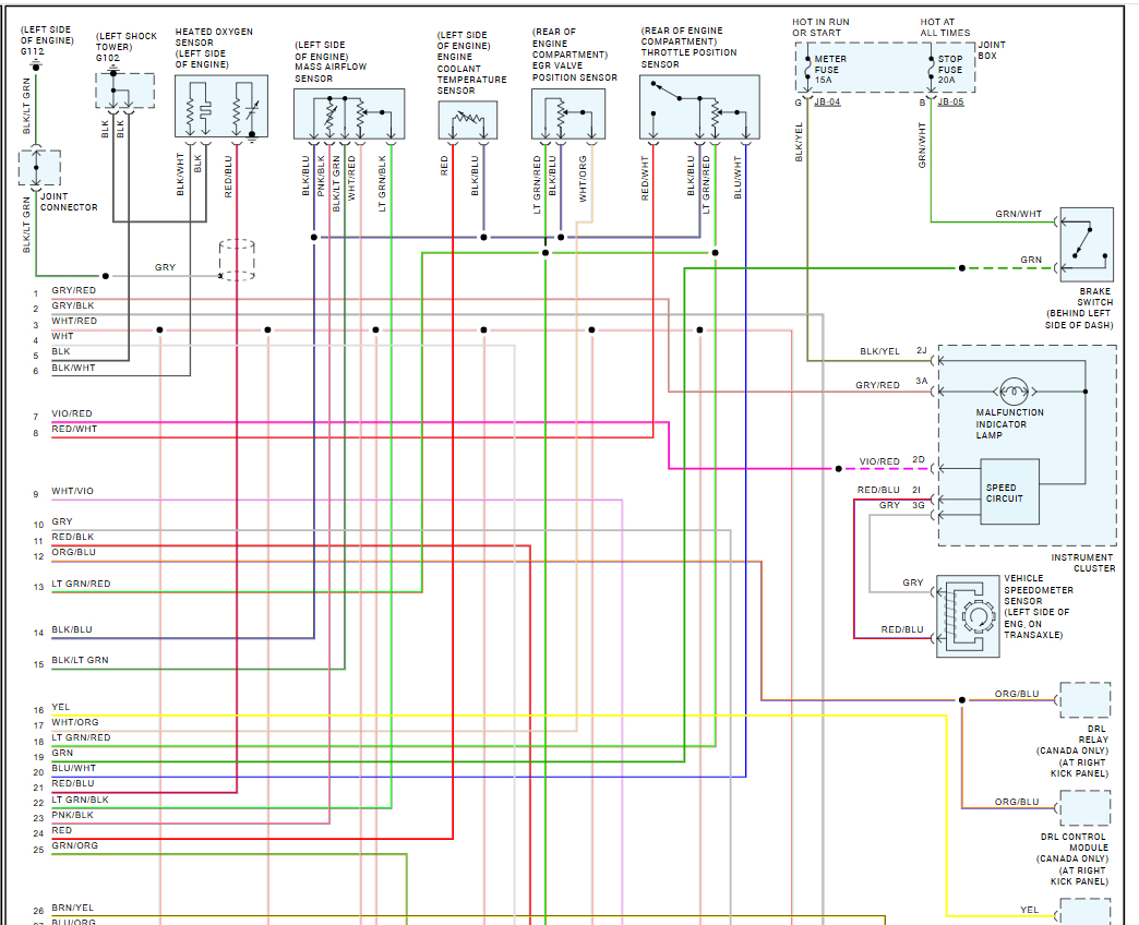

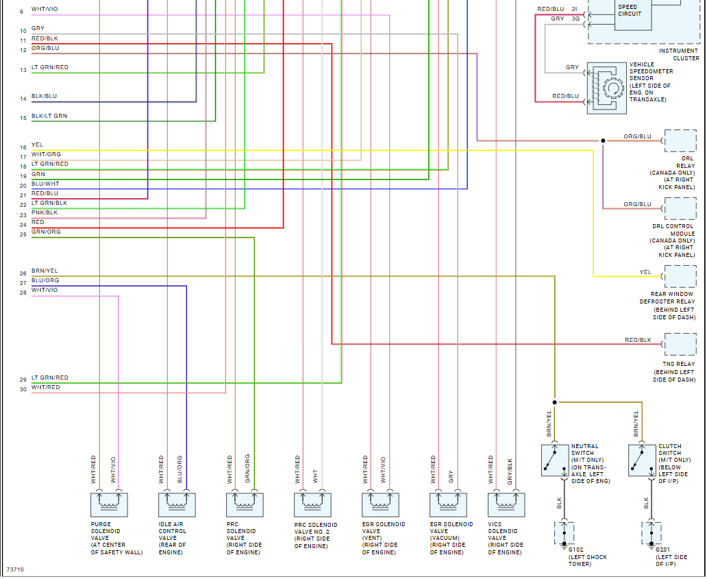

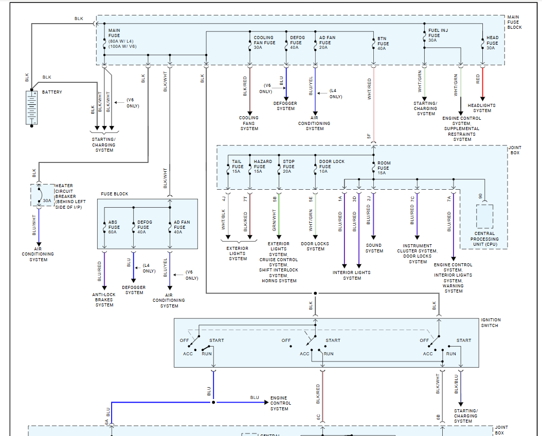

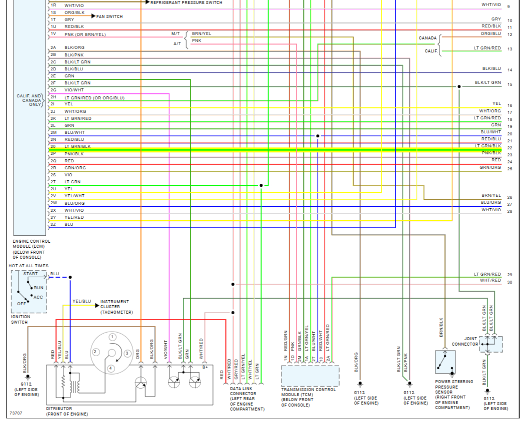

I would check the blue wire going to the distributor with the key on to see if it has power. Here are the wiring diagrams for your car so you can see how the system works and which fuses to check and the wires to check for power and ground for the ECU and distributor.

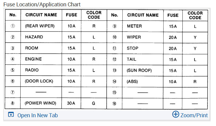

Good day, thanks for the wiring diagram. I'll check the wires today and give feedback. Do you have the layout of each fuse and relays, and what it is for. thanks.
Nov 4, 2024 at 8:58 PM
LATTANZI
  • 6 POSTS

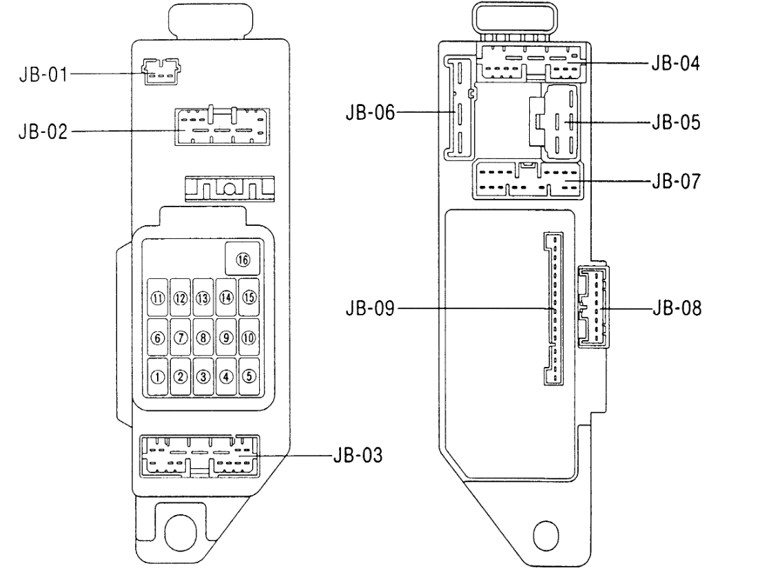

Hi,can you also send me ECU,fusebox and relay layout.Thanks.
Nov 4, 2024 at 9:53 PM
  • 54,520 POSTS

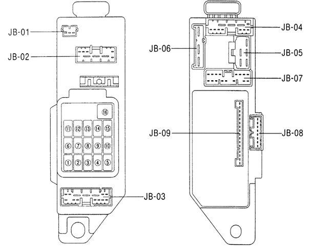

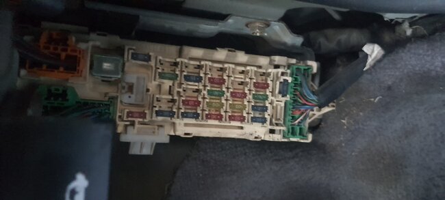

I am not sure if these will help, the info was kind of vague, but I did find the fuse layout. Check out the images (below). Let us know what you find.

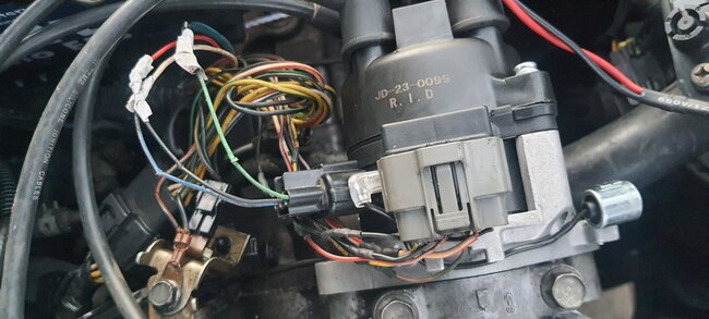

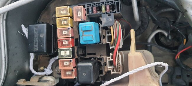

Good day, I checked the wires, and it is not the same see pictures of the car and color not the same.
Nov 6, 2024 at 9:25 AM
  • 54,520 POSTS
Yep, the colors may be different, we had to use a car that was close because we don't have direct information on this car here in the states.
Nov 6, 2024 at 9:30 AM
LATTANZI
  • 6 POSTS
Okay, here is the VIN if it helps.
Nov 6, 2024 at 9:48 AM
  • 54,520 POSTS
I don't see the VIN, I do see the wires going to the distributor though, they looks like they might have a bad connection?
