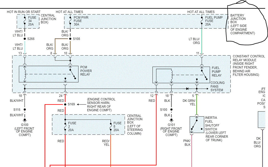

No spark. I started up the car about 3 minutes later it turn off on its own, but when I try to start it back up it would not start at all and still not staring. I changed the crank sensor still nothing just would crank but no start. But the fuel pump always come on when trying to start.

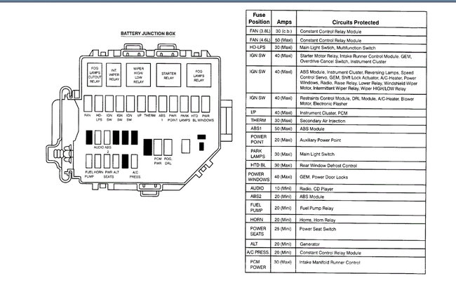

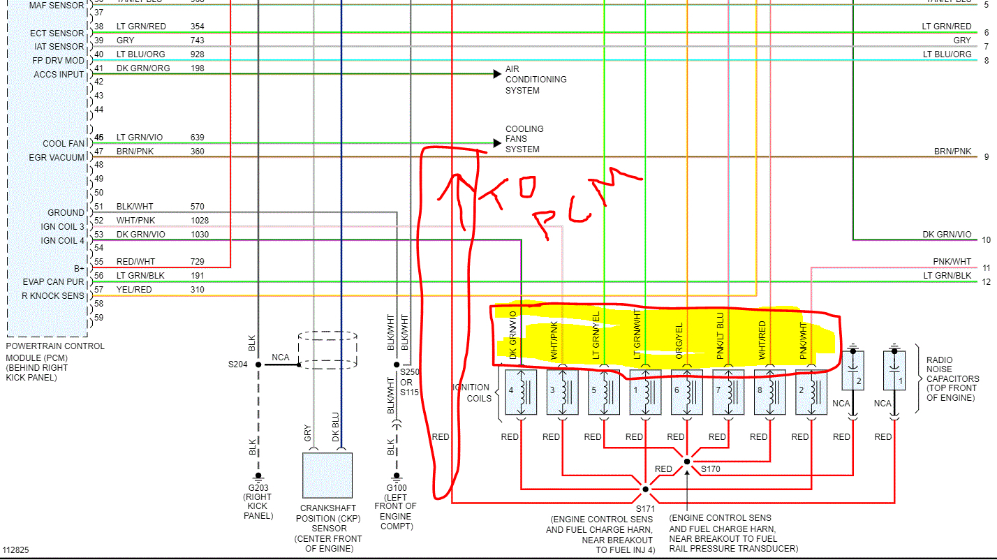

Are you certain there is no spark? Have you scanned the computer to see if there are diagnostic trouble codes? I ask about the spark because if you already replaced the crankshaft position sensor, either there is a wiring issue or something with the PCM.
The PCM uses the crankshaft position signal to calculate a spark target and then fires the coil pack.

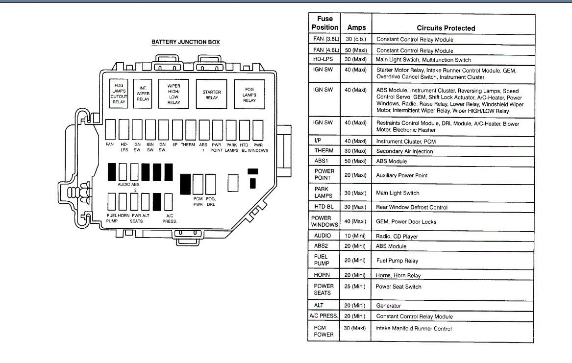

Interestingly, the coils always have power to them. The PCM provides a ground path to initiate spark. If you look at the pic below, check the PCM fuse and relay. Let me know what you find. Also, check to make sure there is power to the red wires at each coil.

All of coil as power on the red wire I turn the key to check the power for the coil and the thief light keep on blinking and the gauge was just (††††). What's with that? What fuse in the inside for the PCM?
Sunday, June 21st, 2020 AT 4:20 AM
  • 110,194 POSTS
I think you are referring to the 30 amp fuse listed in the pic above.

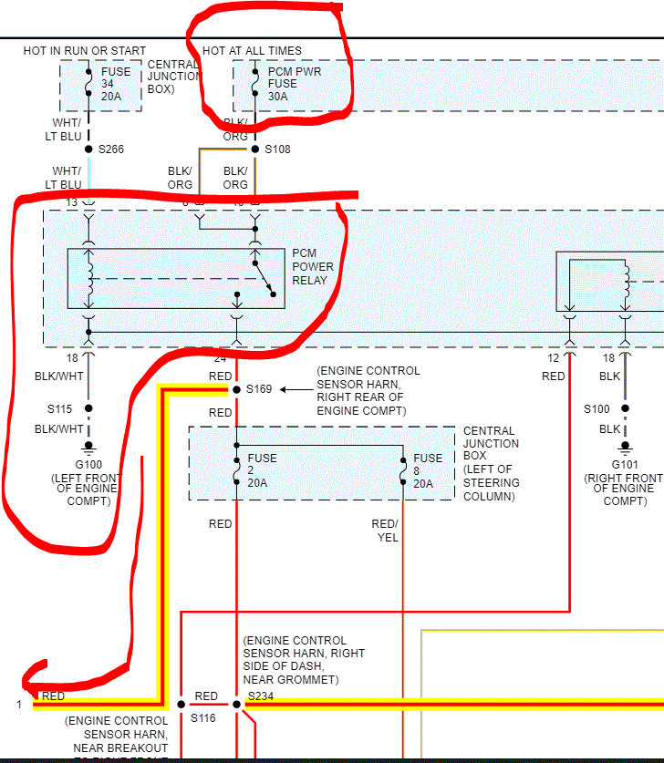

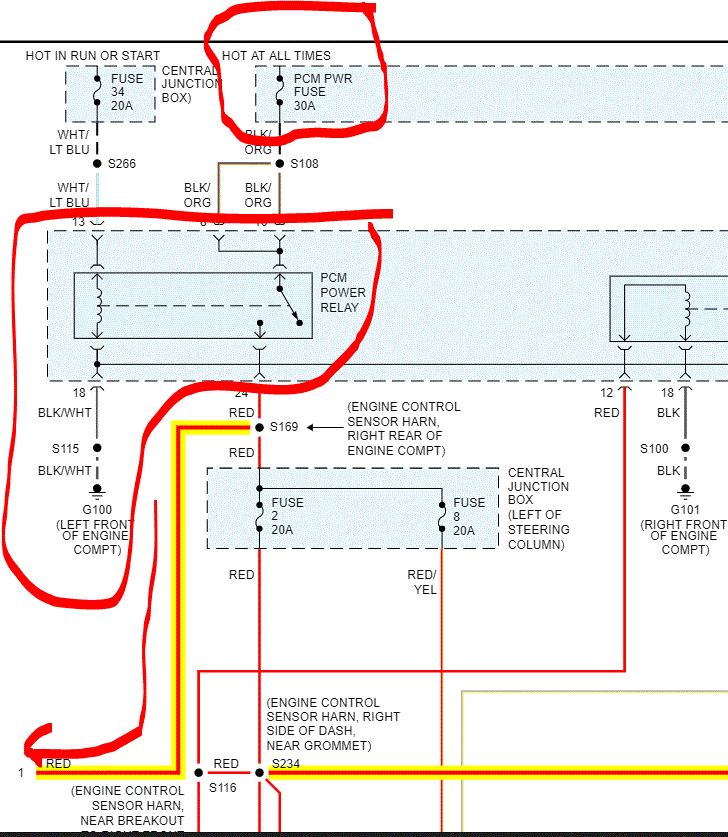

Troy, you have power from the PCM if the red coil wires have power. If you look at the attached pic (sorry for the 1st grade hand writing) I circled the red wire that goes to the PCM. That is the supply for the coils.

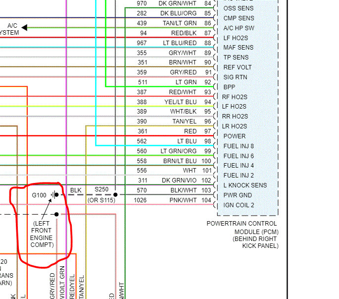

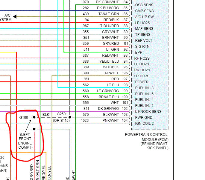

However, if we have power, we need a ground to fire the coils. In the pic I highlighted each wire that goes to the PCM for ground. That ground path only opens when the PCM knows it's time for a coil to fire. You need to check if there is continuity to ground at those wires when the engine is being cranked. If there isn't, go back to the PCM and inspect to make sure everything is tight and not damaged.
If everything is good you need to check right at the PCM to see if there is a ground path when cranking the engine. If there isn't, the PCM has failed or has lost ground. See pic 2 for ground location. Also, note there is a splice in that ground, so when checking for continuity, take into consideration the splice may have failed.
Now, do not disconnect or re-connect the PCM with the battery connected. Always disconnect the battery before doing either.

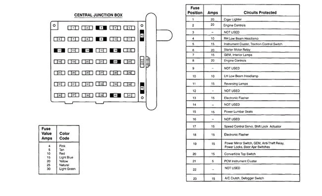

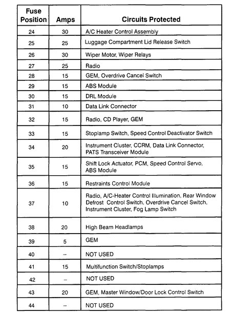

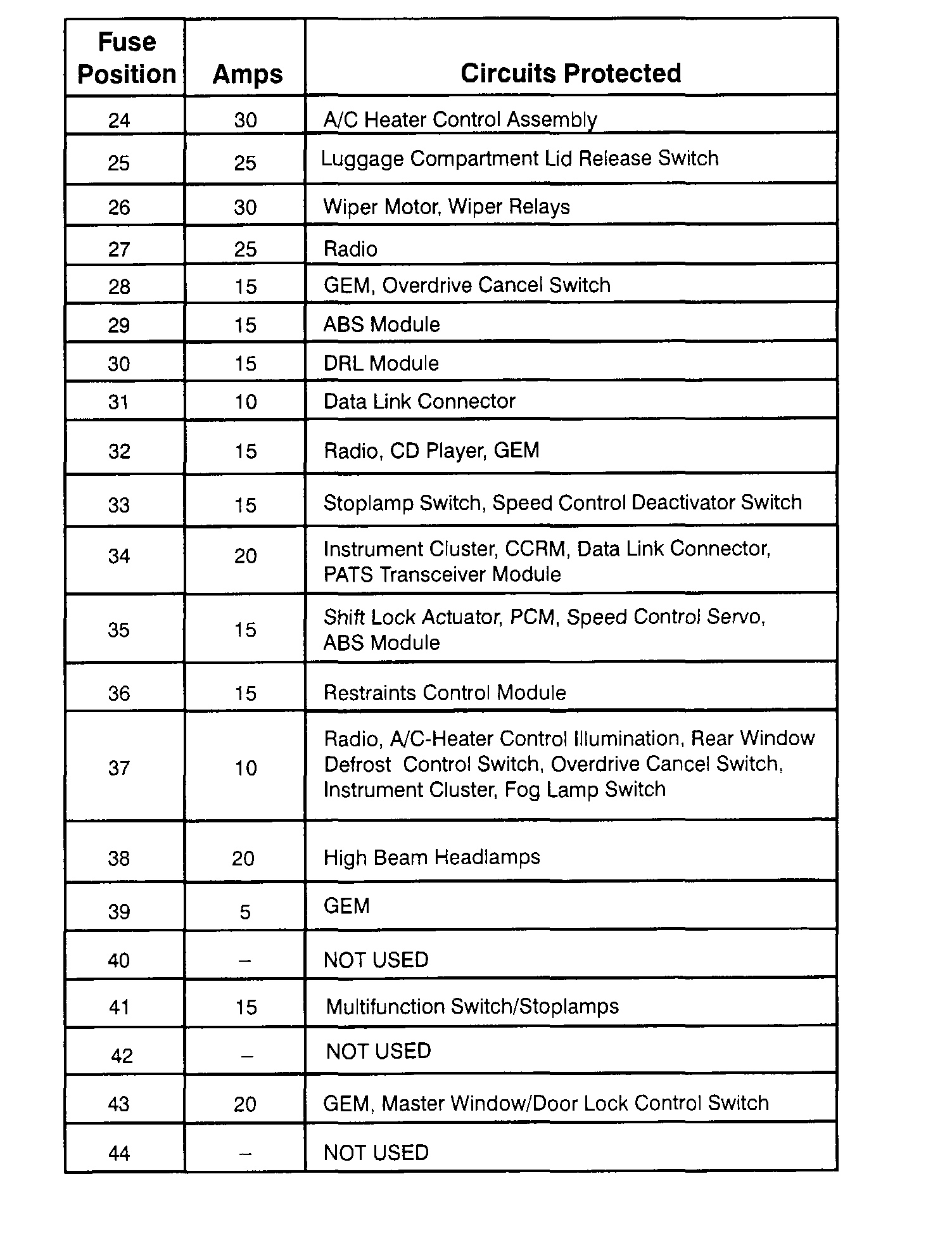

Could you take a picture of 1999 Cobra fuse box name and location? I was testing the fuse and some has no power at all I am hopping to see what are they for am getting some offline but not matching up. Thanks
Wednesday, June 24th, 2020 AT 11:24 PM
  • 110,194 POSTS
This is everything I have as far as the battery junction box and the central junction box. The last pic below shows where the first pic I sent you is located.
Let me know if this helps.

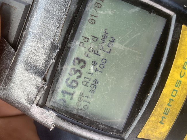

You think this code could stop it from starting: p-1633?
Wednesday, July 8th, 2020 AT 8:47 AM
  • 110,194 POSTS
The keep alive can be set if the battery was disconnected or if voltage fell below 10.4v. There is a chance the PCM is bad, but that is not the usual cause. If the PCM is bad, then yes it can cause a no start.

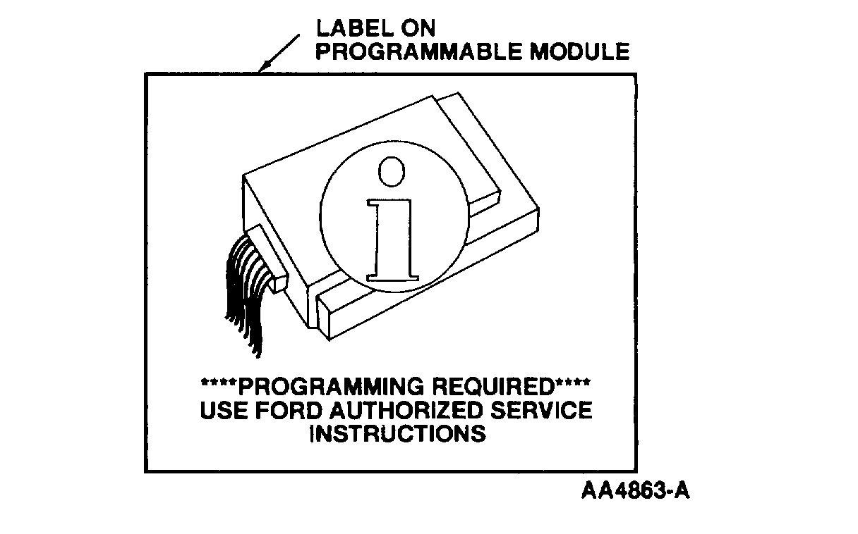

If you use the key to unlick the door, it should turn the immobilizer off. Have you tried to scan the CAN BUS system to see if there are any codes related to the immobilizer? For example, a P1260.
Also, did he retrieve the vehicle identification info prior to removing the old PCM?
Here are the directions when replacing / reprogramming one. Let me know if this is what he did.

Programming a Replacement PCM
A replacement PCM will display a label as shown. This indicates the need to retrieve VID data from the original PCM before removing from the vehicle. Refer to the flash VID block update procedure. After retrieving the VID data from the original PCM, install the new PCM. Select "Restore PCM config. (1)" to download the stored data. If the original PCM is nonfunctional, it becomes necessary to manually reprogram the VID block. The scan tool is used to perform this procedure and is done through the "PCM Programming" selection as described by the flash EEPROM procedure below. Follow screen instructions.
