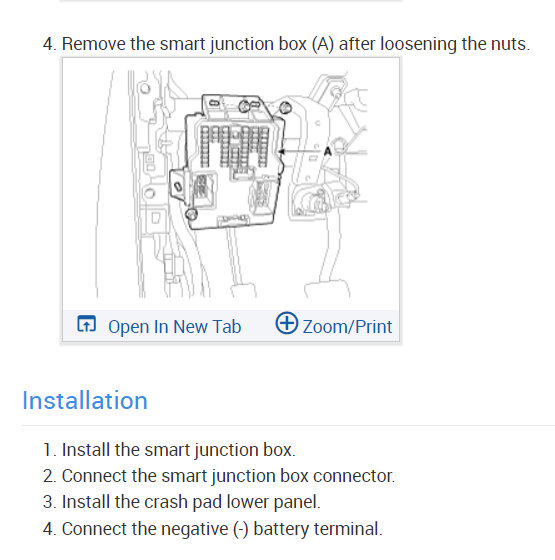

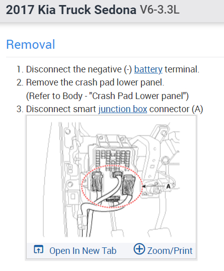

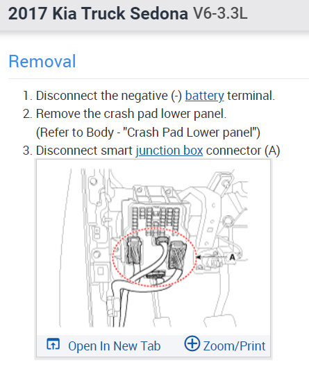

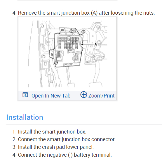

Hello, thank you so much for getting back to me. The radio does work, and all the speakers are good too. But the seatbelt chime doesn't work either with the turn signal and hazard sounds. But other than these sounds everything else works perfectly.
Jan 2, 2024 at 12:24 PM
  • CAR REPAIR CONTRIBUTOR
  • 54,415 POSTS
Yep, that warning goes through the IPS as well. Here is how to change the smart junction box which has the IPS inside of it. I would search ebay for a used unit. Here is how the repair is done. Check out the images (below). Please let us know what happens.
