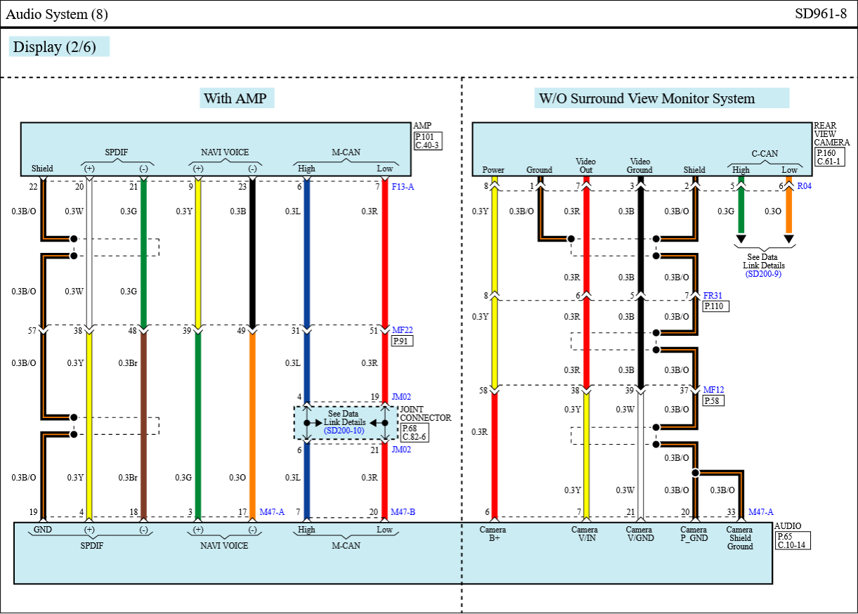

My radio turns to backup camera with +12V wire when you put the car in reverse and the radio generates +6V to be send to power the camera. I've installed the radio from 2017 model year and it does not seems to have the pin for back up +12V, moreover, +6V is constantly being sent to power the camera regardless of the gear selected. The new 2017 radio has some CAN connections which i did, but still when I shift to reverse, radio does not go in to backup camera mode.
What do i need to do to make the camera work on new radio?

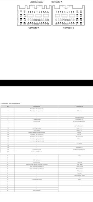

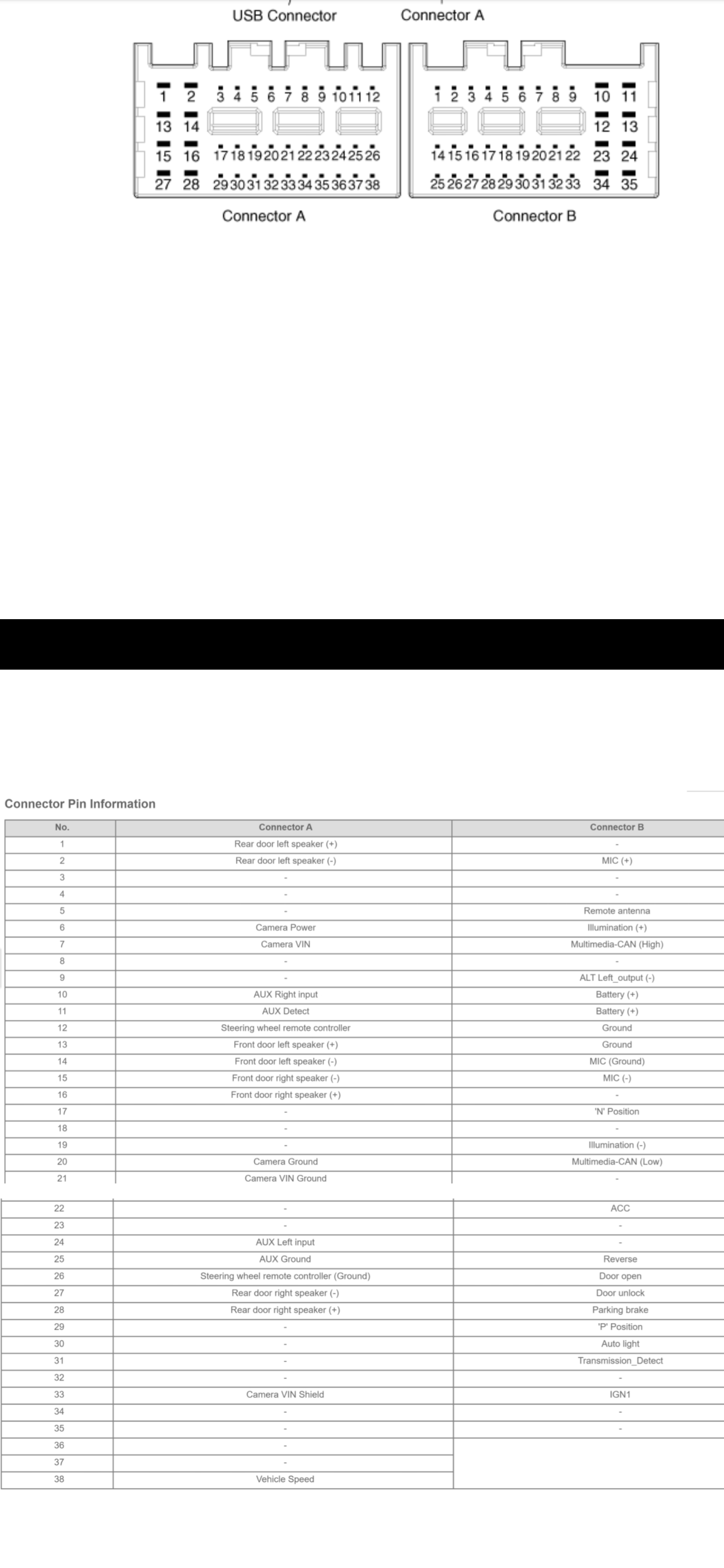

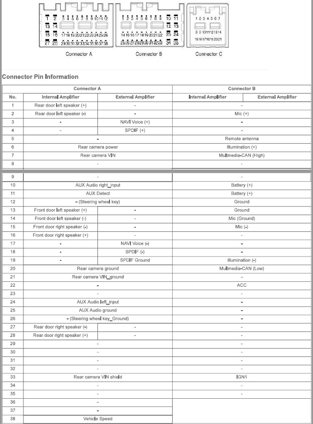

Pin outs for 2017 radio attached.
Aug 12, 2019 at 11:42 PM
94 TRANSAM
  • 680 POSTS
The pin out is great for wiring it in, the problem is the pin out tells me nothing about the internal workings of the radio. For instance, one possibility could be that they added another leg to the reverse switch on a 2017 that switched the ground for the camera so when it is in reverse the ground is completed but the hot is constant where it was switch on your model year. That is just one possibility of many. My example would be the simplest but engineers don't do simple. I could continue to speculate but trying one wrong guess could cook your camera circuit.

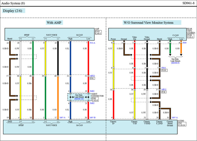

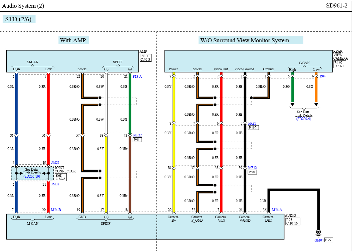

Here are the camera circuit diagrams for 2016 and 2017. As you can see they are very different circuitry. The 2017 diagram doesn't even show a reverse signal input or output.
Rich
Aug 13, 2019 at 12:09 PM
FLEGMONA

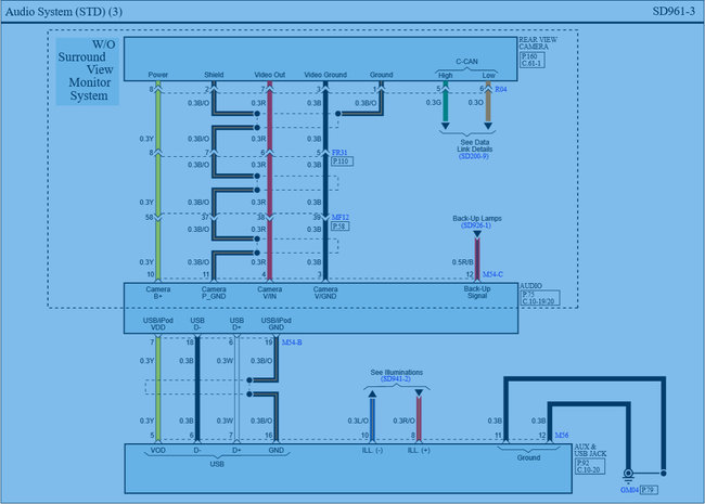

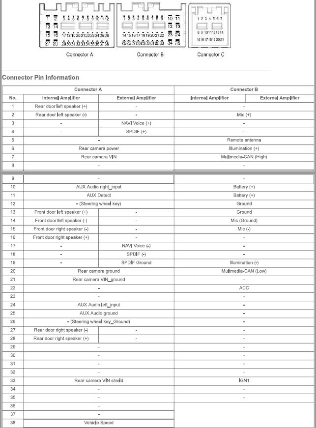

Hello Rich, I'm surprised you have access to GDS, especially to 2017 model. I do have exactly these diagrams, and that is exactly what i was trying to say that there is no reverse signal input in the radio to trigger the camera mode. The only thing with your diagrams is that 2017 model should have 3 different diagrams since there are 3 different models of radios available with different pinouts, and the third one even with different connectors. My radio is type 2, and your diagram is for type 1 radio. Interestingly enough, the diagram that i have is also for type 1 radio. Would you please be able to post here the type 2 radio diagram for 2017? I assume it should be called STD3/6 and STD4/6 in the top left corner. Thank you.
Alex
Aug 13, 2019 at 2:12 PM
94 TRANSAM
  • 680 POSTS
Hi Alex,
It took some digging but I did find this. Neither diagram says what type the radio is but this is the only other one listed and it is different. Hope it helps.
Rich
Aug 13, 2019 at 2:45 PM
