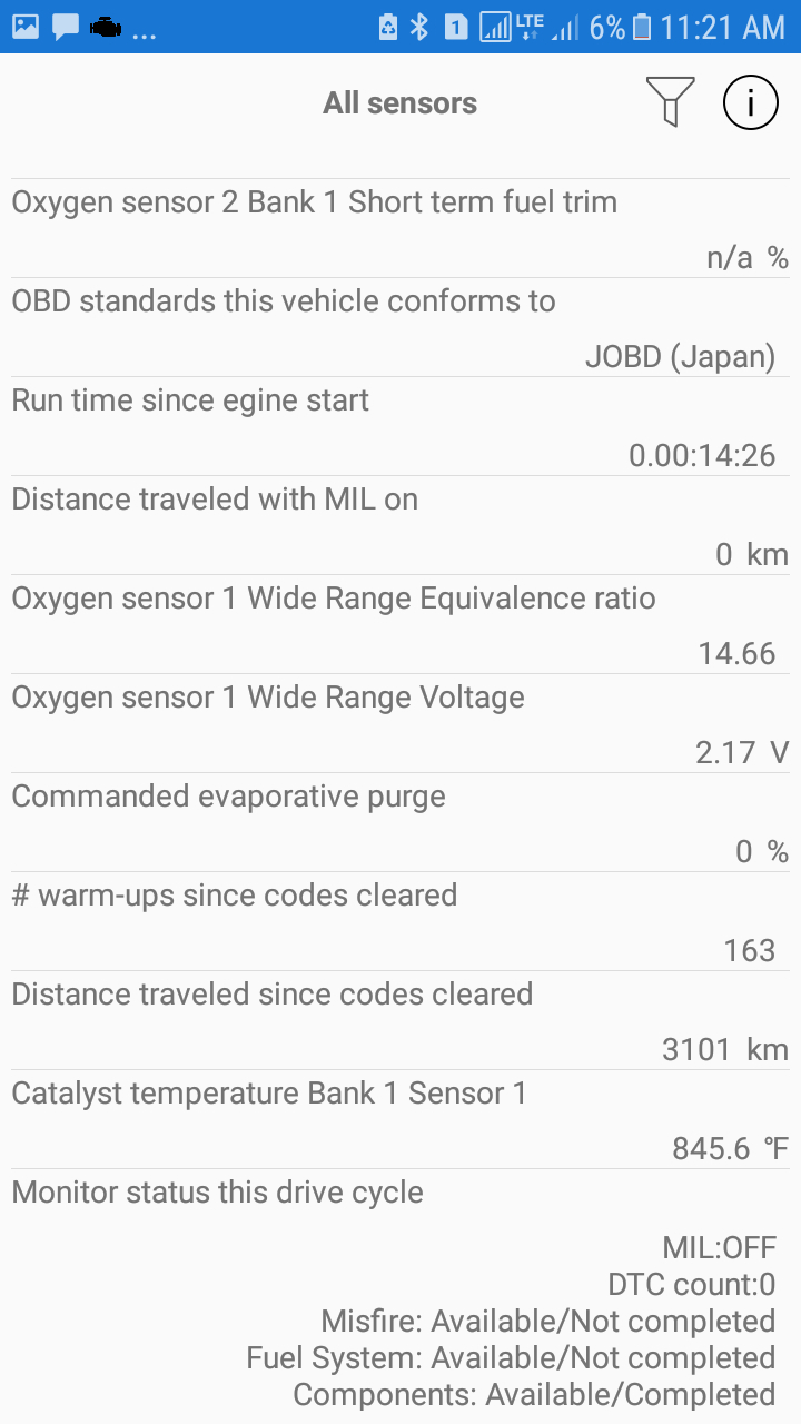

Hi experts. Good day I have a problem while driving the other evening I tried to pass a truck only to realize I don't have the pulling power to do so. This has being going on for two weeks now took it in the shop three scans no codes fault detected. Scratch our heads, but have noticed that this only happens which I had thought was after driving for long distances and returning in the nights only to find out it is because when I turn the night lights on actually my first click of switch dash and taillights if I am driving lets say with rev up to 4,000 rpm as soon as I switch on dash lights the rpm goes right down to 2,800 rpm will not go up anymore until I click off dash lights it speeds up again. If I park put it in neutral it revs out but when load applied it weakens.
I am wondering if the dash dimmer system is crossing with the fuel pump or something like that also maybe the correct fuel pump circuit is open and being fed by a lowered voltage circuit.

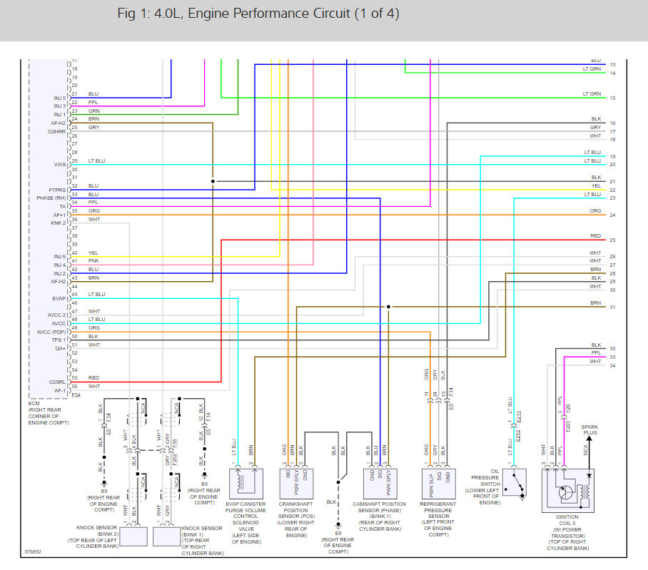

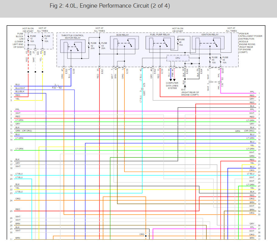

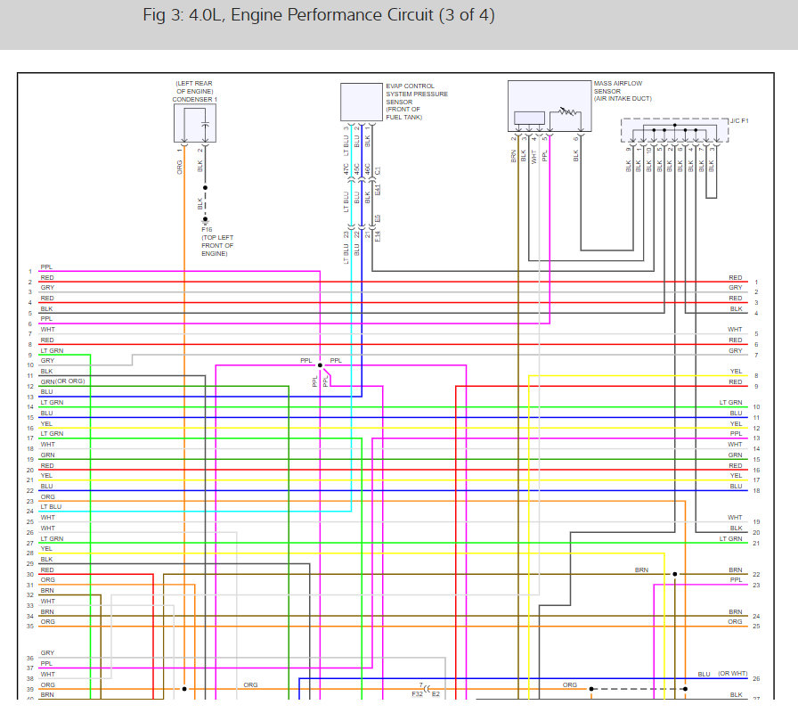

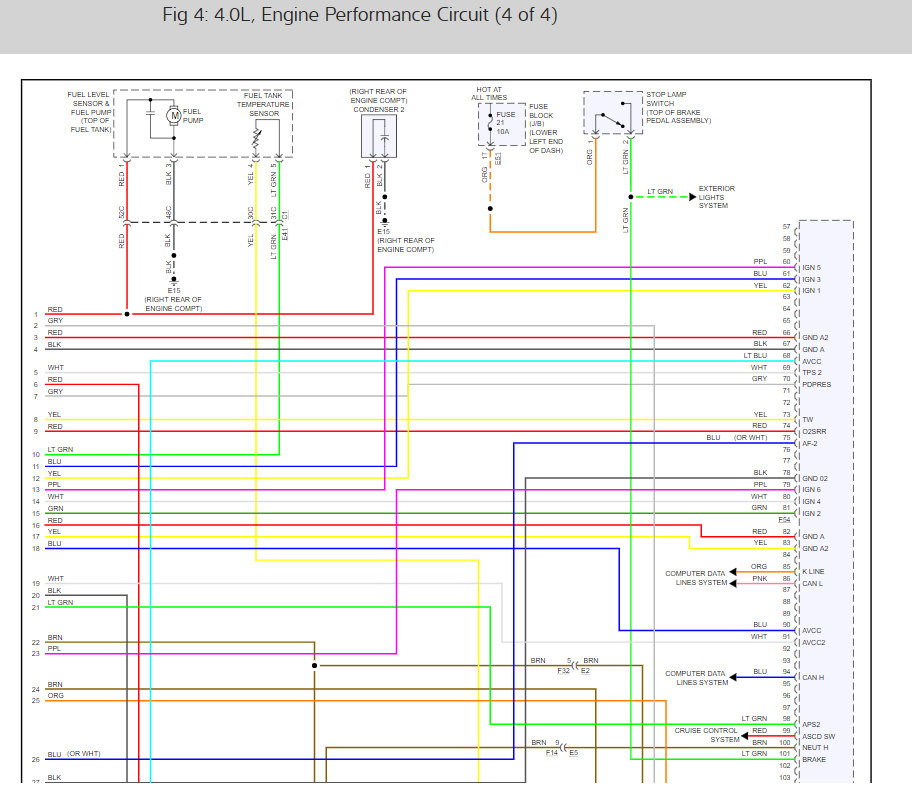

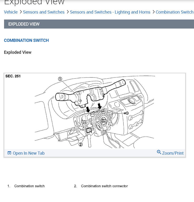

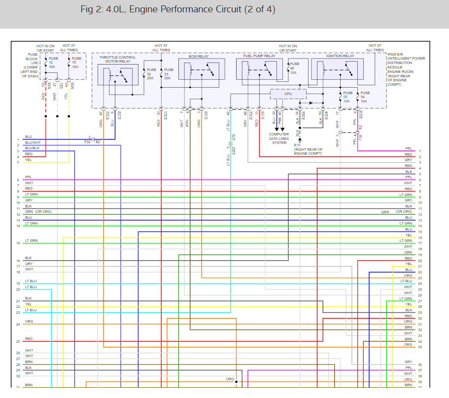

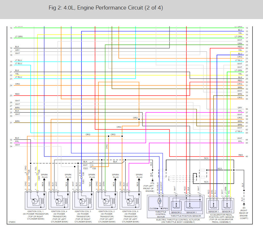

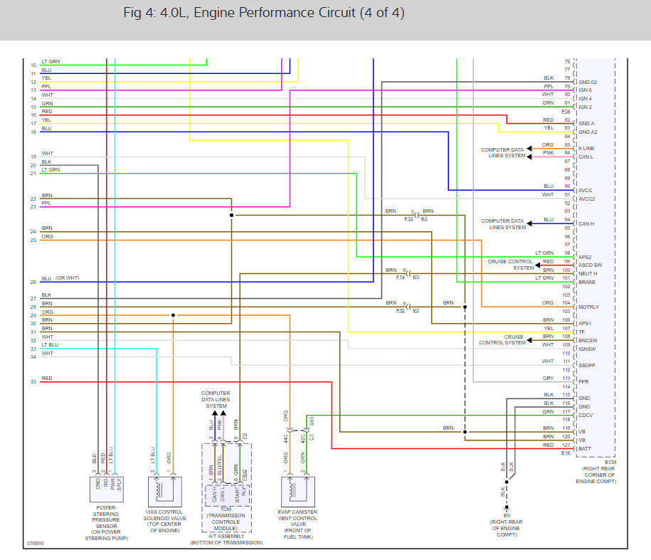

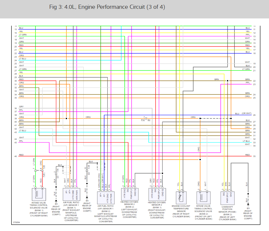

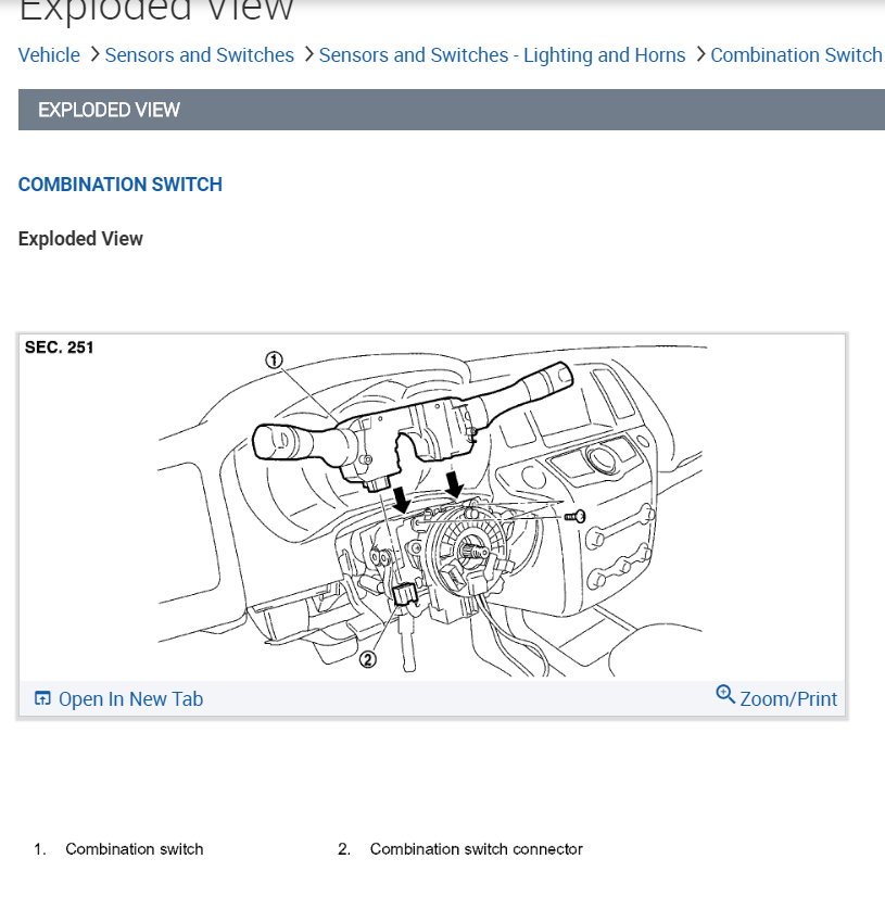

Okay, I see what you are talking about thanks for the video. It looks like the headlight switch is bad causing the issue. Here is how you replace it. Check out the diagrams (below). Please let us know what happens.
Friday, August 9th, 2019 AT 12:22 PM
RUDONOVON
  • 12 POSTS

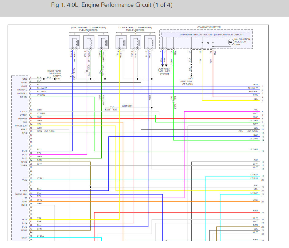

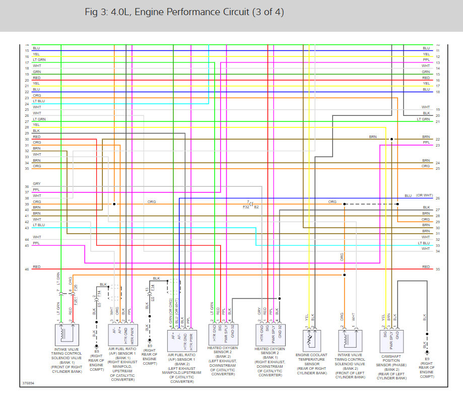

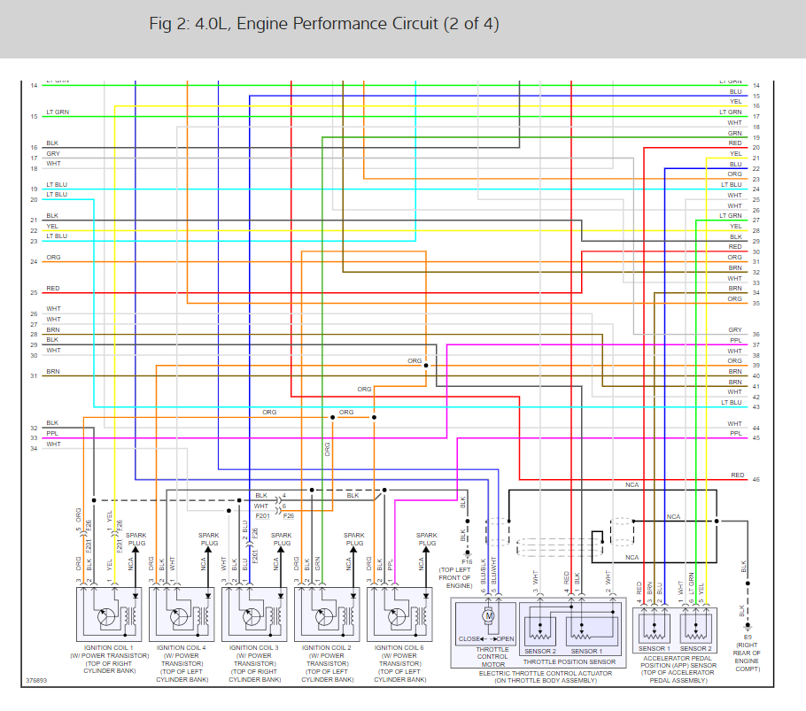

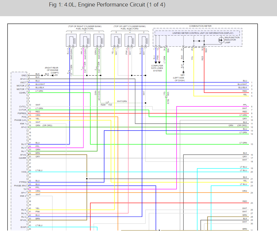

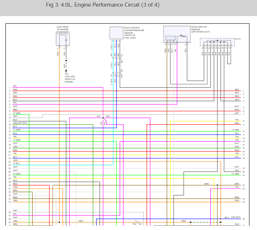

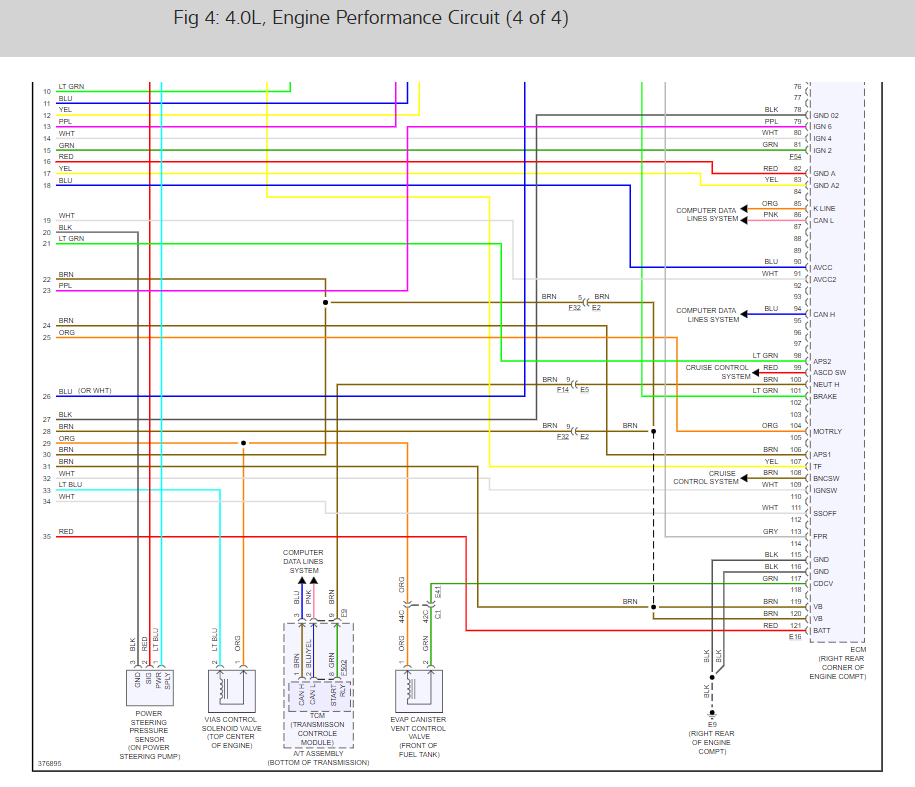

Okay, thanks. The van I have is a Japanese type right hand drive please I would like if you can send me the wiring diagram for the NV200 fuse to relay to switch to lights so I can see if the fuel pump is in line with this switch at anytime.
Sunday, August 11th, 2019 AT 2:15 AM
KEN L
  • MASTER CERTIFIED MECHANIC
  • 55,469 POSTS
Here are the wiring diagrams to help you with your testing and a guide as well:
Monday, August 12th, 2019 AT 10:53 AM

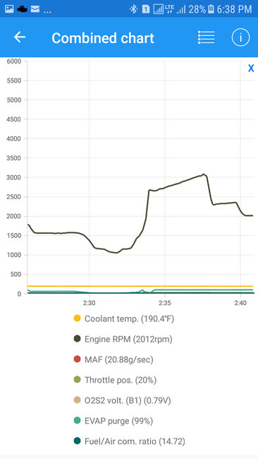

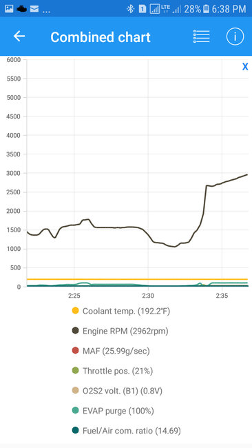

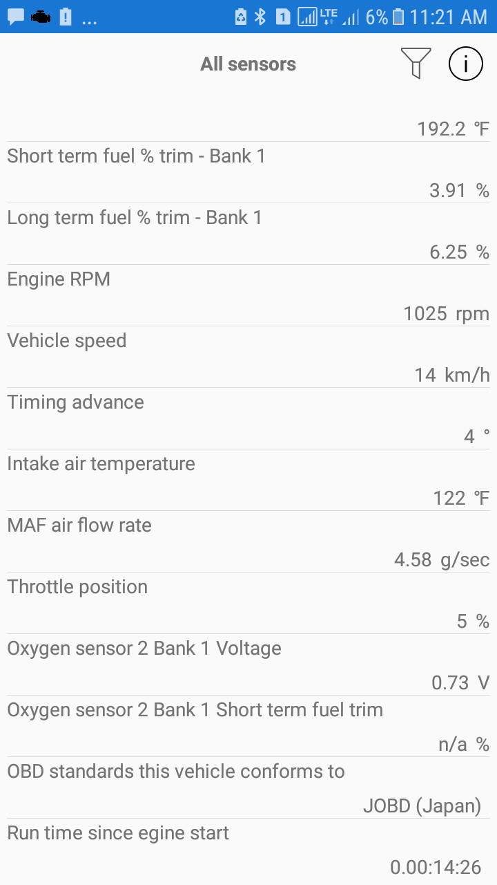

Today I did some observation I used a OBD2 scanner as I was driving. I noticed that while checking the throttle open position it was open to 57% as I switched the park light on it went down to 21%. Every time I switched on the light and does not go up until I switch it off.
Wednesday, August 14th, 2019 AT 7:03 PM
KEN L
  • 55,469 POSTS
That does not sound right at all, so at idle it is at 21%. Should be at like 3% this will be the ECU or a throttle actuator issue.
+1
Thursday, August 15th, 2019 AT 10:37 AM
RUDONOVON
  • 12 POSTS
Sorry it is at 4% idle, but when floored the max is 21% no higher when park lights turned on.

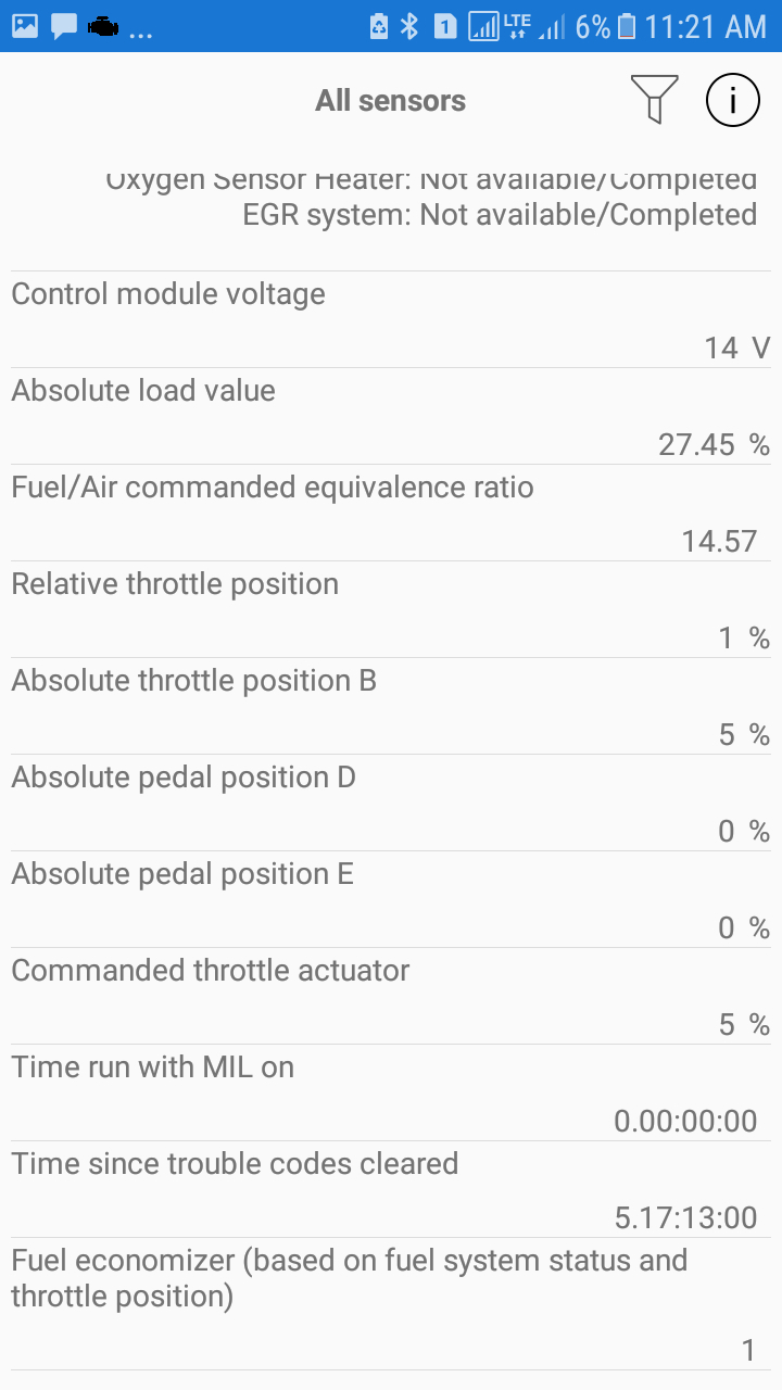

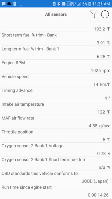

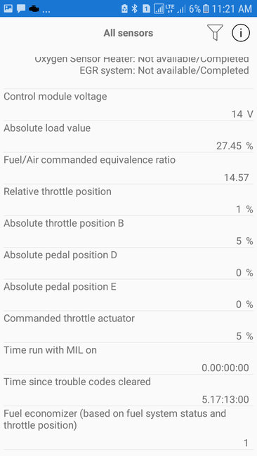

Good evening. Here are some reading from the OBD2 scanner.
Thursday, August 15th, 2019 AT 5:20 PM
RUDONOVON
  • 12 POSTS
Throttle at idle is 5% I see.
Thursday, August 15th, 2019 AT 5:22 PM
RUDONOVON
  • 12 POSTS

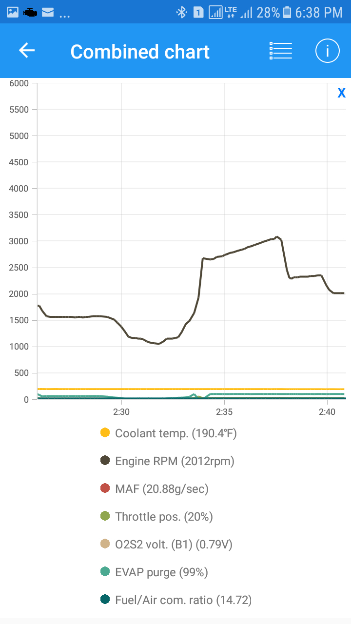

Throttle at idle is 5% I see with A/C running.
RUDONOVON
  • 12 POSTS
This is the reading second photo with pedal floored park lights on. Not opening more than 21% so rev not going pass 2990 rpm.
Thursday, August 15th, 2019 AT 5:54 PM
KEN L
  • 55,469 POSTS
The engine will not rev in neutral the computer will not allow it. Did we check the alternator for AC voltage?
Friday, August 16th, 2019 AT 9:56 AM
RUDONOVON
  • 12 POSTS
Oh, no. I didn't check the alternator for AC voltage. Will do in a bit.
