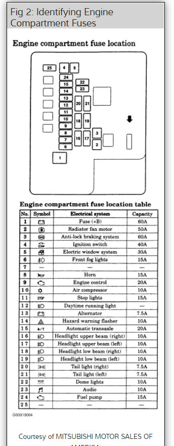

I got a 2001 Mitsubishi galant that I can't get to start. I got in the car to start it and it started for about 2 sec and then died and won't start back. the fuel pump is not kicking on so I took it out and hook it up directly and it worked so I changed filter and put back in and again it would not work. So I changed the fuel pump relay and still wouldn't work. So I took the old pump back out and hooked up a new fuel pump, and again it did not work. I checked to see if there was power to the relay and I got nothing with the key off and the key on. So my question is, what would cause there to be no power to both the fuel pump and the relay... and it does have the anti theft system equipped...
Feb 23, 2015 at 12:10 AM
WRENCHTECH
  • 20,761 POSTS

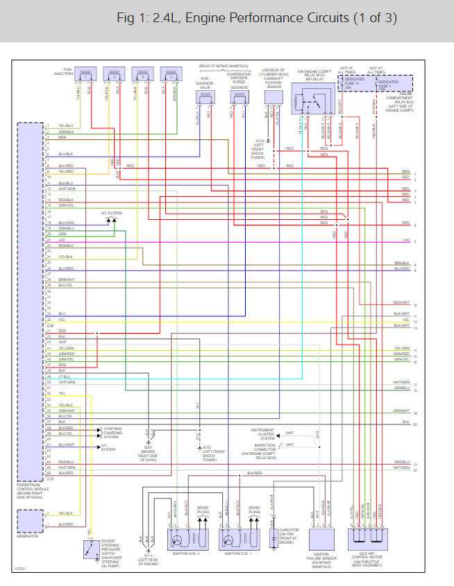

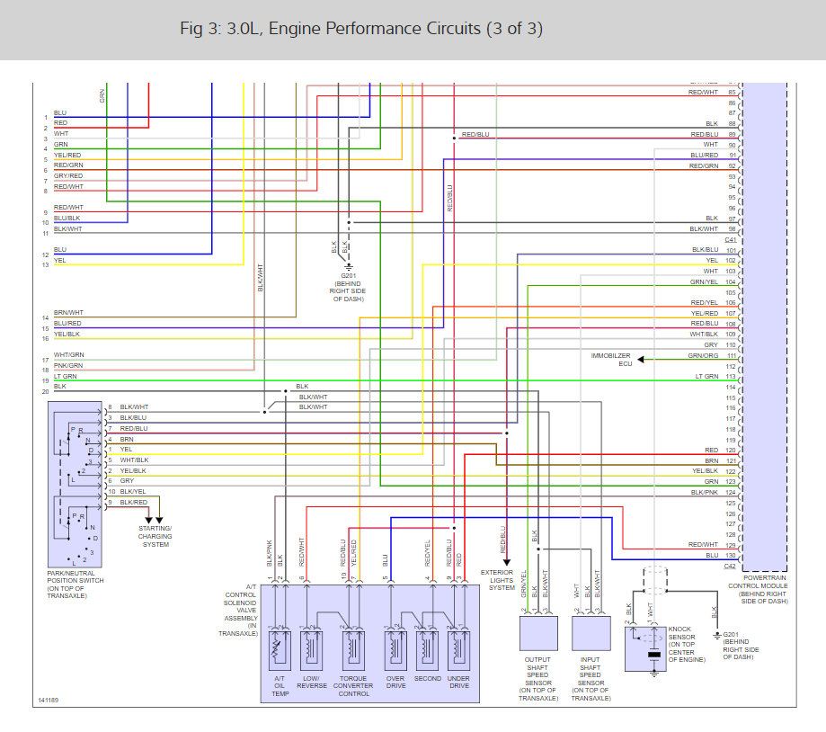

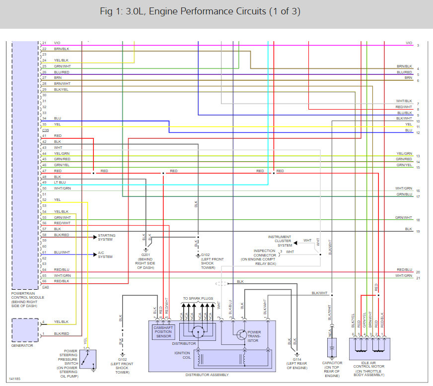

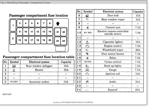

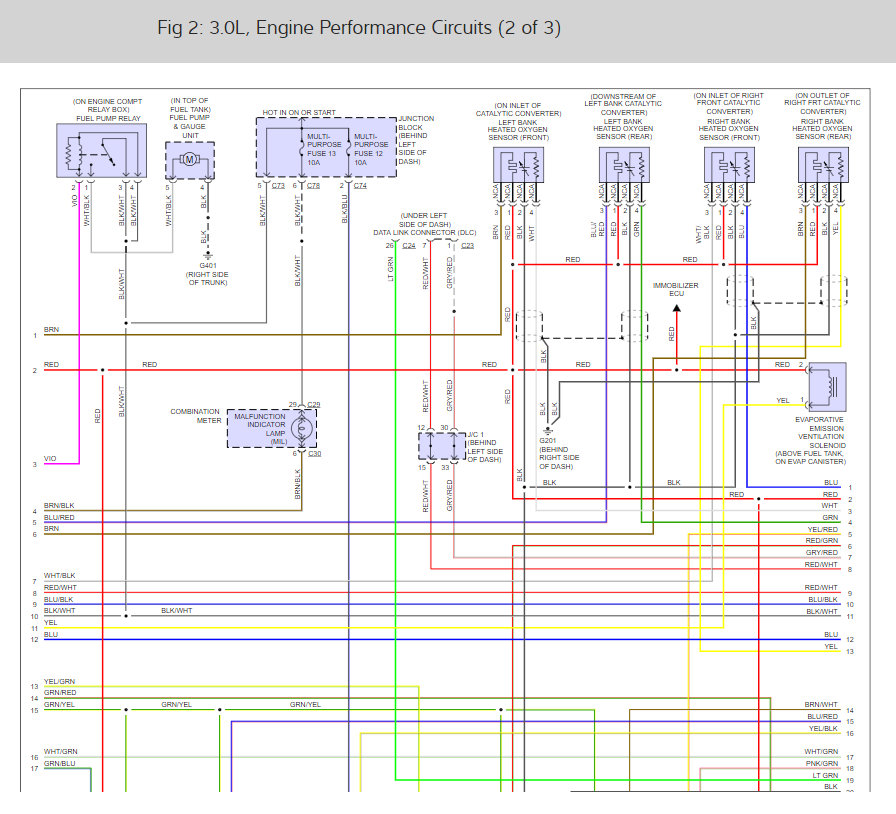

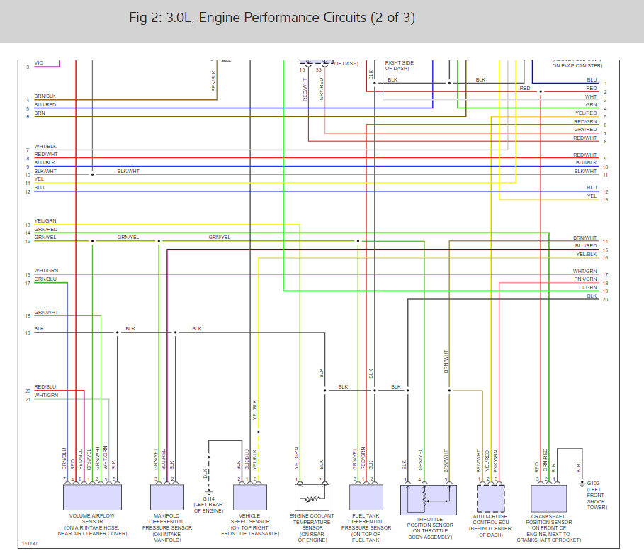

There is a fuse #13 that needs to be checked which powers the relay here is a guide to help us get started and the fuel pump and engine wiring diagrams so you can see how the system works.
Cheers
Feb 23, 2015 at 2:10 AM
SHARPFISHERMAN
Ok test light comes on at fuel pump and fuel pump relay with key on. But still fuel pump is not kicking on.
Feb 27, 2015 at 9:47 AM
WRENCHTECH
  • 20,761 POSTS
Power at the fuel pump? Are you sure about that?
It's only supposed to power for the first 2 seconds when the key is first turned on.
Feb 27, 2015 at 1:26 PM
SHARPFISHERMAN
No am not really for sure cause I didn't know where to really touch the test light at thE fuel pum. So I touch it in the wire harness and the fuel pump and the test light come on in like 2 or 4 wires back there with the key on. But not for sure if that was right
Feb 27, 2015 at 5:39 PM
WRENCHTECH
  • 20,761 POSTS
If you're having trouble working a test light, then we don't have much chance of solving this. It looks like both the power wire and the ground wire are black. https://www.2carpros.com/images/external/87613534.gif
Feb 27, 2015 at 6:09 PM

It sounds like the A/T relay might not be working right. Here is the fuel engine wiring diagram so you can see how the system works. The PCM turns the relay on so it must see the engine cranking over or it wont turn the relay on. When you turn the key to the on position without cranking it do you hear the pump prime?
Here is a guide to help you test the wiring:
Here are the engine wiring diagrams.

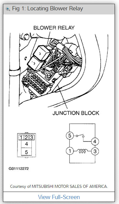

NGA_WILDONE
Location of fuel pump relay please
Sep 11, 2020 at 1:11 PM (Merged)
  • 75,992 POSTS
https://images.2carpros.com/forum/automotive_pictures/12900_fp_relay_11.jpg

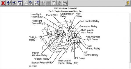

LAMSHA
  • 8 POSTS

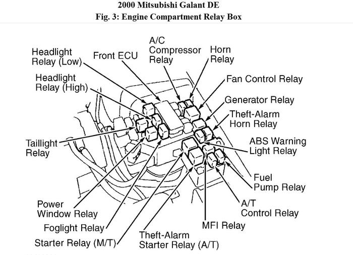

I have a 2000 Mitsubishi galant 6cyl im trying to replace a fuel pump relay and im trying to identify which it is because i see more than one of those
We know where the fuse box is for the fuel pump relay just trying to find which one is it because the plugins look alike

KHLOW2008
  • 41,814 POSTS
Refer to diagram.

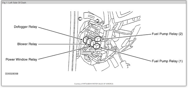

where would I find the fuel pump realy on a 94 Galant
Sep 11, 2020 at 1:12 PM (Merged)
KHLOW2008
  • 41,814 POSTS
Hi icedragon727,
Should be under the radio behind the centre console.

TOMMYWAYNE
I cranked the car up. Drove it from my carport out into my yard. A few minutes later I got in in, attempted to start it up...All it would do is crank over, but would not start up...I checked to see if voltage was coming so fuel pump, since I could never hear pump come on.. Found there was no voltage, so I though fuel pump relay... I purchased fuel pump relay from local shop. He let me look in his shop manual to find location for relay, but shop manual kept the location secret, it would not tell me where it was.
Came home, searched all over the internet, and still no success, still can't find the relay...
Any idea where it might be located?

CARADIODOC
  • 34,308 POSTS
A failed fuel pump is much more likely.
There is no separate fuel pump relay. It is part of the Electronic Control Module, (ECM) relay. That relay has eight terminals on it.

TOMMYWAYNE
Thx, your answer is different from all others I have asked,, Some say it is on the right side, in the glove compartment area. Others say it is on the drivers side, bolted to the center console...You say it is in the ECM module, but you did not say where the ECM module is.
Why did they make this car so different, as for as where relays are located..
I am working on this car for a neighbor, and everytime I look at that thing trying to diagnose the problem, it reminds me never to purchase a Mitsubishi for my own ride

CARADIODOC
  • 34,308 POSTS
You misinterpreted my reply. I did the same thing too when I reread it. The fuel pump relay is not in the Engine Computer, (ECM). There is an ECM relay that sends 12 volts to the Engine Computer. There is a second, totally separate relay built into that assembly, and that one is for the fuel pump. It would make sense to call it the "ECM / Fuel Pump" relay, but they don't. It's just called the "ECM" relay.
