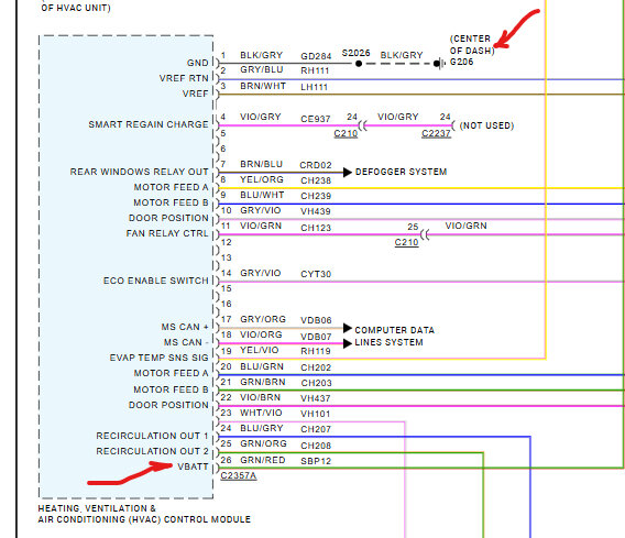

There's no power getting to the AC it won't turn on just no power. And the fuse is still good we checked

I will need more information to help you, can I ask if the AC is not cold, not blowing or is the HVAC system not lighting up or the compressor is not coming on?

The HVAC system isn't even lighting up. So there's no power on the inside. Of the cabin

Gotcha, So fuse # 12 in the fuse panel (BCM) on the left side of the dash must be good so please double check that. IF that is good I would check the HVAC controller ground which is located at the center of the dash G206, here is a guide to help you check the power and ground for the system with the wiring diagrams below to help as well, if you have power and ground the HVAC controller is bad and it need to be replaced.
