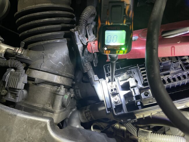

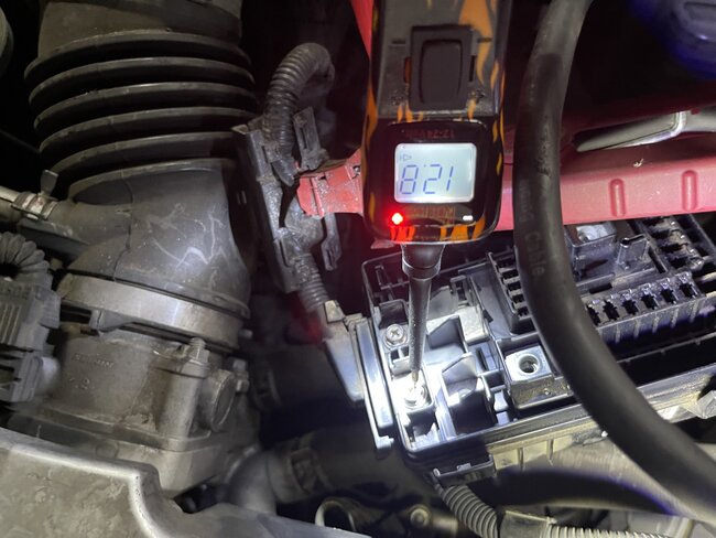

Can you connect the jumper pack with the negative disconnected without it sparking? Also, I just went through the power distribution schematics. It appears all power to the interior fuses run through the box under the hood and then into the vehicle.

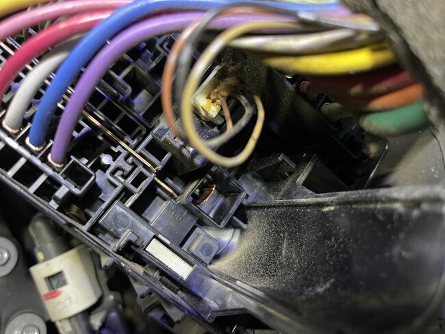

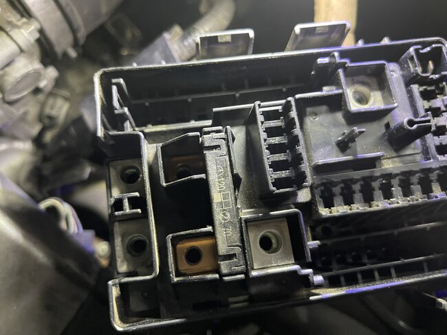

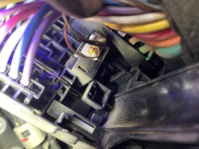

I am not seeing anything burned or weird under the box. But isn't the fuse which is snowing on bottom supposed to connect to something? Or is it just made like this to sit inside the box, weird that the end of the fuse which comes out of the box underneath connects to nothing. I am guessing the issue with the 120 fuse since it still sparks with nothing else connected and even with the battery jumper only connected to the jumper box.

Okay progress. I followed the positive cable that goes from the box to alternator, found a previous work was done on one of the coils which melted before the repair or after, disconnected the 3 front coils, no change. Kept following the sane wire to alternator, removed the positive cable which has a nut on the alternator and now it does not show ground on the 120-amp fuse. Connected all the fuses that I removed back and now it does mot spark, but no power inside other than interior lights, nothing when I turn ignition on.
Tuesday, January 17th, 2023 AT 8:25 AM
  • 110,192 POSTS
Take the alternator to a parts store and have them bench-test it. They will likely do it free of charge. It appears there is an internal short. Also, take a pic or two of the wire repair you mentioned.
Once we can get the alternator reconnected without sparking, we can tackle the other concerns with fuses inside.
