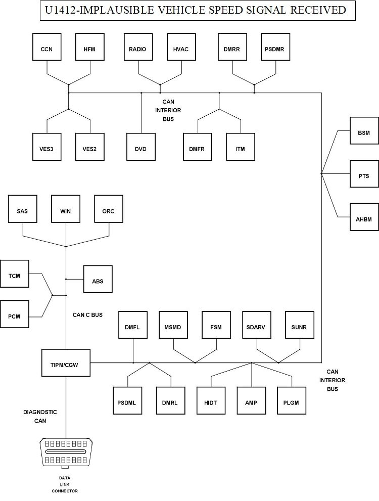

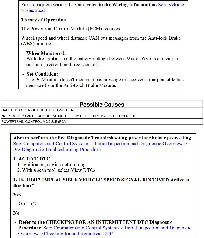

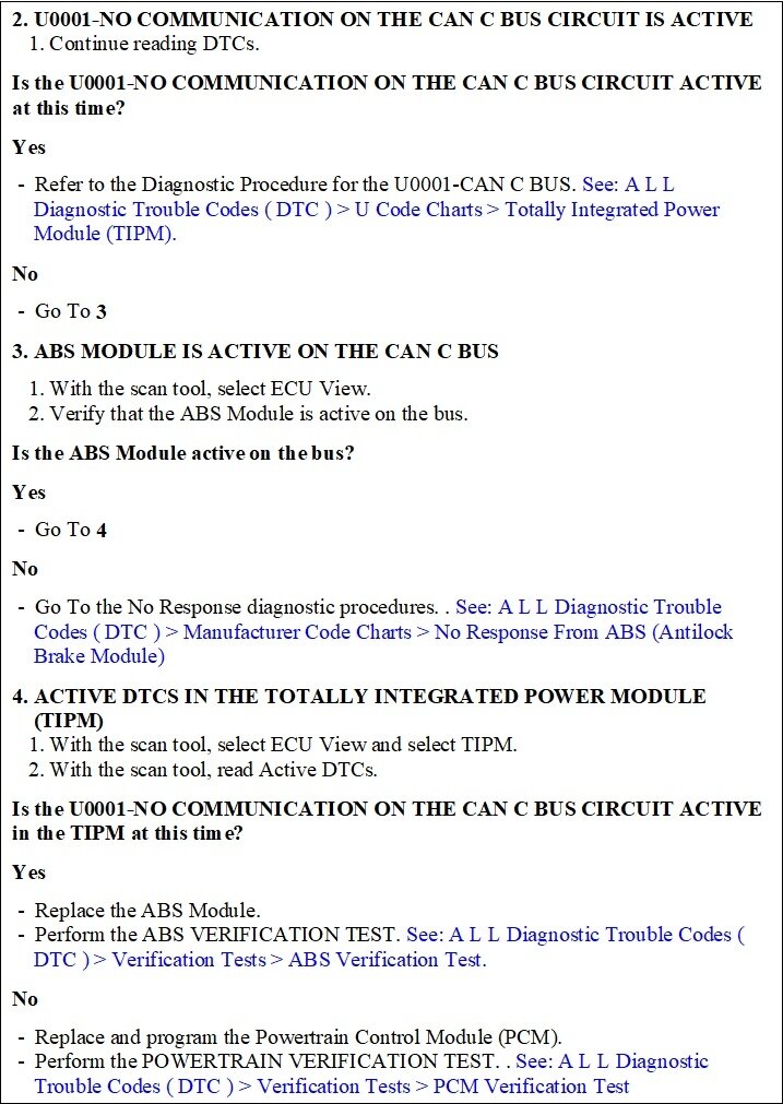

Here's the diagnostic chart for code U1412. The charts for the other two codes are very similar. On older models, a "data buss" is a pair of wires the computers talk back and forth to each other on. On models as new as yours, there can be up to four data busses. The chart on the first page simply shows all the computers that are on Buss "C". That is a relatively low speed buss as the data has little importance to instantaneous decisions, like it is with air bags.
