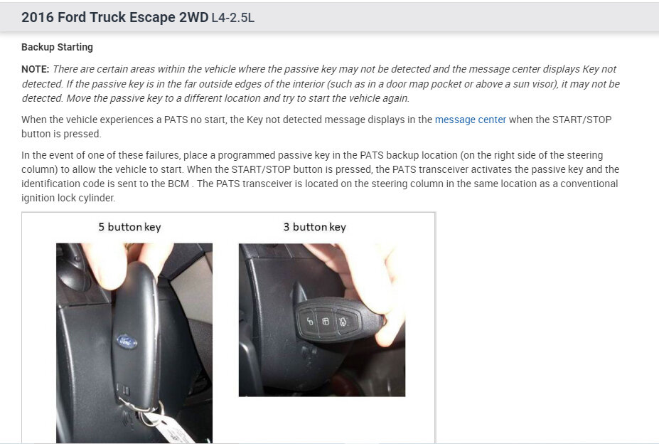

As far as the code is concerned, make sure the battery terminals are clean and tight. Also, confirm the battery is in good condition and charged.
Do me a favor. I attached information below related to a "key not detected" message. Try that and let me know what happens.
See pic below.
