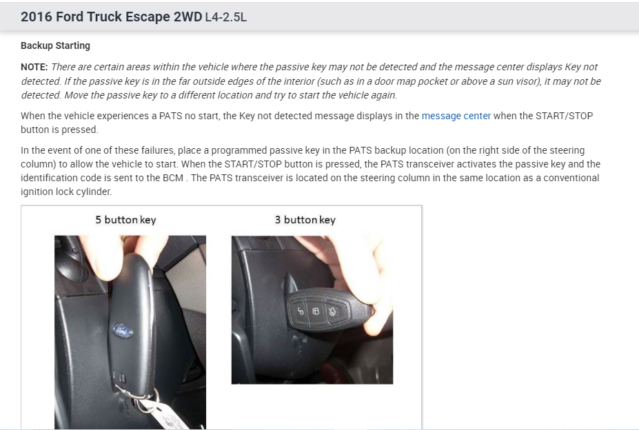

Yeah, i have a second key and it does the same thing, no key detected. Also got a code p2610 that says ECM/PCM Internal Engine Off Timer Performance.

As far as the code is concerned, make sure the battery terminals are clean and tight. Also, confirm the battery is in good condition and charged.
Do me a favor. I attached information below related to a "key not detected" message. Try that and let me know what happens.
See pic below.
