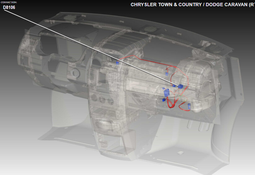

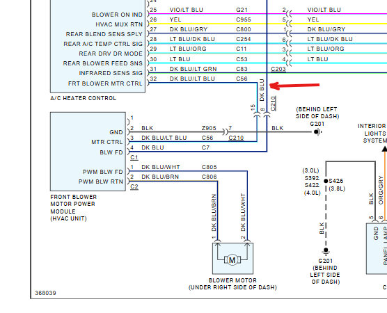

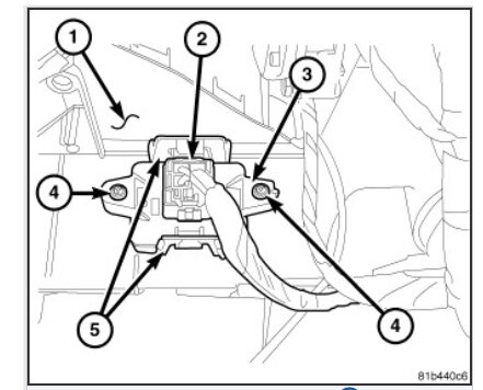

So, I would check the dark blue wire for 12 volts at the blower control module when the key and HVAC system are on. Then check the black wire for ground with the control module unplugged. If these tests are good replace the blower control module here is the location of the module and the wiring diagrams for the blower motor so you can see how the system works. Check out the images (below). Please let us know what happens.
