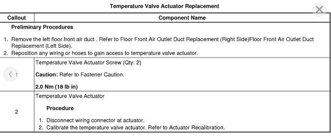

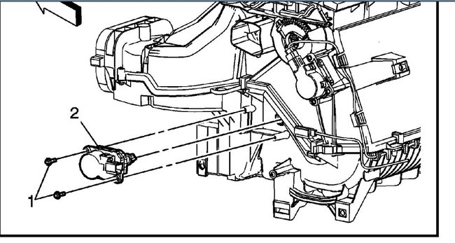

I replaced the actuator under the driver side steering wheel way up in there, but didn't fix issue. I assume I replaced wrong one. Any help on diagram on which one I need to fix?

Good afternoon,
I attached a picture of the location and the procedure for you.

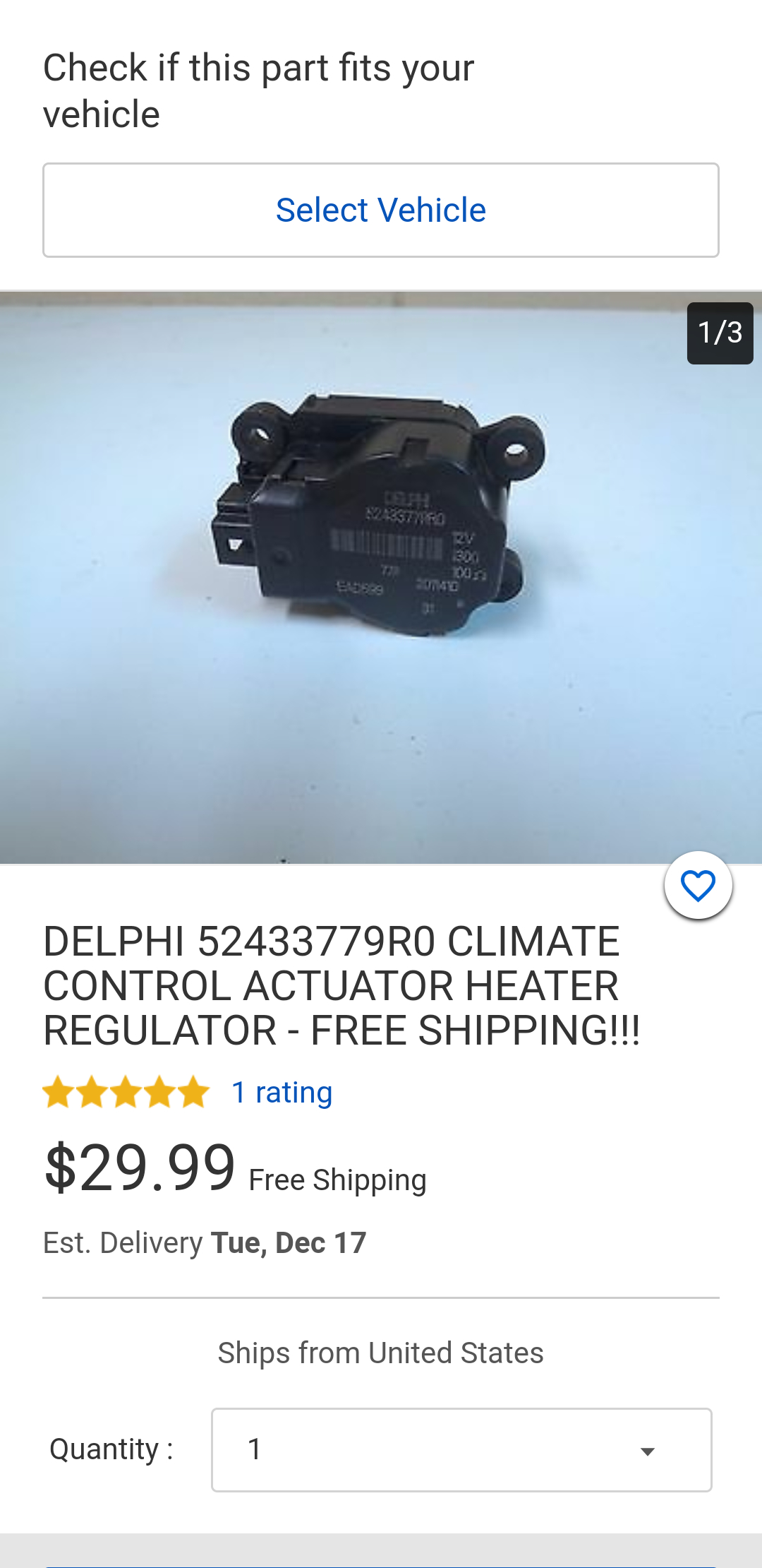

Is it the climate control actuator heater regulator? Part number 52433779R0? That is the one I changed.

The mode and the blend door are the same. You need to verify the location in the diagram I sent you as to whether you change the correct one.
Saturday, December 7th, 2019 AT 1:15 PM

The one they sent had different numbers then the one I removed. The one I removed is in the screenshot I uploaded so I wondered if I need this one instead? It is located in the diagram you sent.

As I stated, both are the same. They operate and mount the same.
Can you hear the door move when you command heat and cold from the control panel? Put your hand on the actuator and see if it moves when commanded.

Changed the one in your spec sheet but was different numbers than the one in the picture I sent.
