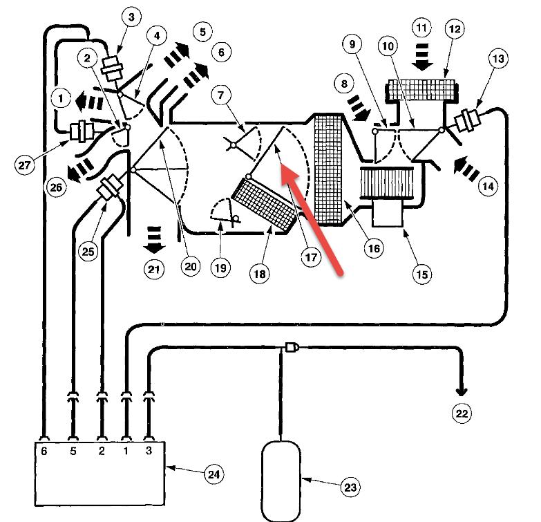

Heater core replaced and thermostat replaced. Radiator flush and nothing still no heat in 3-4 years. Now I need more help.
Saturday, January 17th, 2015 AT 5:43 PM
20 Replies
HMAC300
  • 48,601 POSTS

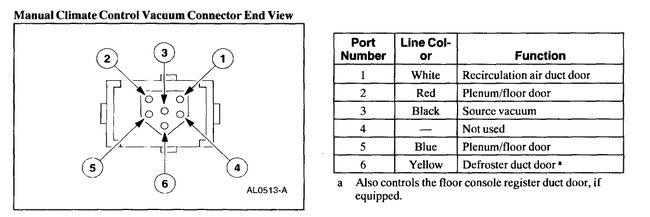

Check for a vacuum leak as it is vacuum motor operated the heat door may not be opening start at engine then to control head. Pic shows vacuum lines item with arrow is for blend door.

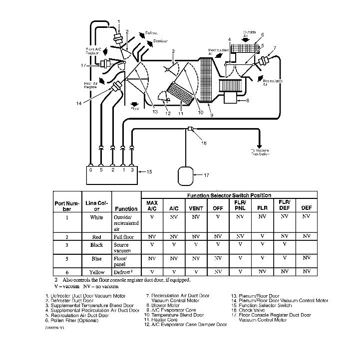

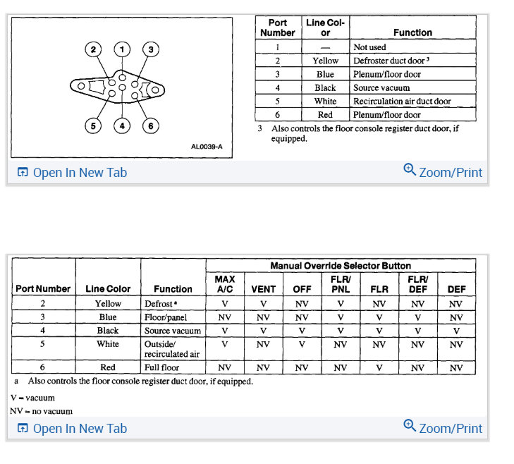

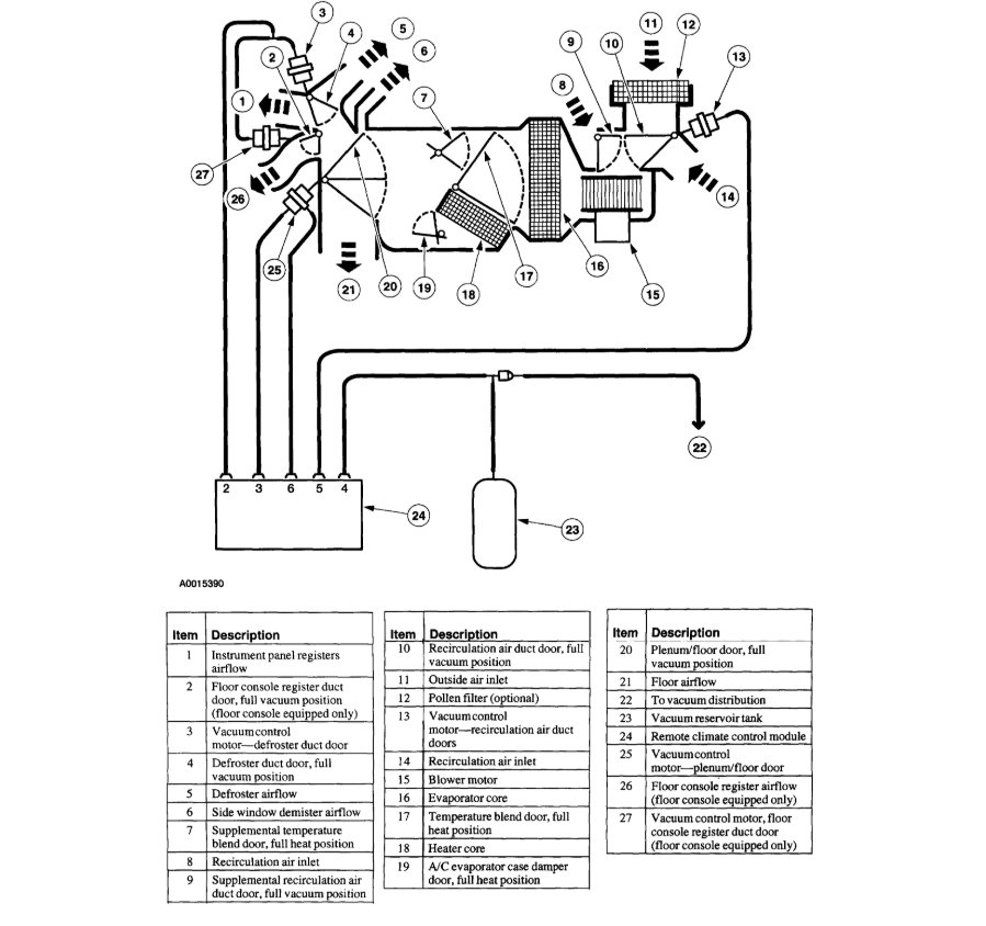

There's is a small vacuum hose that is disconnected probably under the hood headed into the fire wall on the passengers side. Look for a small check valve to plug that hose into. It will be somewhere near or on the firewall near the rear edge of the hood, and it could be about the size of a stack of three nickels with a port on each side, or it could be the style with a built-in storage chamber.
That one is about the diameter of a quarter and about 1 1/2" long, again, with a port on each end. Your car might also use a much larger type of vacuum storage canister with the port for the hose. Vacuum-operated systems are spring-loaded to go to the defrost position when vacuum is lost. Your feet might freeze but the windshield will be clear.

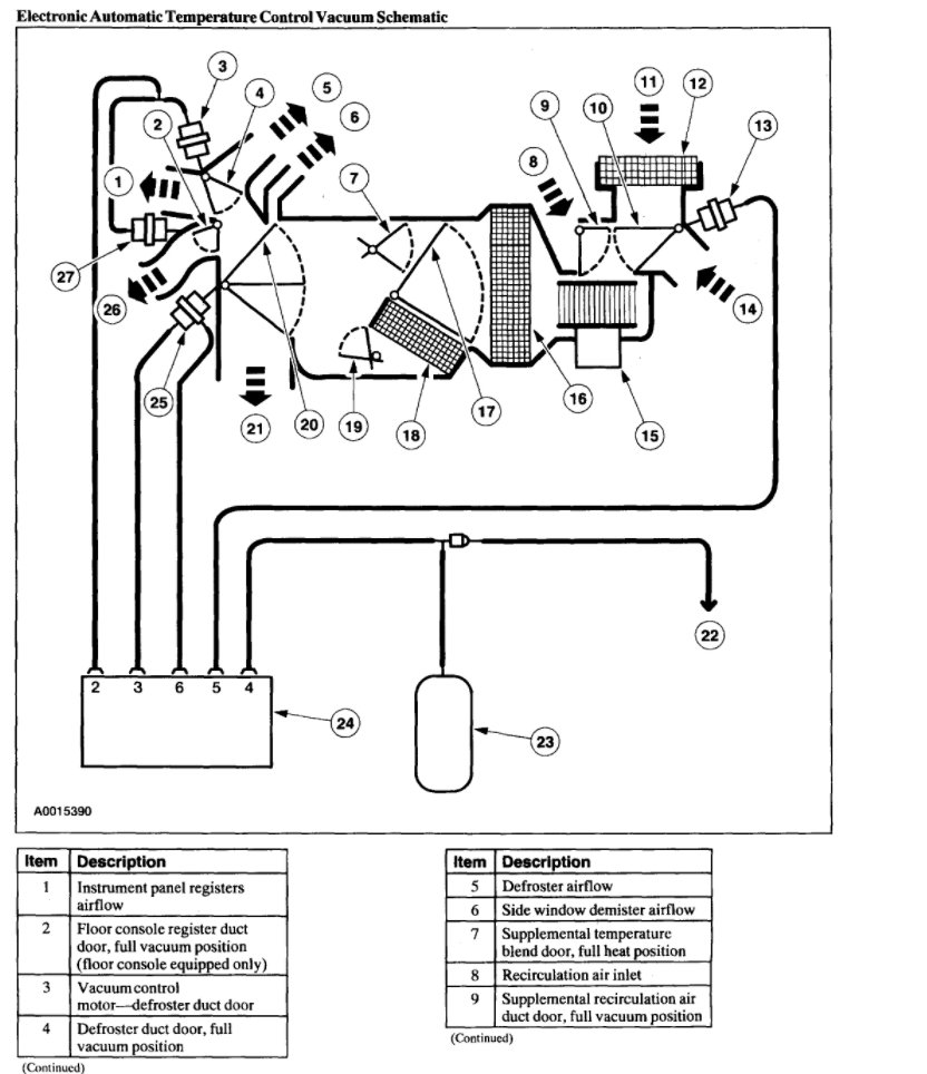

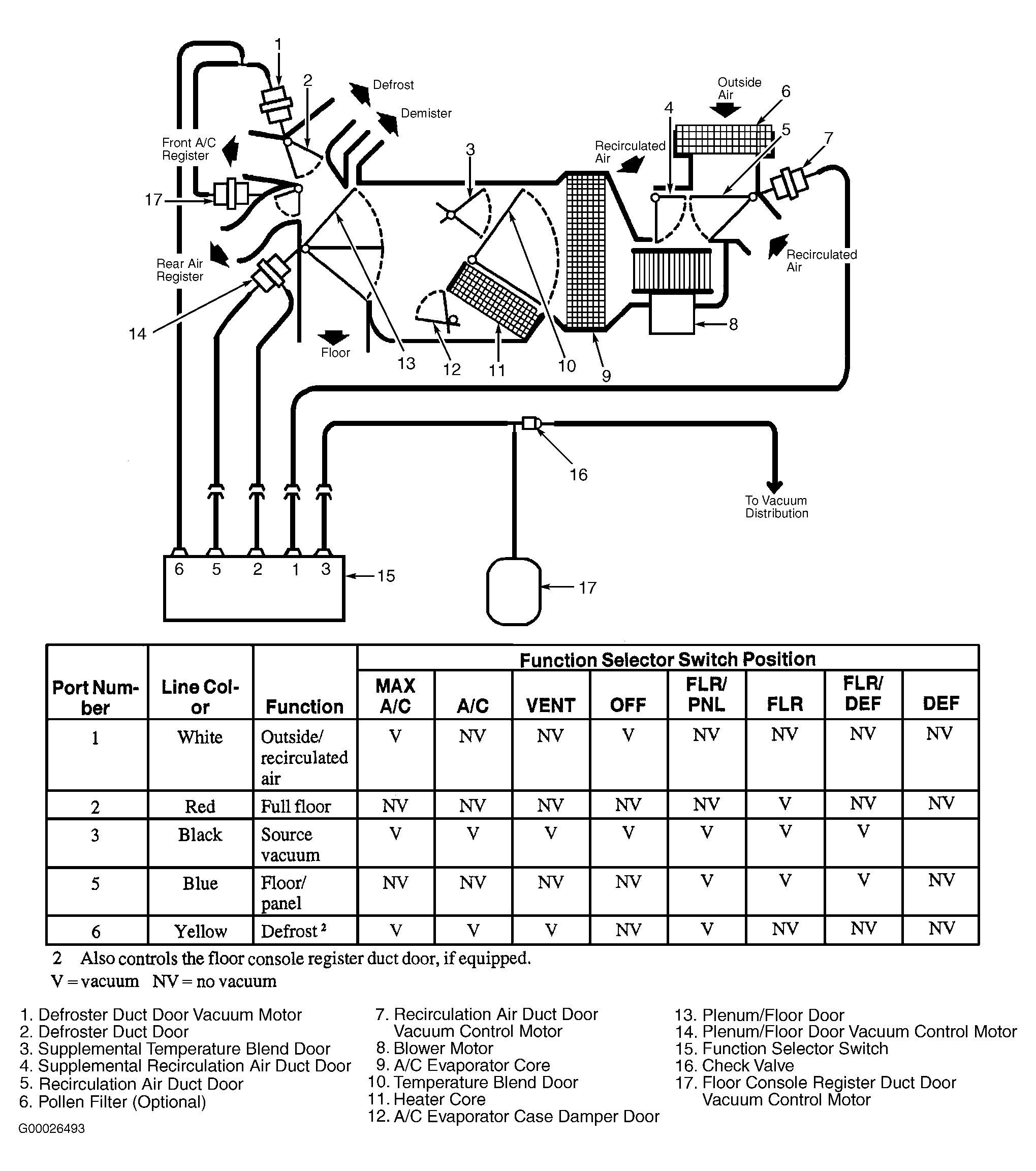

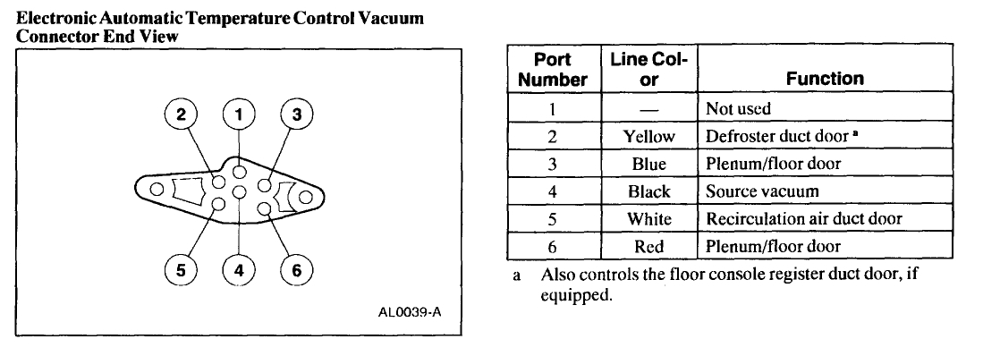

Here are some vacuum diagrams (below) to help you see what needs vacuum. If you need to run a new hose to the control head to fix the problem.
Cheers, Randy

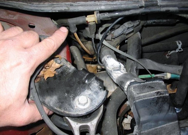

Both. It starts at the engine, goes to a storage canister or check valve, then goes through the firewall to the heater controls.
+1
Wednesday, July 28th, 2021 AT 1:01 PM (Merged)
GRABBER
Thanks. I found the line from the check valve that points straight down is only about 8-10 inches long and either broken or disconnected (hard to tell by looking at it). I was having a tough time finding where the end of this hose goes to until I looked at the diagrams you have above.
I will have to check the firewall very closely again and leave an update. Or any hints at where I may find the entry point to the inside of the vehicle?
CARADIODOC
  • 34,463 POSTS
It should be either right at the firewall center where the heater hoses go into the car or at the passengers side outer firewall.

This is a vacuum operated system here is a diagram. Check supply line in engine compartment.

Thanx alot guys, looked under the hood and traced vac lines I had a broken vac line, thanx for the info.

HMAC300
  • 48,601 POSTS
Check for a vacuum leak first start at engine then to ac heat control at the back( the buttons or knobs you turn or push.) Then see if item 10 is working in drawing it will be a vacuum motor and shold pull the door so only ac will come thru.

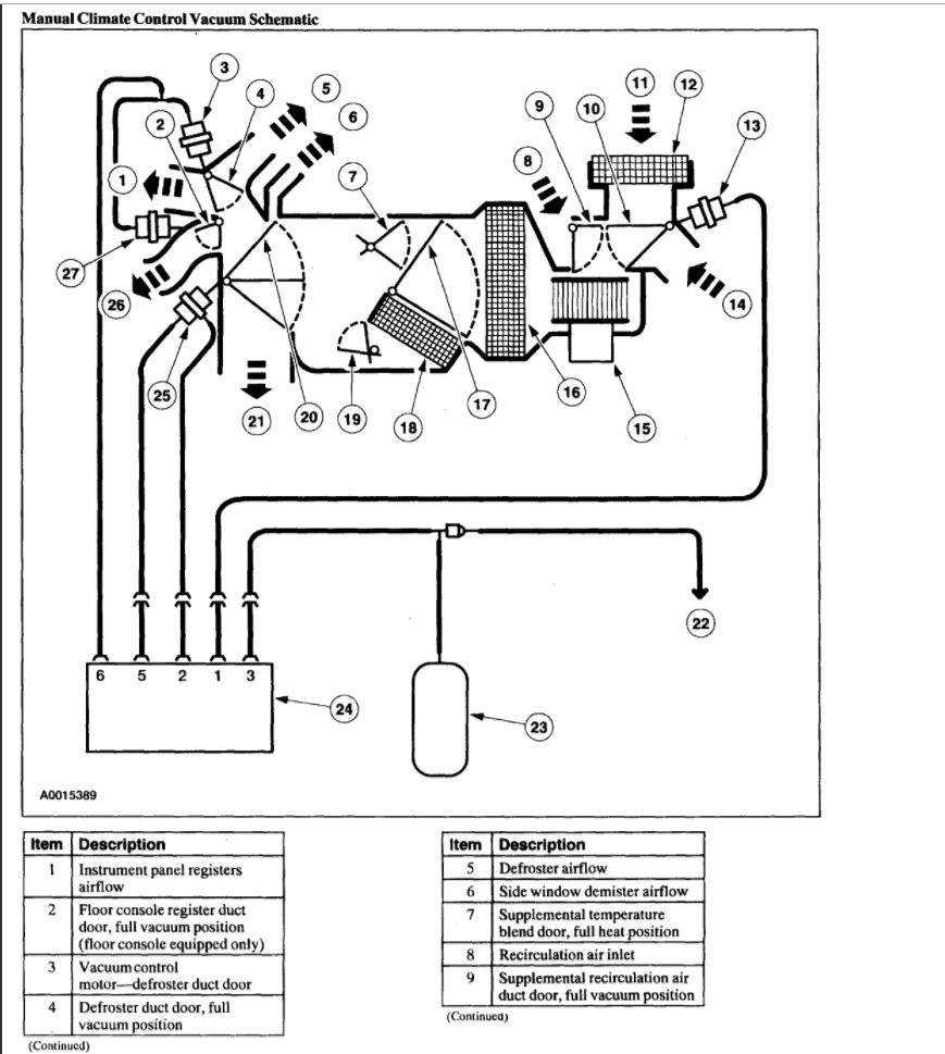

CJ MEDEVAC
  • 11,005 POSTS
The small line connects to the intake manifold look for other vacuum lines and it should be there. Here is the HVAC vacuum line diagrams below. Check out the diagrams (Below). Please let us know if you need anything else to get the problem fixed.
