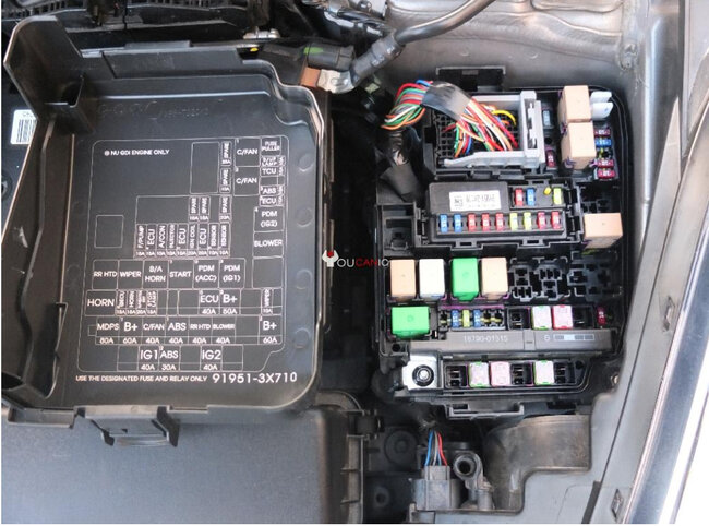

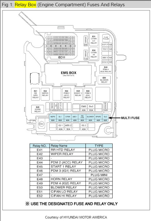

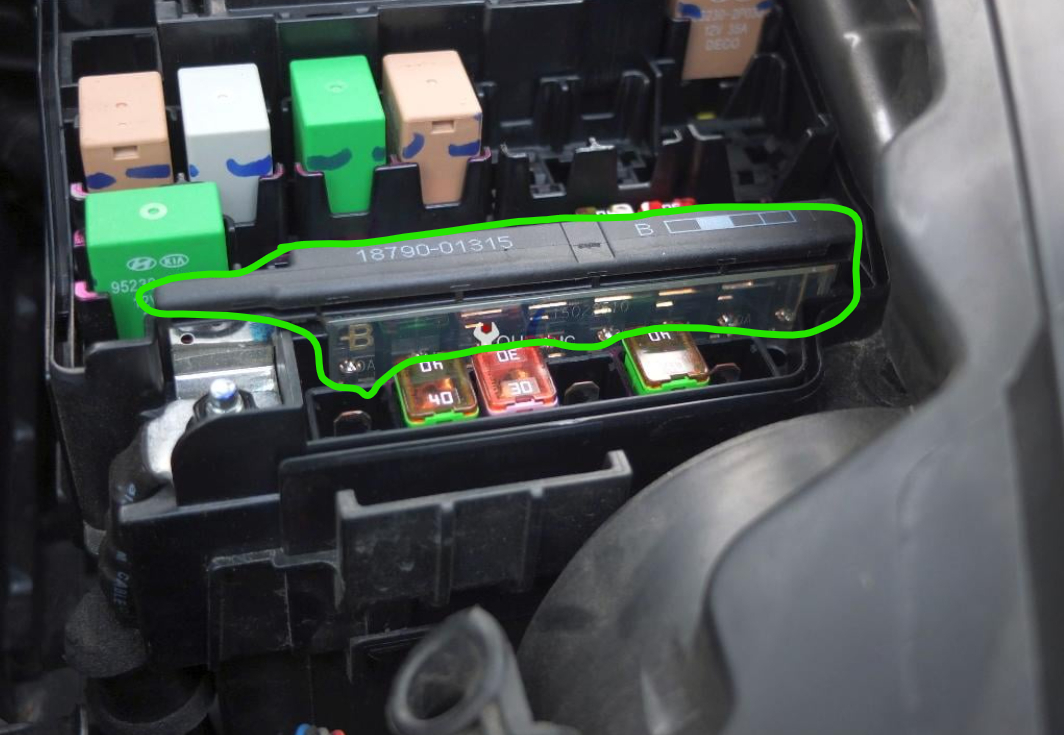

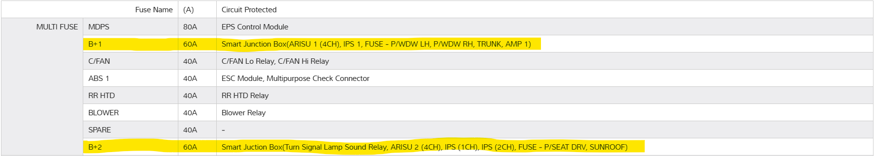

Let's check and make sure we are getting power to this Smart Junction Box.

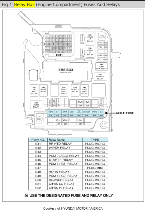

There are two 60-amp fuses in the fuse box under the hood on the driver's side front corner of the engine compartment. These provide power to this module aka Smart Junction Box.
They are located in the black strip called a multi-fuse. If you look from the side, see if anything is broken or any black is seen on the clear plastic shell.
This video is for a different type of fuse but will show you what you are looking for.
https://youtu.be/CB4aDkBUaB8
Please let me know what you find, and we can go from there.
I have also added a few more fuse diagrams for you.

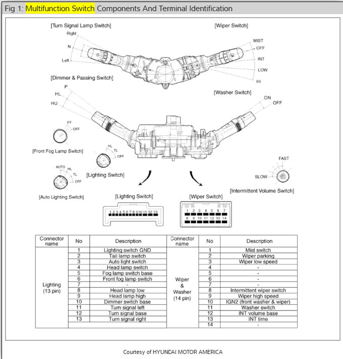

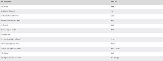

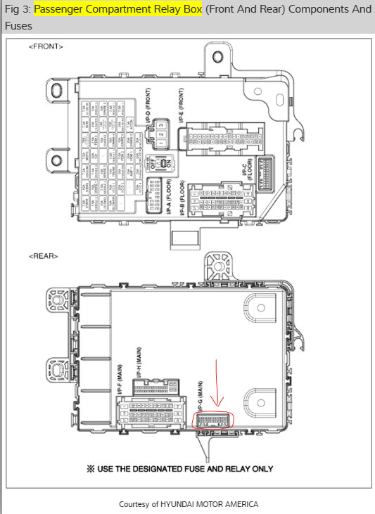

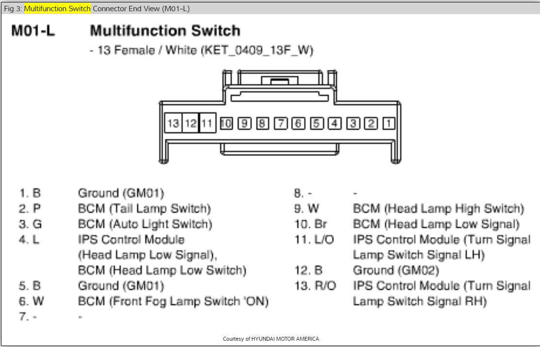

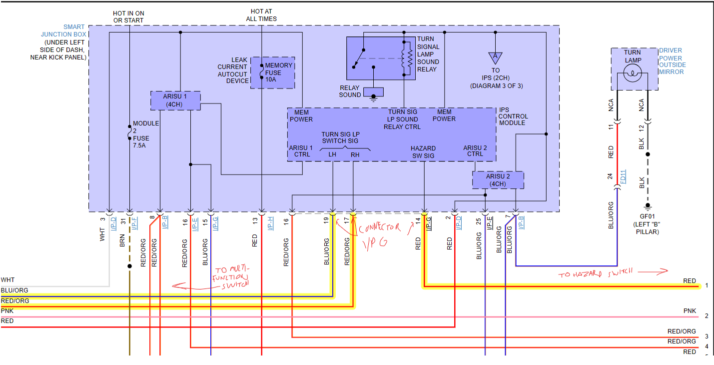

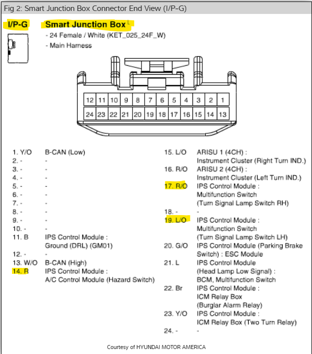

Hello JREMPEL924@YAHOO. COM,

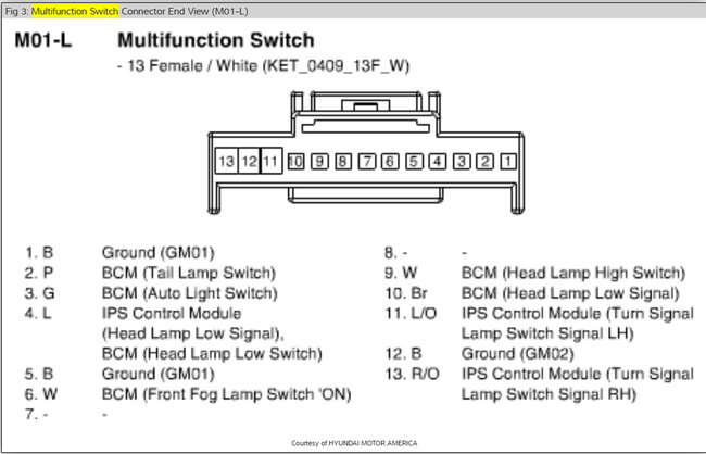

Okay. Electrical problems can have weird symptoms. Vibrations just from shutting the door can make things work again.

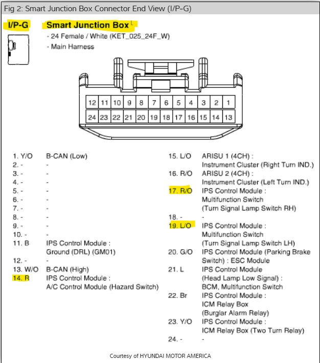

The hazard switch and the headlight/ turn signal switch, often called a Multi-Function Switch, are 2 different switches, in 2 different locations. So, it is unlikely it is the switch.
However, the Hazard Light Switch and the Multi-Function Switch both use the same connector at the Smart Junction Box. I have added a diagram of this Smart Junction Box showing this specific connector, I/P G, in red.
I have also added a wiring diagram for you of this connection.

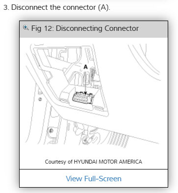

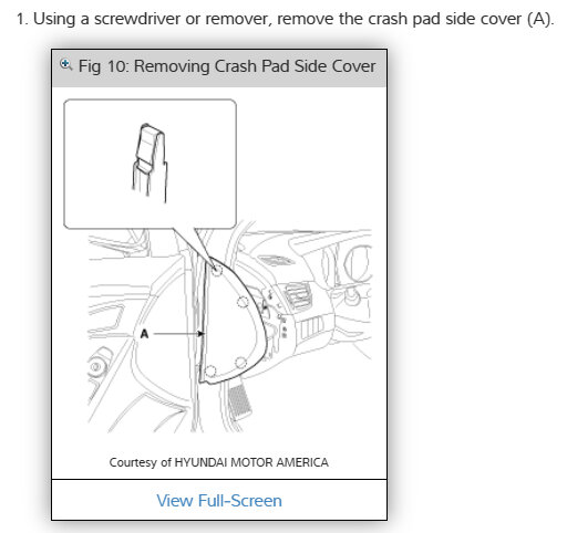

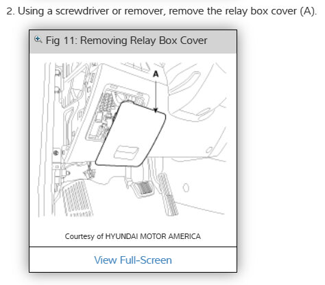

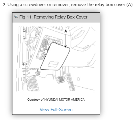

My information is telling me that this Smart Junction Box is under the left side of the dash.

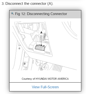

This connector may be damaged. Look at the harness and the connector and see if you see any obvious signs of damage to the wires or the connector. It could be getting rubbed or pushed against something. If not try wiggling the harness with the turn signal, headlights, or hazard lights on and see if anything is coming on or off.
This specific connector is on the back of the box. So, the box may need to be removed but I would try to avoid this for now and just take a look at the connections, specifically this connector on the back. (See image)
I have included instructions in order to remove the lower Crash Pad to gain access to this Smart Junction Box.
You may be able to wiggle the box in place with the Crash Pad removed, with key on and lights on and see if shaking or moving the box makes the lights turn on or off.
I am wondering if maybe you are hitting this area with your knees when getting in or out of the car, or if the box is loose, or a problem with the connector.
So, try removing the Crash Pad and see if moving the box or its connector, I/P G, makes any difference. Believe it or not this is a good way to find an electrical issue in a car.
I would also try opening and closing the door and see if this box is moving.
Let me know if you need any help or I can clarify anything for you.
Also, the instructions say to use a screwdriver to pry these panels. It is best to use a trim puller, which I will add a picture of it for you. However, if you only have a screwdriver, wrap it in electrical tape so your trim isn't damaged.

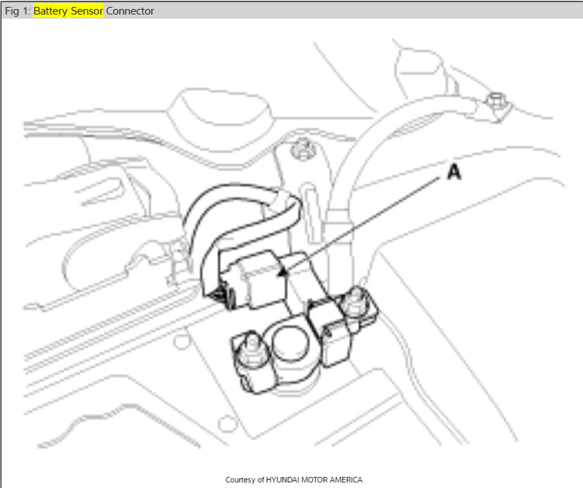

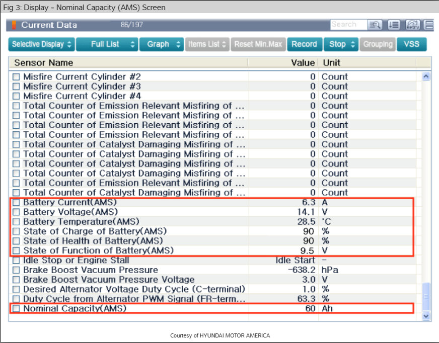

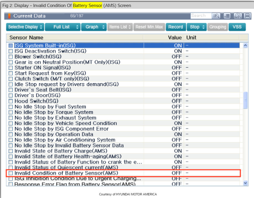

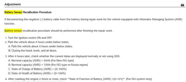

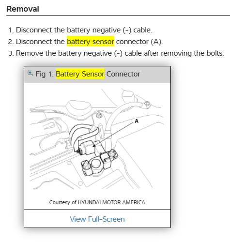

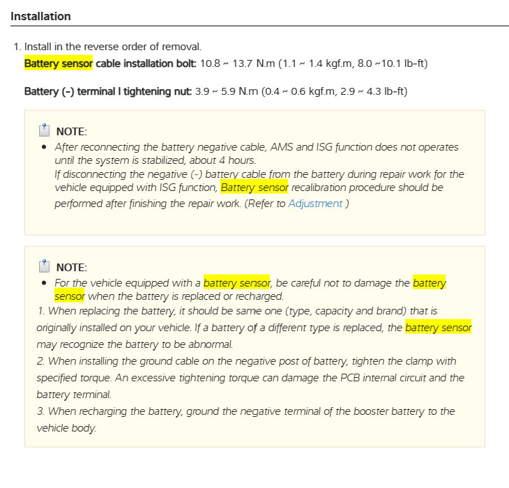

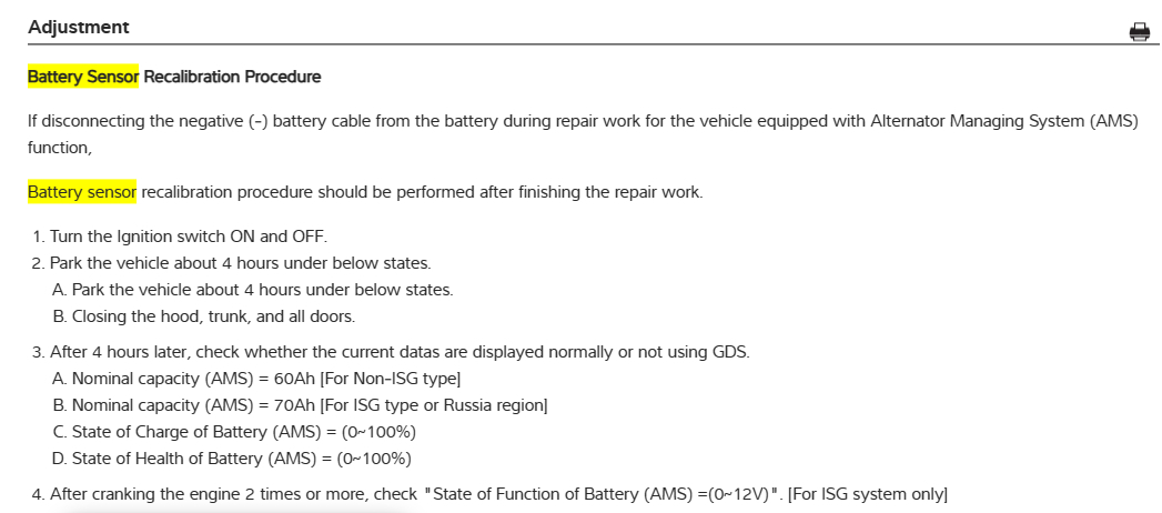

Would this have anything to do with it? It's broke. I'm not sure if i. Age shows up but it's the sensor on the negative terminal of the battery.
Wednesday, August 9th, 2023 AT 1:29 PM
BRENDON S
  • 653 POSTS

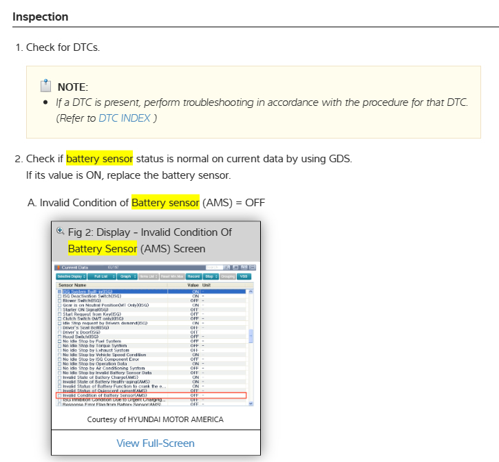

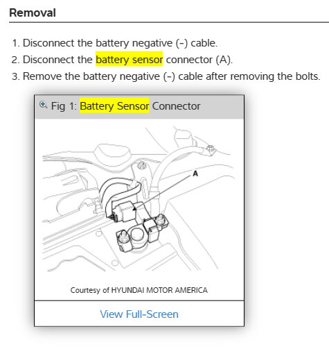

Not getting enough power to a module can cause undesired effects.
That sensor keeps tabs on battery health but also tells the ECU how much power is being used to charge the battery without over-charging it.
Since it is part of the electrical system and we are having electrical issues, I think it is a good idea to replace it.
Since your vehicle is American Made and not from Korea, 37180-A5100 is you part number for the sensor and includes the cable.
I have included installation and removal procedures.
The new sensor has to be calibrated at the dealer using their scan tool for it to function properly.
Should only take them 15 mins.
I have added the calibration procedure for you to give to them, but they should know what you are talking about.
In these procedures you will see ISG. ISG is Hyundai's Idle, Stop, Start System that shuts the vehicle off at say a stop light and restarts as soon as your foot is released from the brake pedal.

I don't think it is helping the issue, but I don't think it is the cause either. Your issue seems to be a loose connection, either at a connector or ground.
An issue at the battery would cause a lot of other problems.
But the Hazards and the Turn Signal/ Headlamp circuits are all affected. But hazards are a separate switch, with a separate ground from the Turn Signal/Headlamp Switch.
The closest thing they have in common is that module/Smart Junction Box Connector.
Of course, a faulty headlamp/turn signal switch is a possibility but it shouldn't affect hazard light operation unless it is shorting out the fuse box. But we have no blown fuses. Normally the turn signal on one side will fail or the headlights but for the whole switch to have an issue is odd.

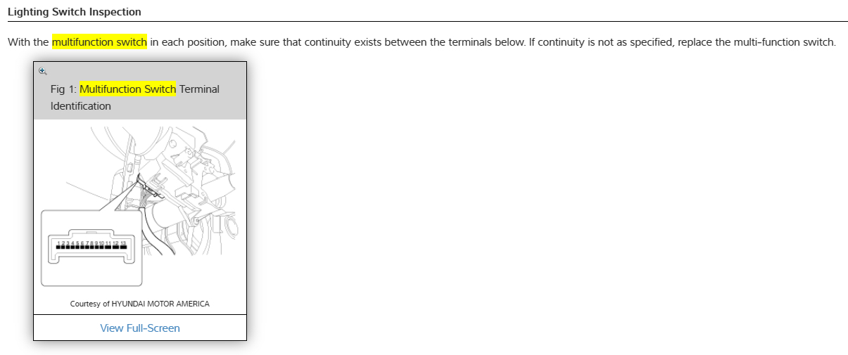

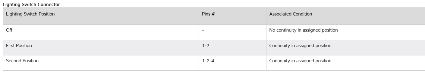

No that won't work unfortunately. We need to test continuity. So, there can't be any power on the circuit.

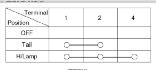

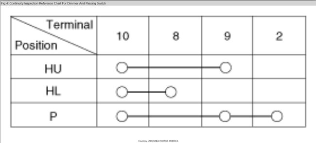

I just picked up a multimeter.
Friday, August 11th, 2023 AT 6:56 AM
BRENDON S
  • 653 POSTS

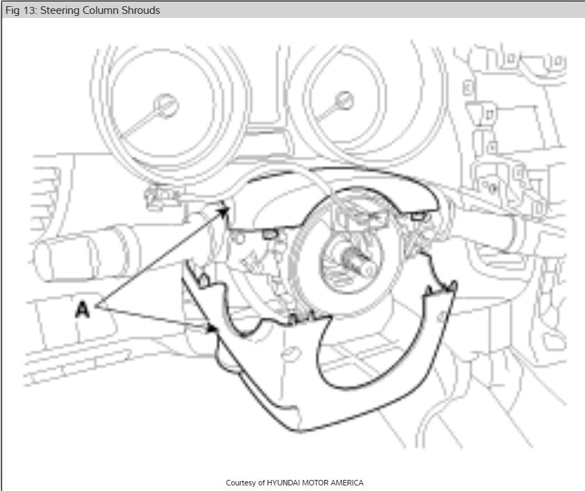

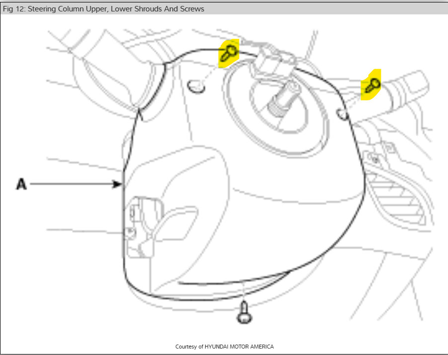

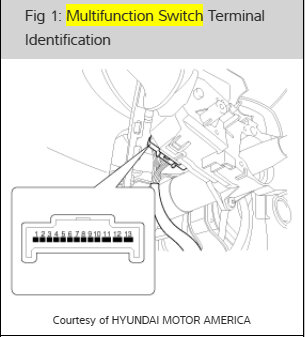

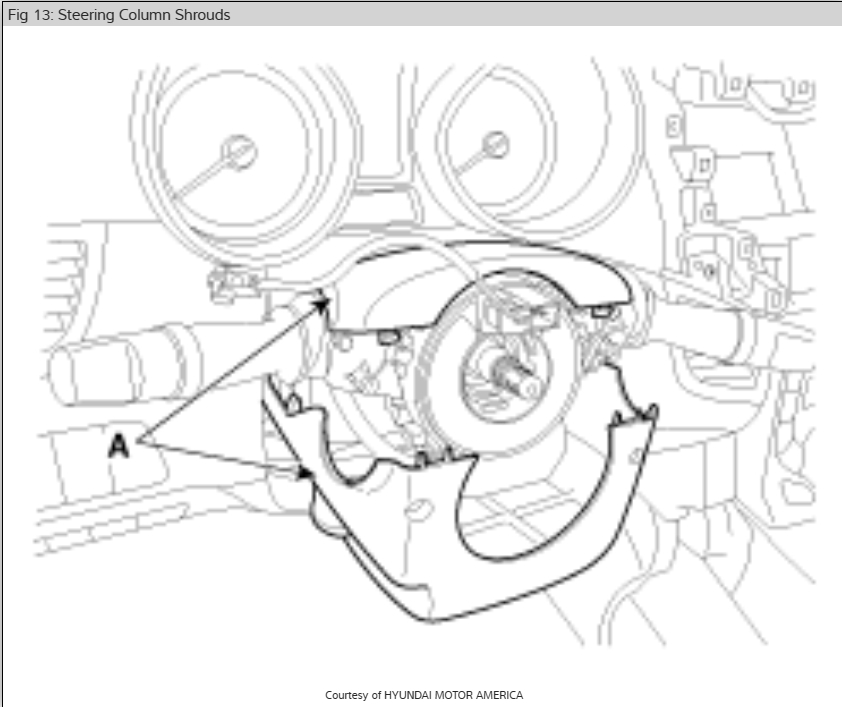

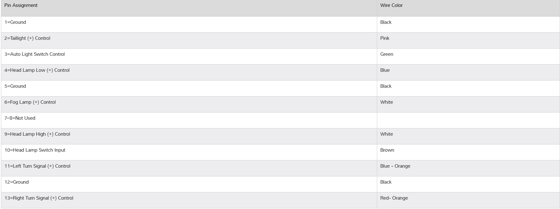

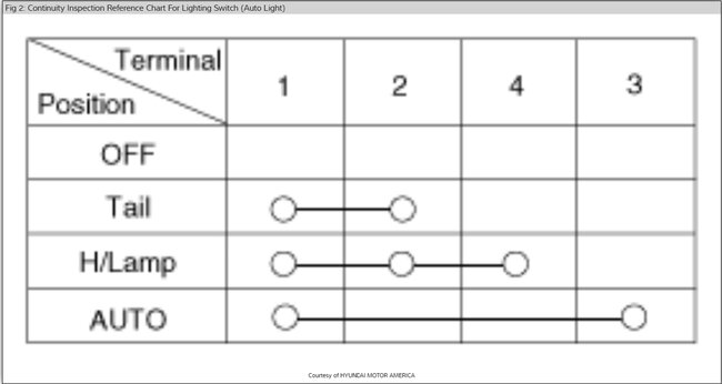

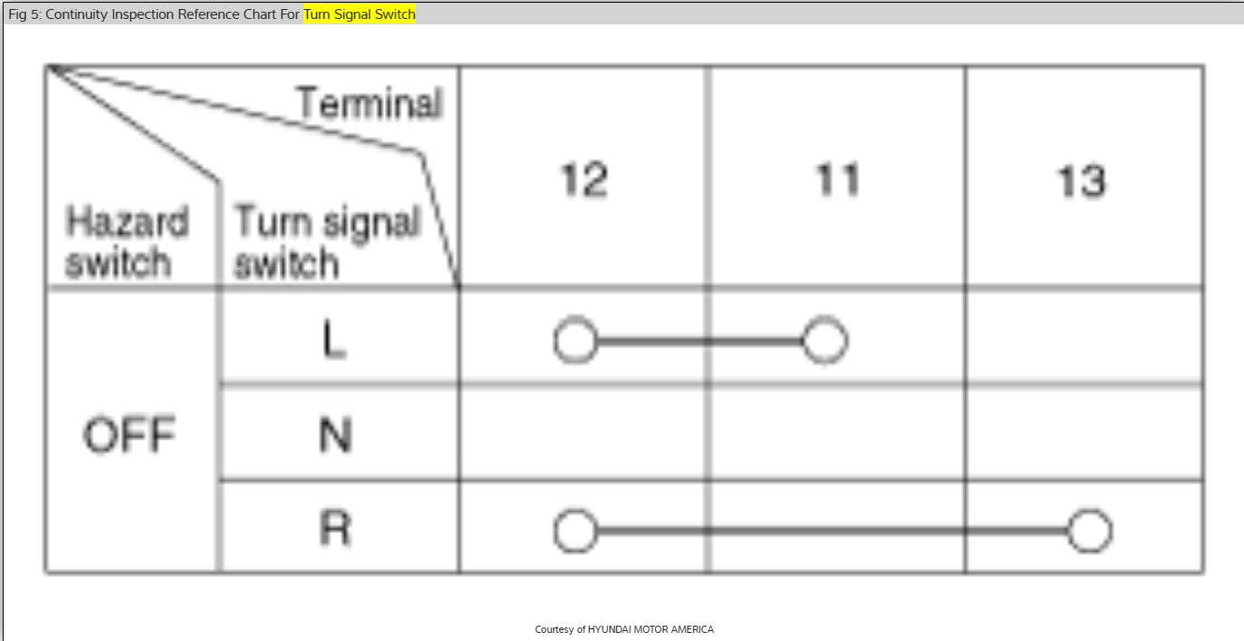

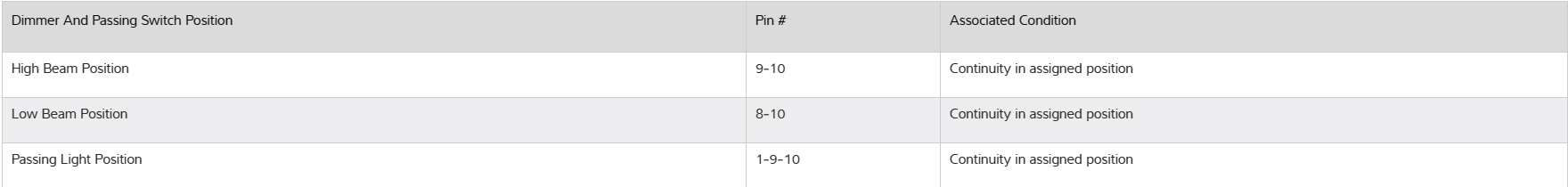

Okay. Well, that's good. Good tool to have. It looks like the connector for the switch is behind the cover around the steering column (shroud). So, this means the air bag, steering wheel and the clock spring will need to be removed to access the switch connector for testing according to my information.
I will be honest with you; this is not an easy job. Personally, I would remove the crash pad as stated earlier in the thread and see if you can get to it from behind without removing all that if you really want to test the switch. Also, we will be able to look at the Smart Junction Box connector and see if there is an issue there.
This will also give you room to work.
You may also be able to turn the steering wheel to one side then the other to remove the 2 top screws for the shroud highlighted in yellow (see fig 12)
Then remove the bottom screw and carefully separate the steering column shroud. (See fig 13)
Next remove connector (A) illustrated in fig 15. Place harness to the side for now and test at back of switch using additional provided information.
It is up to you though. If you feel comfortable removing all that then let me know and I will get all the information together for you to remove the steering wheel and other components.
But I think you might be able to skip those steps. So, I would try that first because if the switch is fine then you did all that for nothing.
***Note***
You will be working by the Air Bag so you need to be very careful as even static electricity can set it off.
To disconnect:
Remove negative battery terminal and wrap a rag around it and place it off to the side where it will not contact the battery.
Allow about 20 minutes to pass to make sure all capacitors are discharged.
Then remove any air bag fuses.
***Failing to do so can result in damage to your vehicle and/or serious injury.***

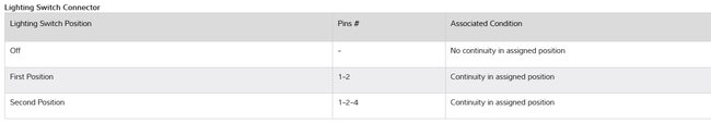

I have included test for the multi-function switch for you.
Let me know if you have any questions or if I can assist further.
