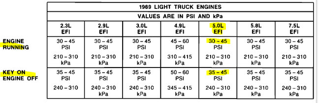

How was fuel pressure tested if there is no pressure at the Schrader valve? Did you check it at the filter?
Also, I attached a pic below showing the fuel pressure specifications. Is that what you are getting? Have you checked for a kinked hose? Do you hear the pump turn on when the key is first turned on?
See pic below.
