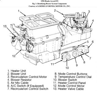

KHLOW2008
  • 41,814 POSTS
Hi profusely,
Check the air mix door and heater valve cable adjustment. If they are not correctly adjusted, the heater would not work well.
Check the heater valve solenoid and vacumn hoses as well.
https://www.2carpros.com/forum/automotive_pictures/192750_HeaterAssy96AccordFig01_1.jpg
+1
